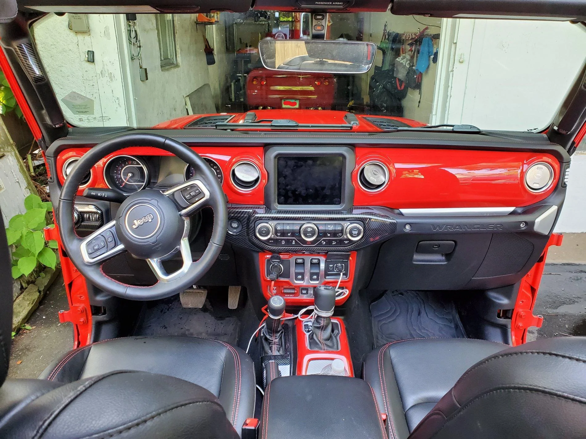

The red matches my exterior fairly well. Since the panel flips either up or down during airbag deployment, I'd think the thin stick-on panel wouldn't be projected directly at the passenger. If it were to detach, it would bounce off my soft-top or the passenger's knees. By the time it would hit the knees or top, the airbag would be in the passenger's face, protecting it from the panel.

The dash airbag splits open from the middle no?

That red looks good when you have the firecracker red paint job .what color comes on the dash when you get a red Jeep ? Black ?
The stock color is a rusty red that clashes with the exterior

And you know this because you work in safety for FCA and have seen crash tests. If not, pretty big assumption to make when literally a life is in your hands and the liability that comes with making that assumption and it doesn’t go as planned in an unfortunate accident.
For those that havent been in an accident where airbags deployed it is no joke and unless I actually had facts I would not be spewing assumptions about a safety system unless you actually know what you are talking about.

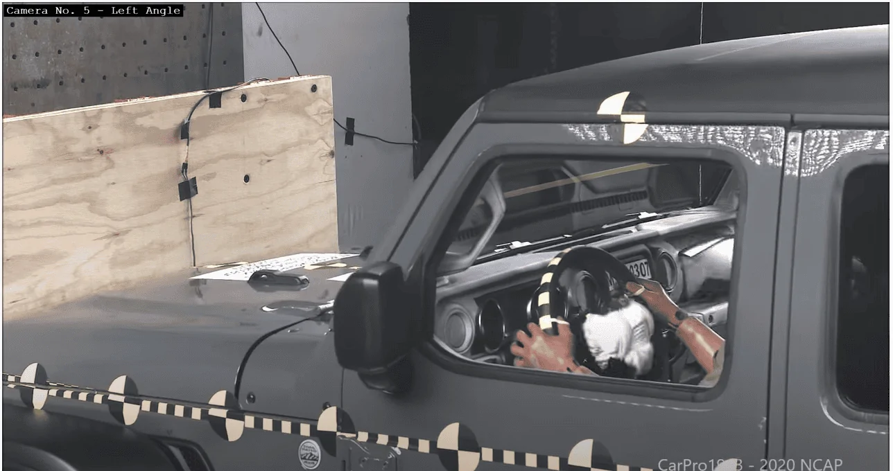

I know, old thread, but...
This is a Gladiator, but the JL airbag is the same.
The freeze frame shows the passenger airbag cover splitting at the top third, forcing the bottom 2/3 of the cover over the grab bar. So anything small stowed behind the bar, or hanging below it, won't be ejected by the airbag.

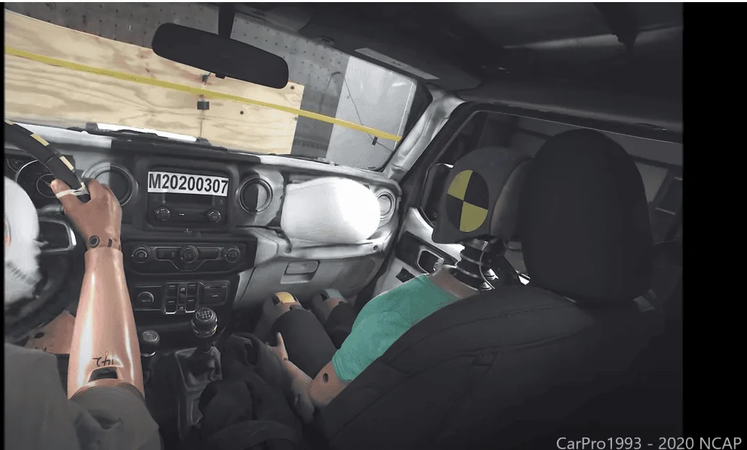

Another shot...
Looks like it’s splits open, force is too powerful for some type of hinge.

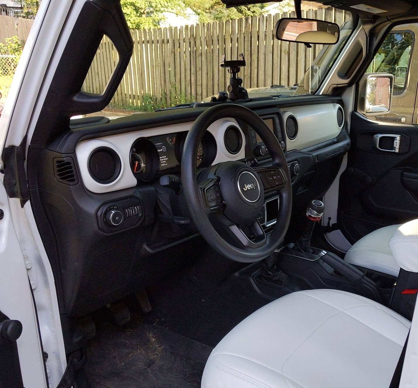

Here's my white dash painted using Bright White color matched DupliColor spray paint with a matt clear coat. I also used some satin black vinyl wrap on the silver speedo and tach trim rings.
