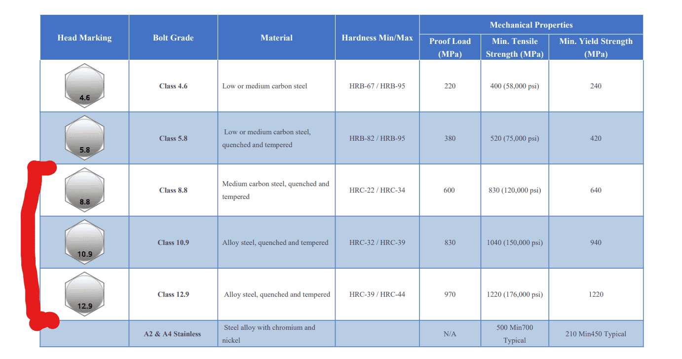

When you buy the bolt, get a grade 10.9 bolt. This is the rating on the strength of the steel it's made from. If you get a common low grade bolt (typically grade 5.8) it will be about half the strength and may fail after some time. But could be used temporarily.
If you locate a grade 10.9 bolt of the proper size, it should be torqued to 81 lbs/ft. If its a grade 5.8, torque it to about 50 lbs/ft.
Most of the bolts you'll have on your jeep will be grade 8.8, 10.9, or 12.9
This is extremely helpful. I managed to find an 8.8. What should I torque that to? I did have a torque wrench, though it’s been a few years since it’s gotten use!

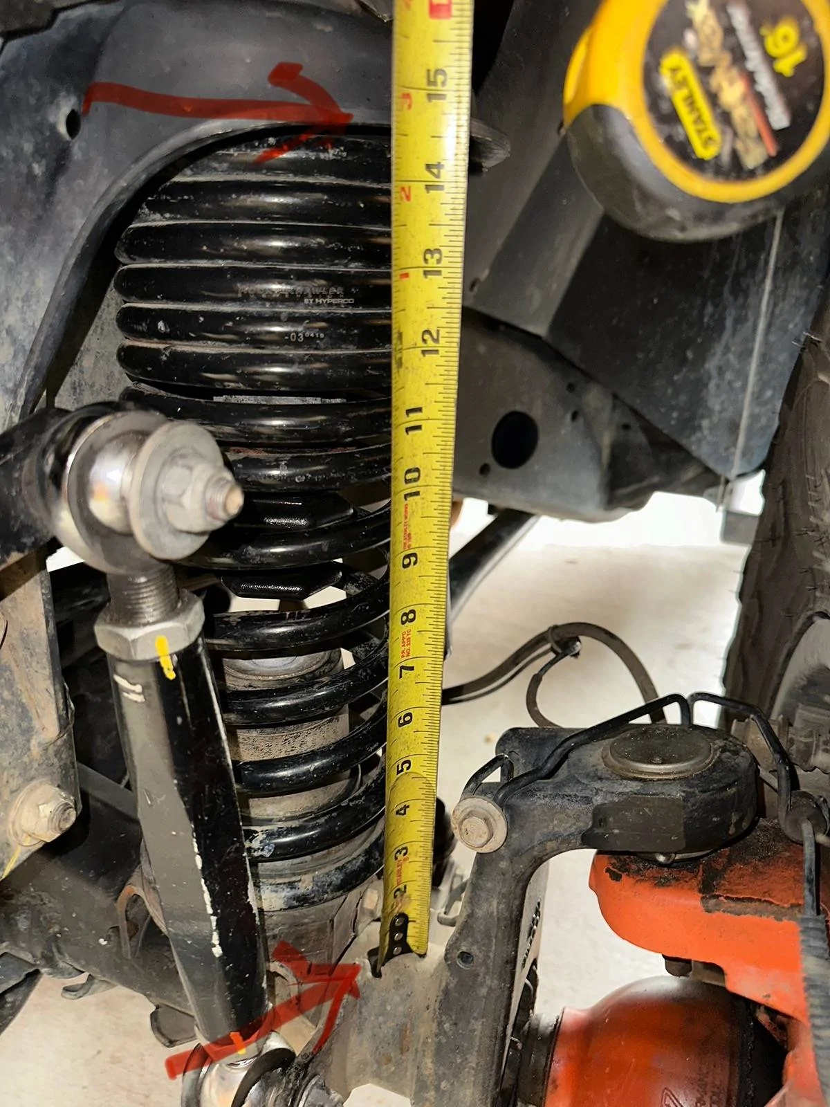

Measure from top of axle tube to bottom lip of coil housing like in pic …..stock Rubi measures about 11.25 ish inches there….. it looks like you have a 3-3.5” Rough Country lift on there now….
Interesting - I thought for sure this thing was lifted, but I’m measuring in the 11.25ish range. Thanks for the info.

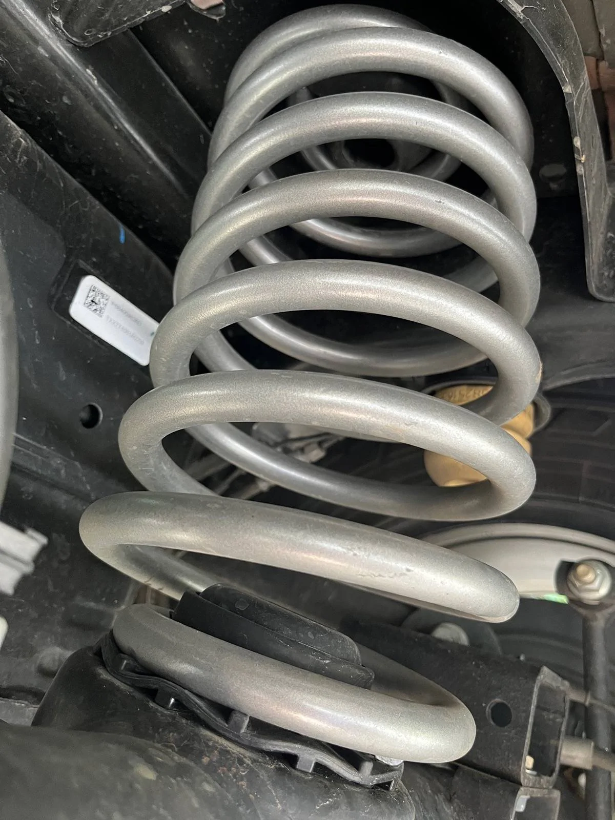

I dunno about "lifted", but this spring isn't the common gloss black that the factory uses, and it has no part number tag.
