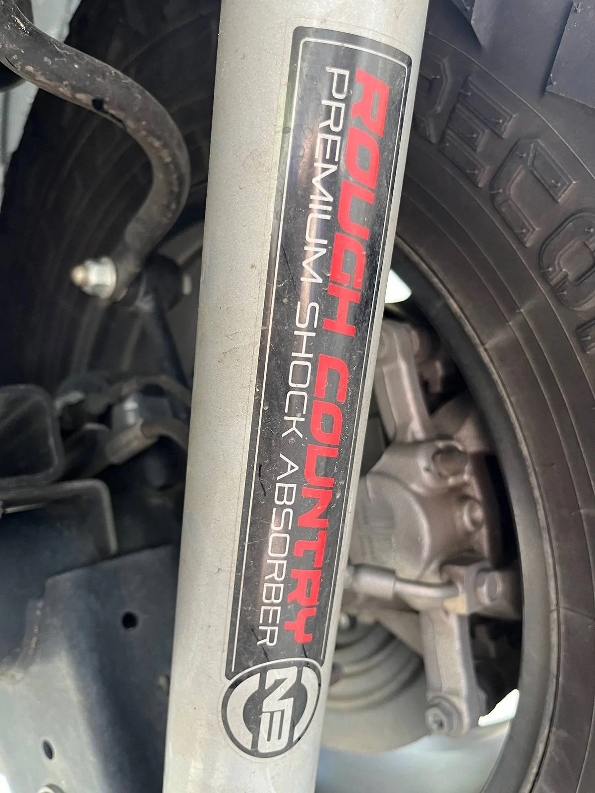

I bought my wife a Rubicon a couple months ago - used 2020. It has RC N3 shocks on it; I was planning to replace these (but I don’t know with what just yet, maybe Fox 2.0s?)

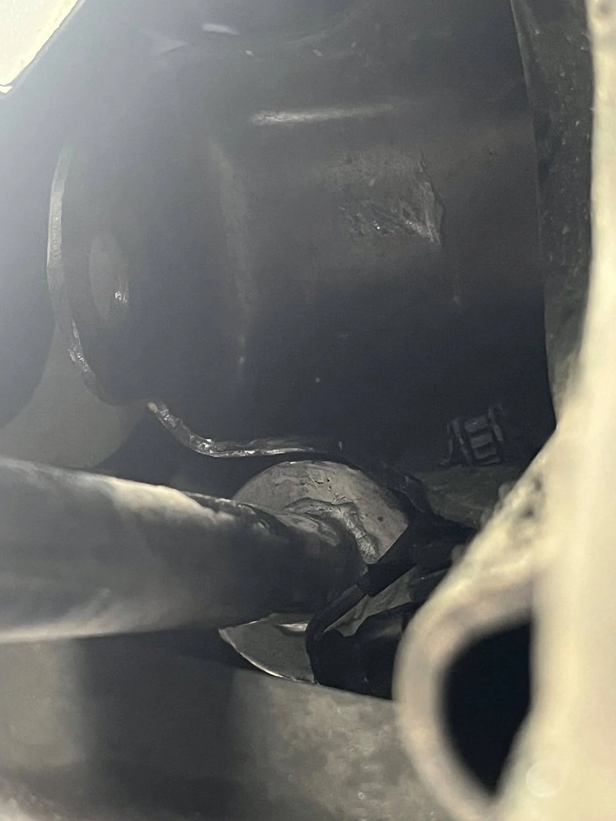

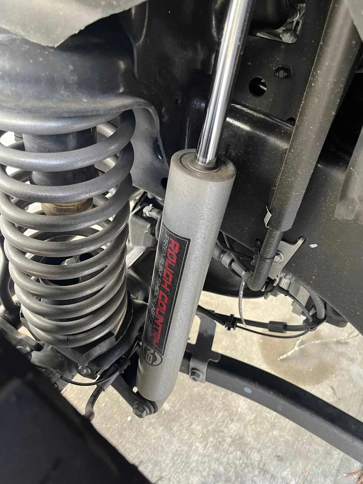

the Jeep started making a sound yesterday and it looks to me like the shock has come off the top bracket (see picture). Can someone tell me if that is correct?

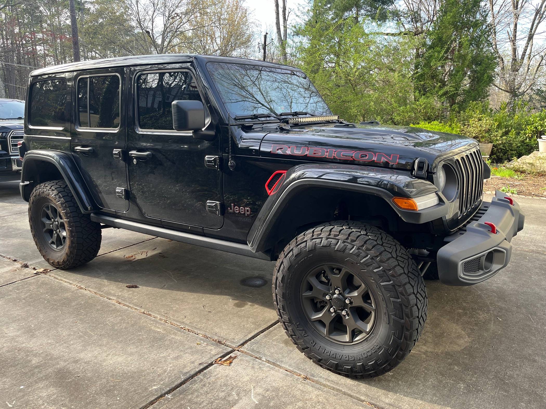

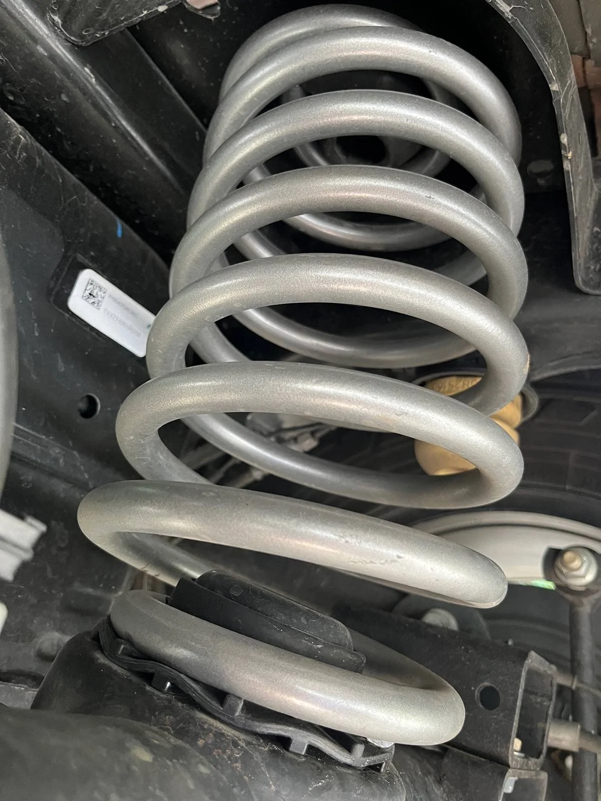

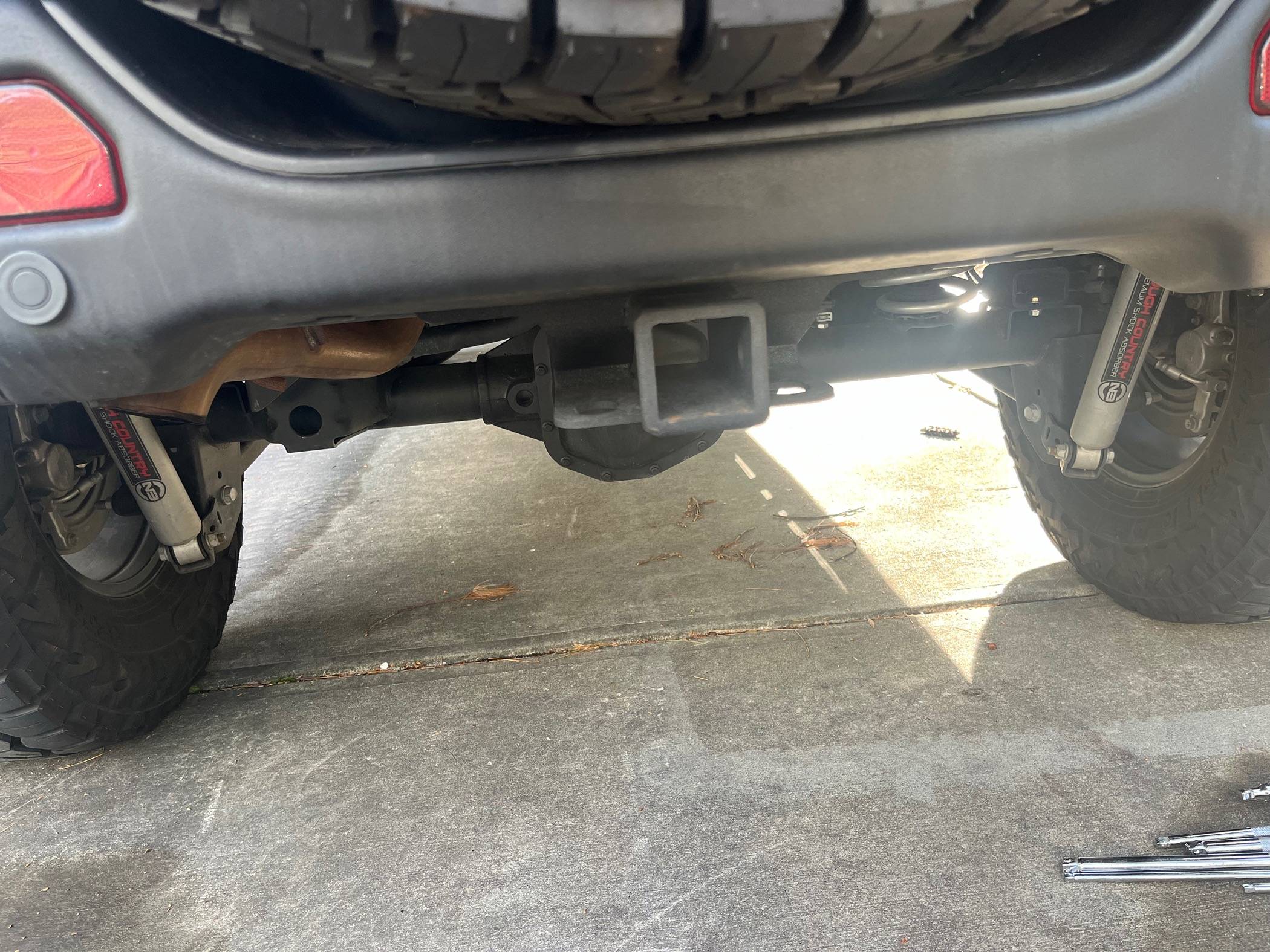

I’ve also attached a few other pictures. How can I tell if the Jeep is lifted? And are those springs stock or should I change those as well?
I have an F150 and put an Icon Stage 2 lift kit and want to do something comparable here, but don’t really want to lift the jeep any more than it already is.

Measure from top of axle tube to bottom lip of coil housing like in pic …..stock Rubi measures about 11.25 ish inches there….. it looks like you have a 3-3.5” Rough Country lift on there now….

Ok thanks, very helpful. I will measure in the morning. I’m leaning towards AEV 2.5” Dualsport rt with Teraflex track bars. Will call Fortec in GA Monday morning for advice.

I need a better pic of the shock, more down where it’s off, I can’t tell if the bolt is missing or it’s actually broken…..

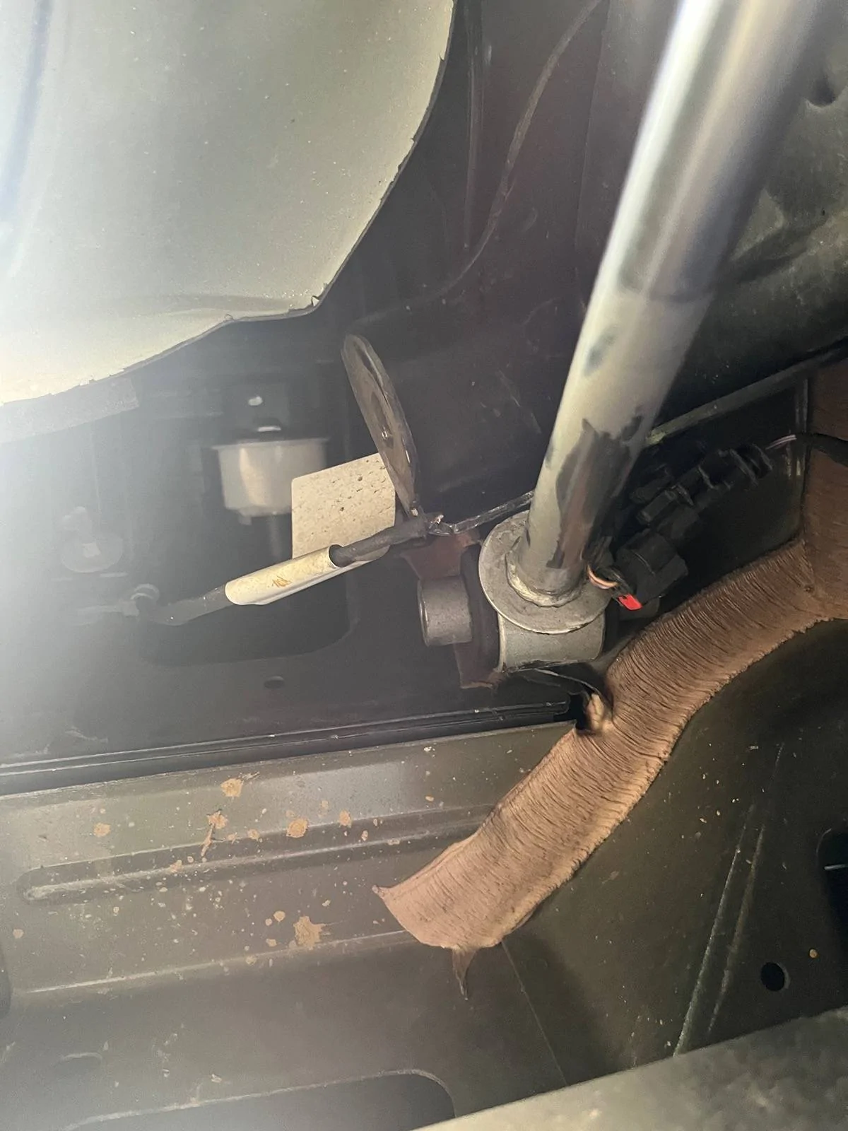

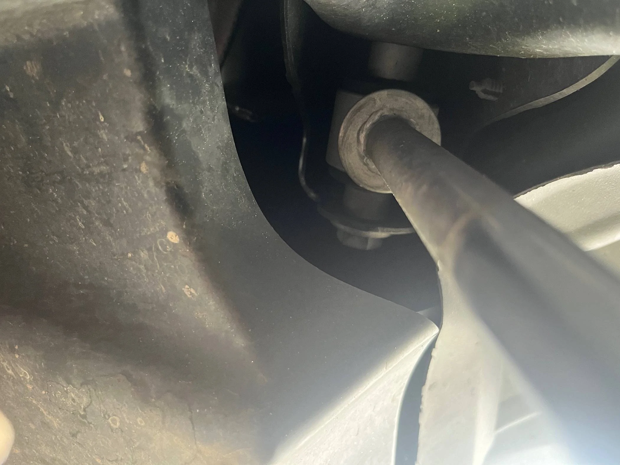

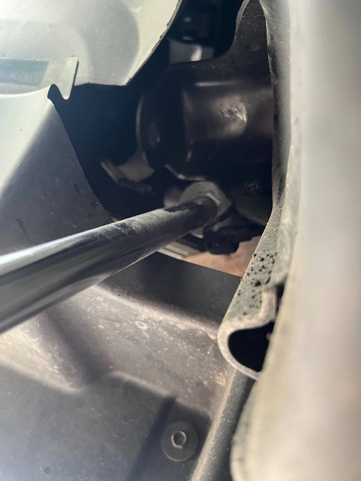

It’s up at the top. Here is a picture of the rear passenger top vs the rear driver top. In the first pic, it seems like it should be bolted in that bracket it is going around.

Is it bolted to something, or not bolted to anything?

I will go check again, but I was under the impression that it should be bolted to the bracket that is right there. I don’t know how to get it back on there, but if I had to guess, I’d think that bolt either loosened or broke.

Ok clearer picture with the protection piece removed. It’s clearly off, no bolt there

yup lost the bolt and outside the bracket.

I did manage to pull it back onto the bracket… can anyone tell me what bolt specification is supposed to be there? I’ll go buy one and put that in so I can drive it with no worries tomorrow.
