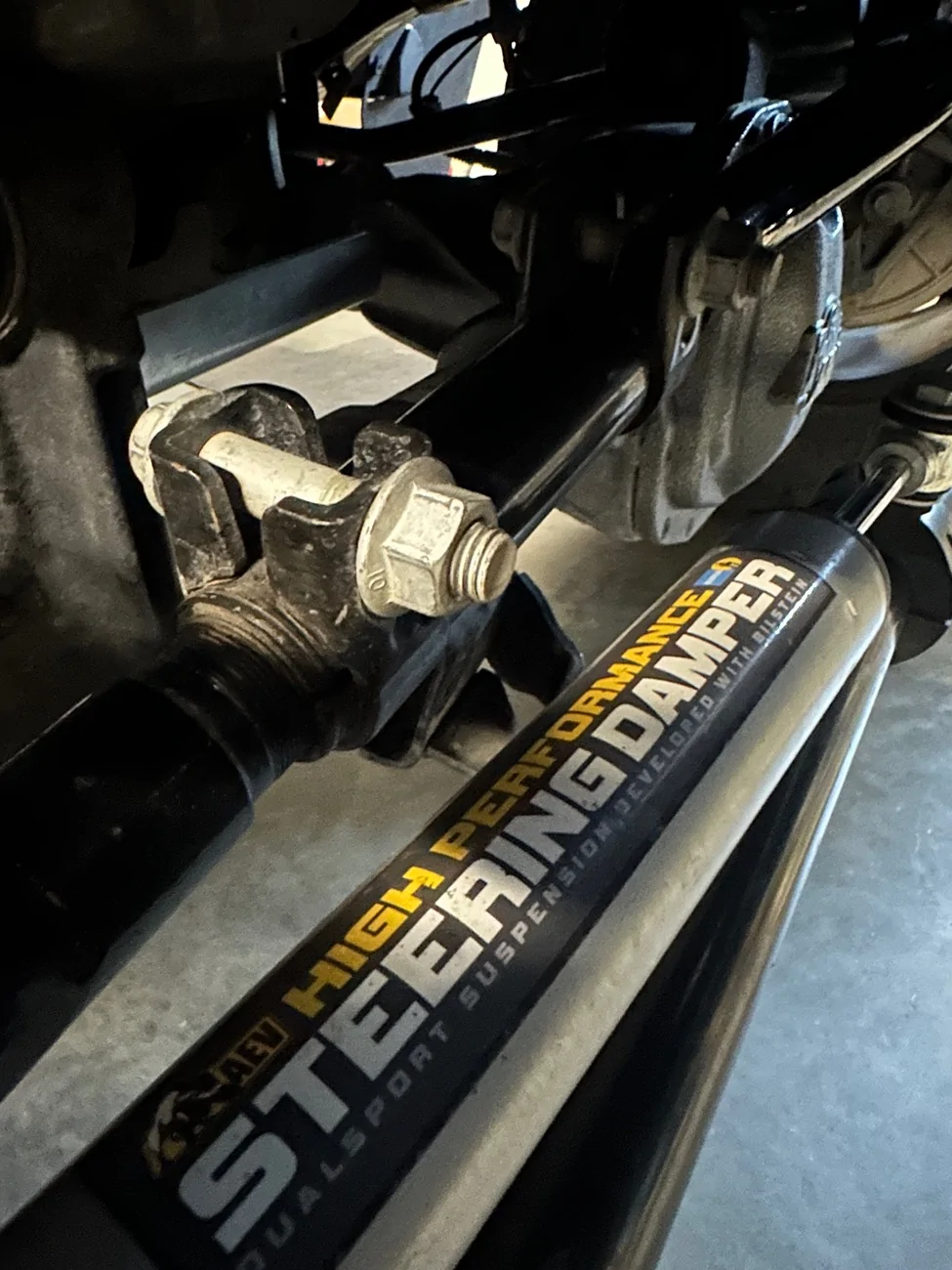

When my JL was new, I installed a "pass-through" steering stabilizer and it solved my pull. As a trial you may want to try removing the stock stabilizer entirely and take a test drive. If the pull is gone, change out the stock stabilizer.

AEV Steering Stabilizer. AEV suspension. Upgraded track bar. Cant recall the brand. 37s. Bfg ATs. Stock aluminum steering box.
Had multiple alignments done. Finally gave up and just live with it.
I have the same same AEV Bilstein stabilizer. Constant pull is there. I’ve been chasing it for a while

I have the same same staring stabilizer. Constant pull is there. I’ve been chasing it for a while
If you have a steering damper that is gas pressurized to extend or retract, that would push/pull the steering to one side.

The guy who said the steering stabilizer could be right as well. I know when mine was pulling hard to the right, it was because the steering stabilizer was dented in and all of the fluid inside had leaked out. I didn't realize it at the time, but if you have any large dents in your steering stabilizer, that might be the culprit as well!

Thanks for the advice everyone, here is some more information everyone has been asking for. I did install front and rear shocks for a 0-4” lift, a bilstein steering stabilizer, and an adjustable front and rear track bar. I installed all of these to get rid of death wobble which it did. I drove around with the steering stabilizer off and the pull did not get fixed. I rotated and balanced all the tires which did not fix the pull. I made sure my axle was centered and both track bars were aligned, I even took it to a mechanic who confirmed this. The dealership could not figure it out and thought maybe the TSB for steering gear box would fix it (maybe). 3 separate mechanics confirmed no frame damage or worn parts.

After striaghtening my steering wheel and pulling the power steering fuse to reset it the pulling is better. There is still a pull to the right but not as severe, the Jeep will track straight in the opposite side of the road with the crown. I am going to order these parts and let y’all know if it helps, thanks!
