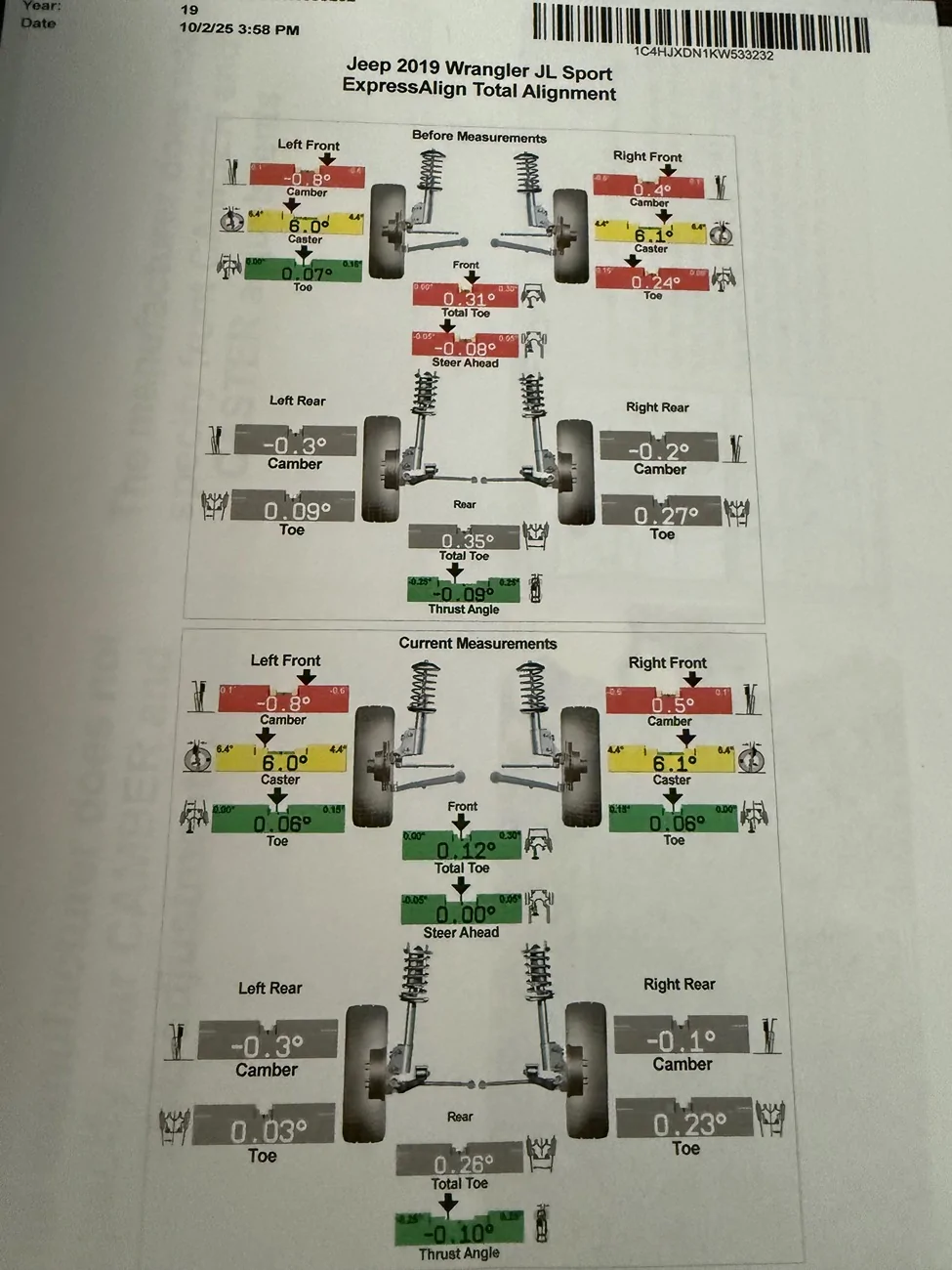

Jeep Wrangler JL Severe Pull to Right IMG_6992
Put on 1/4” longer front LCA, here are the new adjustments. Still pulling to the right but not as bad. I am thinking I need to chase this camber situation.
Roky
Roky
Oct 4, 2018
10,715
29,487
On your first post the camber is bad the opposite direction, than it is on this read out… I would take a hard look at your balljoints……
