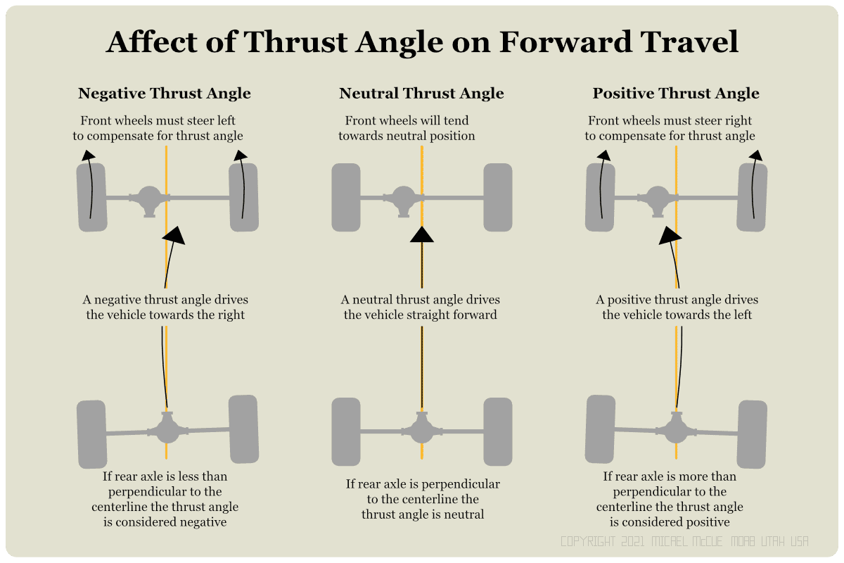

A large negative thrust angle indicates the rear axle is pointing to the left. The negative thrust angle will tend to push the car to the right. The Wrangler JL specs list 0.25 degrees as a maximum, but a value lower than 0.10, for example 0.03 degrees should be the goal.
The rear control arms should be adjusted to correct for minimum thrust angle.
