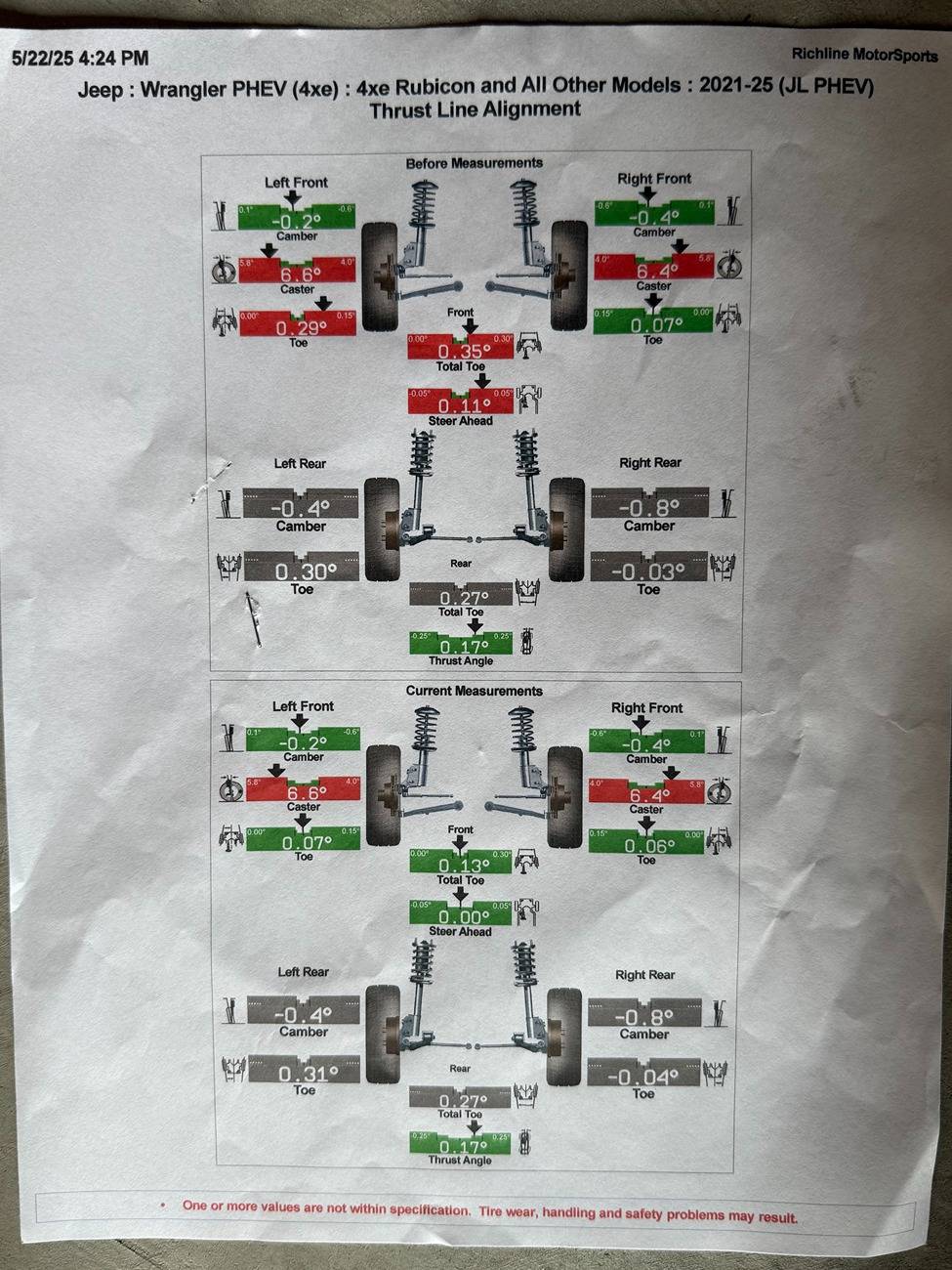

I just had a local shop install adjustable front lower control arms on my 2024 JL Rubicon after I installed the AEV 2" lift. I would have done it myself but I couldn't get the darn bolts loose on the ground. It was tracking perfect with the stock control arms and driving fine before these were installed. I am running 37" tires. I purchased the adjustable control arms on a recommendation I found in these forms as a good practice with the lift. I am wondering if they weren't set to the proper length as the jeep is now pulling to the right on a flat straight road. The shop says everything is within specs but they are not a jeep specialty shop so depending on what you all think I may take it to one of those in town that focuses on jeeps. Any recommendations?

Usually guys will run slightly higher caster on the passenger side to help with the natural crown in most roads…Your caster is higher on the driver side. Measure center to center of the connecting bolts on each arm to make sure they’re adjusted the same length…..
