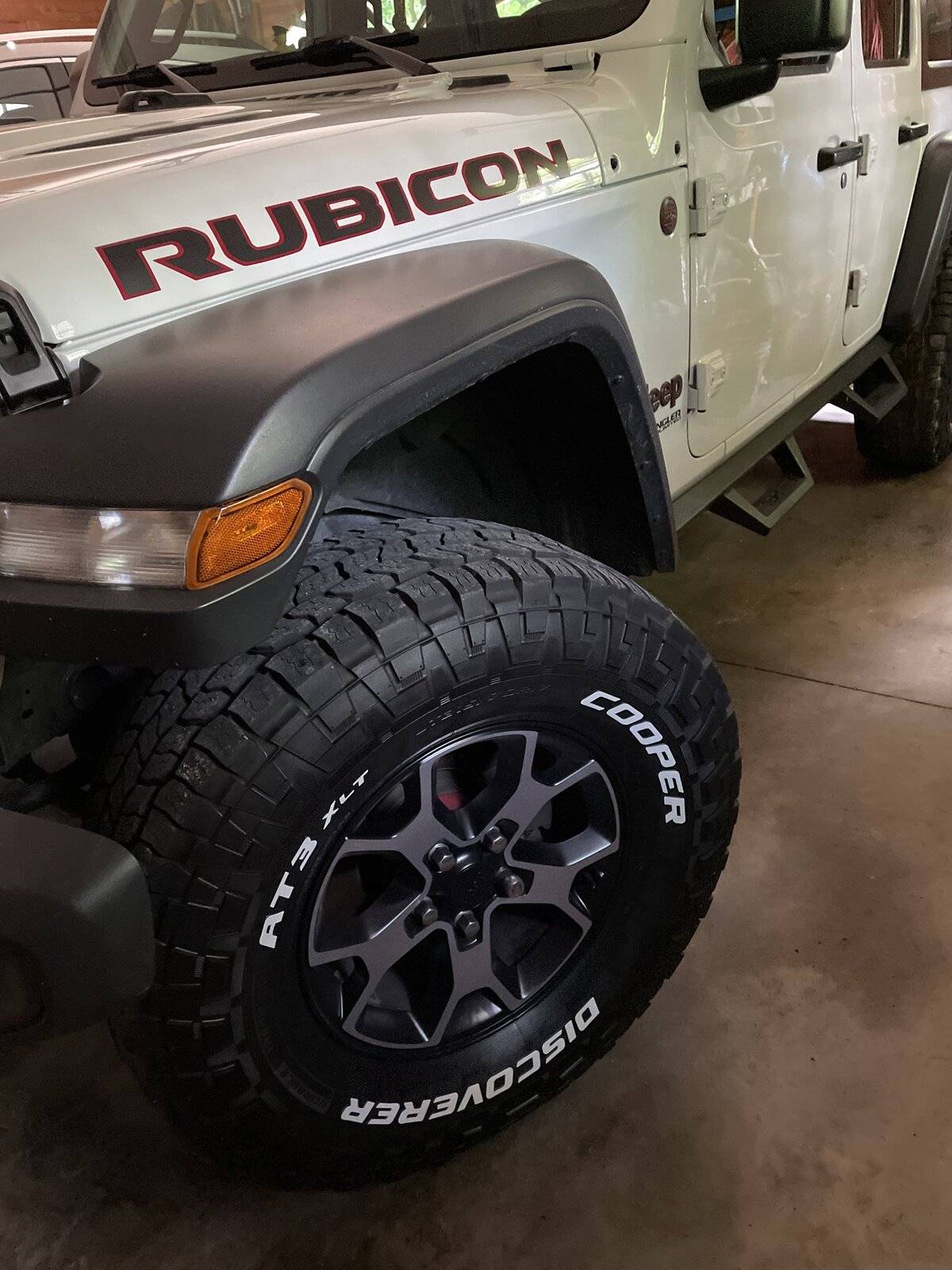

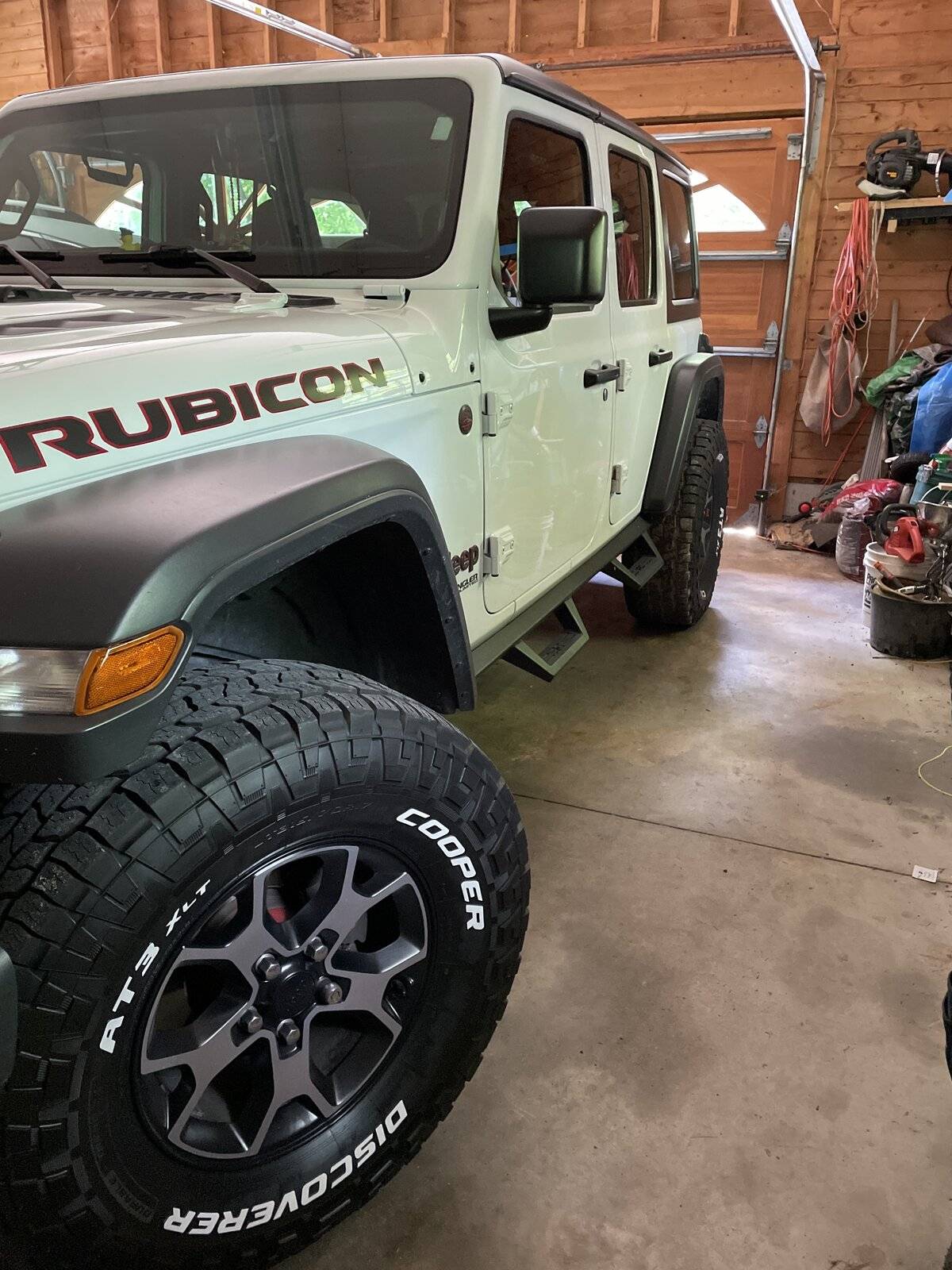

I put 35s on my Rubicon and I did not put any kind of lift on it I only put a leveling kit on the front which changed the rake an inch and a half so to make it more level. I also went with the Cooper Discover AT3 xlt because I liked the aggressive tread but I also was doing a lot of highway driving and they come with a 65,000 mile tread life warranty

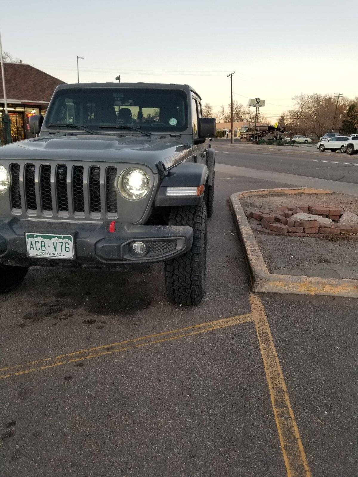

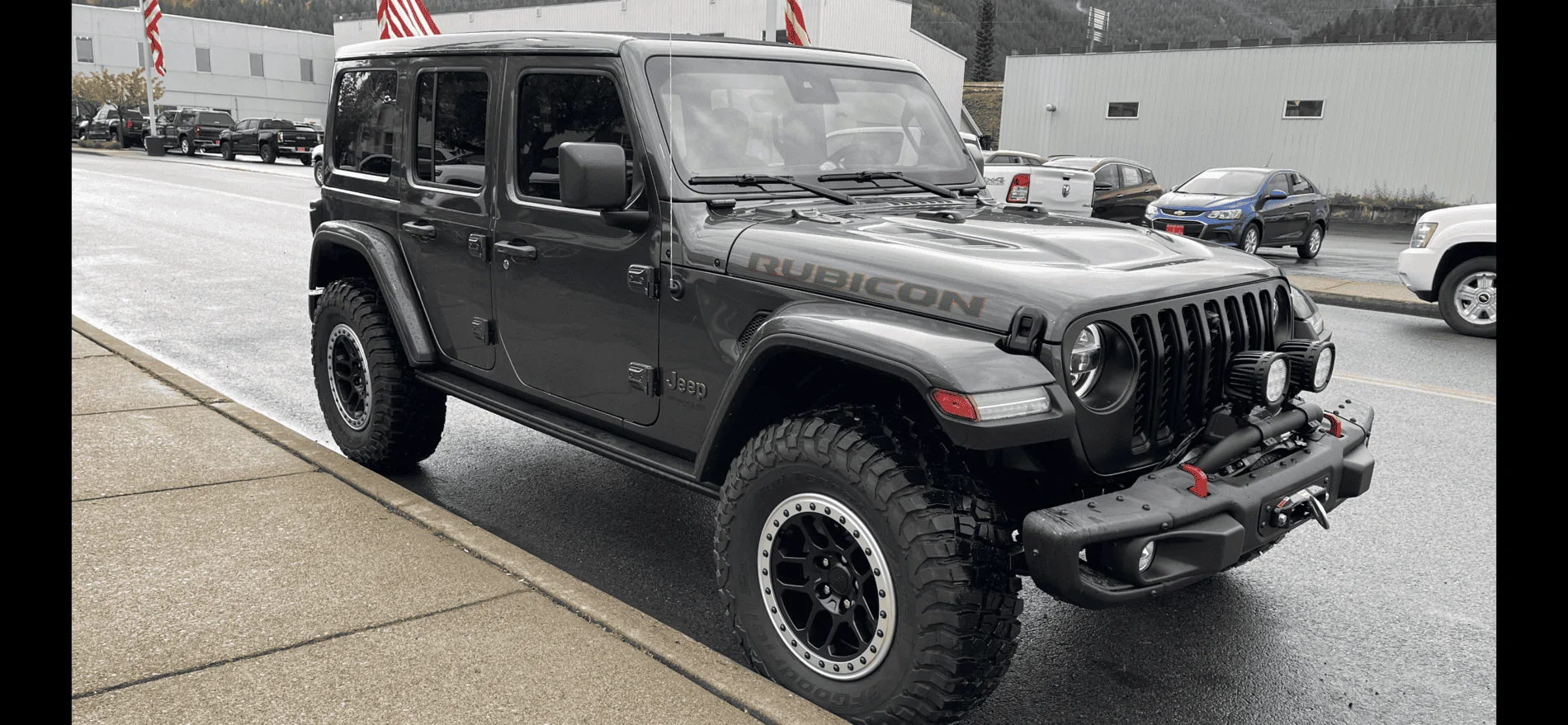

I got 35’s with the mopar bead lock but they are still 17” wheels. Went with bf Goodrich

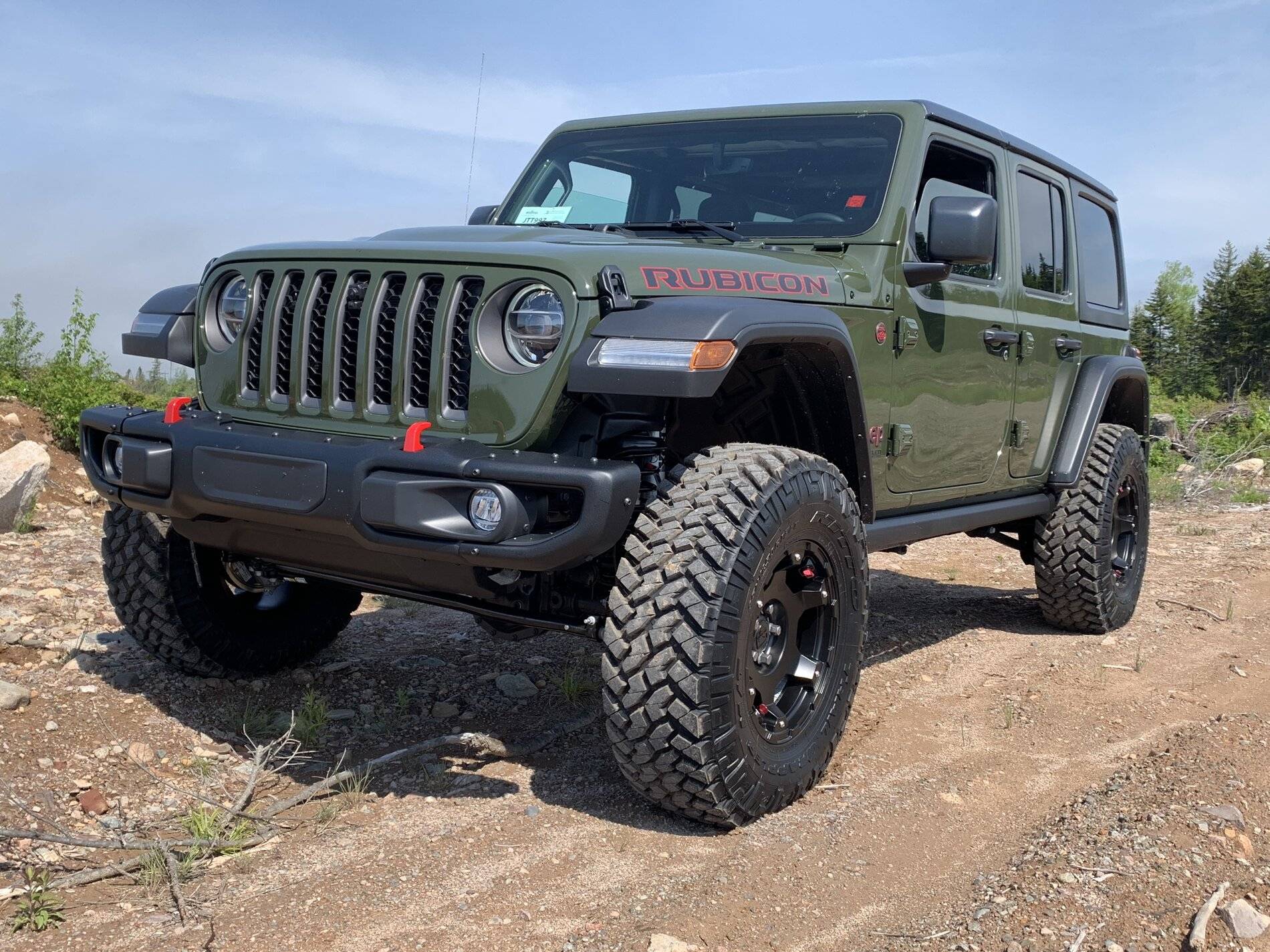

I haven’t put them on the jlr 2dr yet, but I had the nitto trail grapplers on my jkr2dr and they were great, fine with the 4.10 gearing, I currently just installed the nittos on my gladiator, really improved the ride and handling. The only thing with the jkr was 2 1/2”lift and AEV wheels which I will probably do on the jlr and a leveling kit.

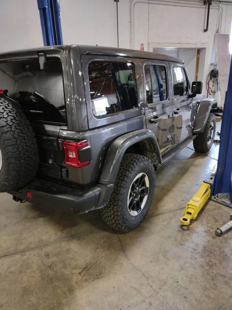

That was originally my intent too on my 2020 JLURD. The factory wheel width was too narrow per BFG specs so I ended up doing wheels too. No lift, no rub, slightly harsher ride (but my tire pressure is 45psi, still adjusting it down. I put the KO3's on mine.

45 lbs. is too high start around 34 lbs ,may have to go up or down a couple lbs.

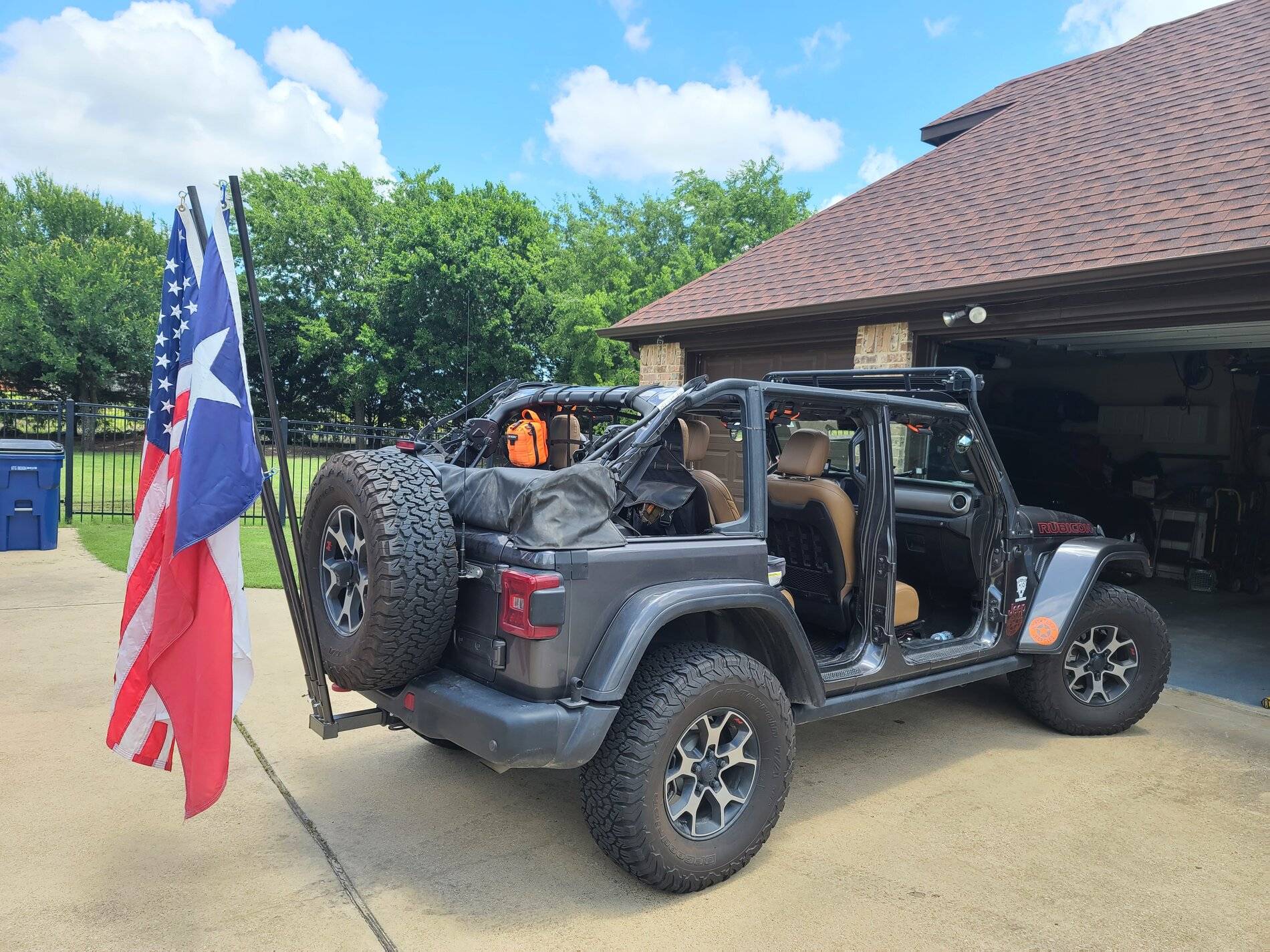

315/17/70 bfg ko2s on stock Rubicon wheels with no lift (yet) on 21 JLURD. Load range e. No concern with tire width as it fit specs and no rubbing even flexed. Have aired down and run off road (rocks etc) no issues. Good on highway too and in snow. Want the lift for extra breakover clearance.
