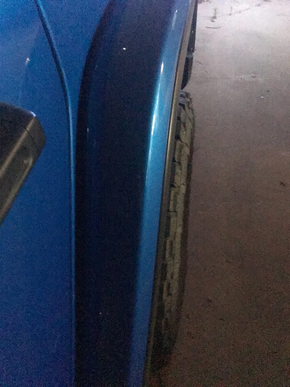

Ignore “recommended” 7.5” - 11.5” wheels are “Standard Guideline” for mounting 35/12.50/R17. Tire recommendations are like a- , well everyone has one. I don’t run sharp rocks or cactus so I run a light C load. 59 lb Toyo AT3 35/12.50. The MT BB are a favorite but ~10 lbs heavier, KO2’s ~ 5 lbs heavier and I prefer the Toyo’s to the KO2’s they replaced. Some like Falkens, but I dismissed them due to ~16 lbs heavier. GY Wrangler was lighter but not 3 peak.
25 is wide axles Rubi flares ? If so 35/12.50’s tread will be ~ even with the fenders on stock wheels, ~ even with XR extensions with ~ 0 offset.

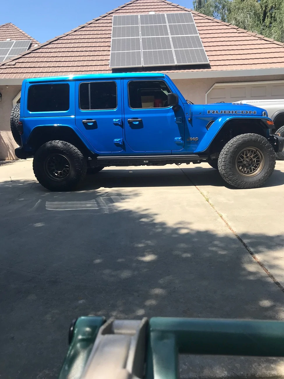

That looks great! RUbicon no, lift and the 1" spacers? Looks like you gutted your inner fenders, did you need to? How low do you usually air down to and got any pics of the tires flexing/squishing?

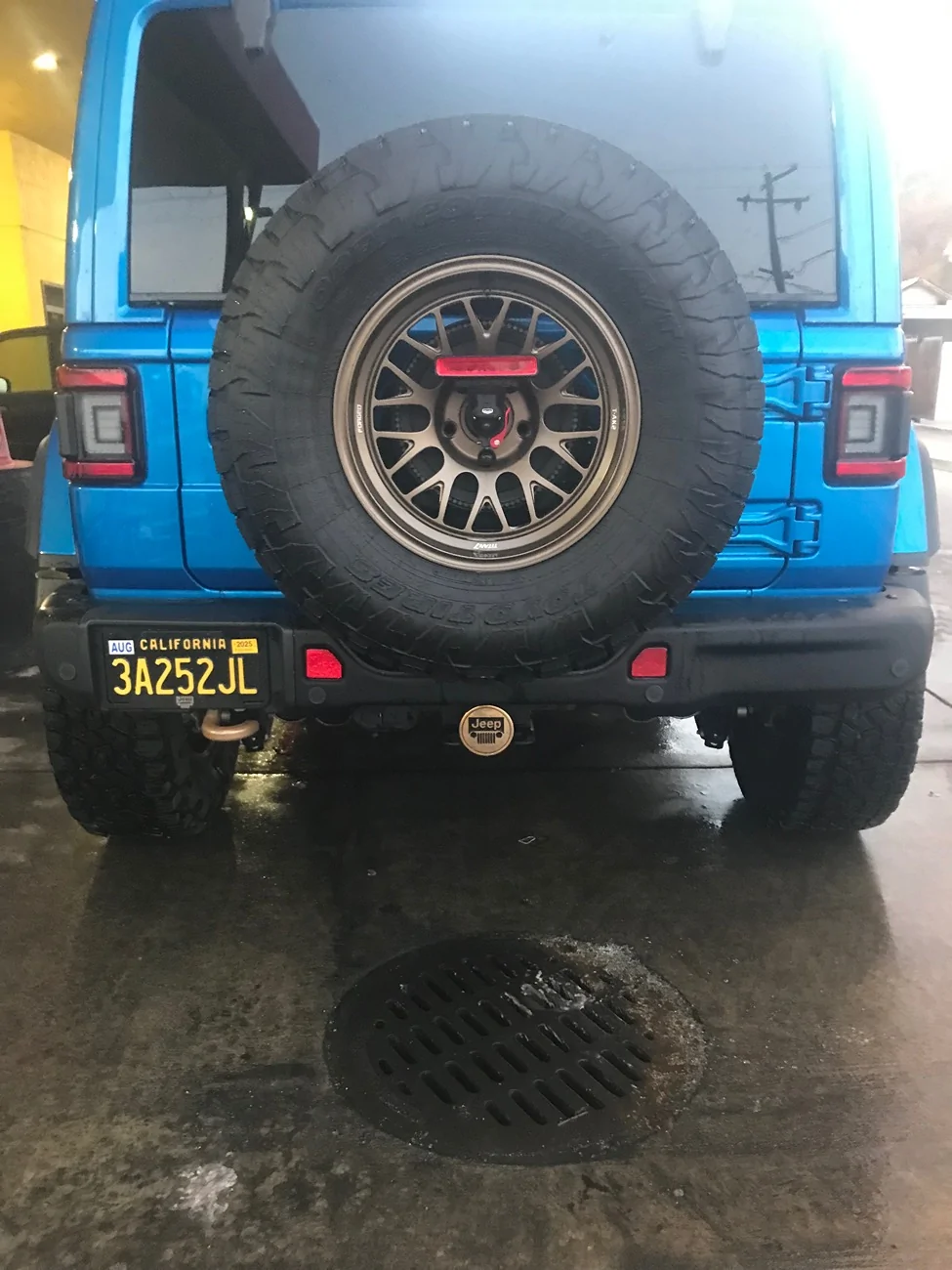

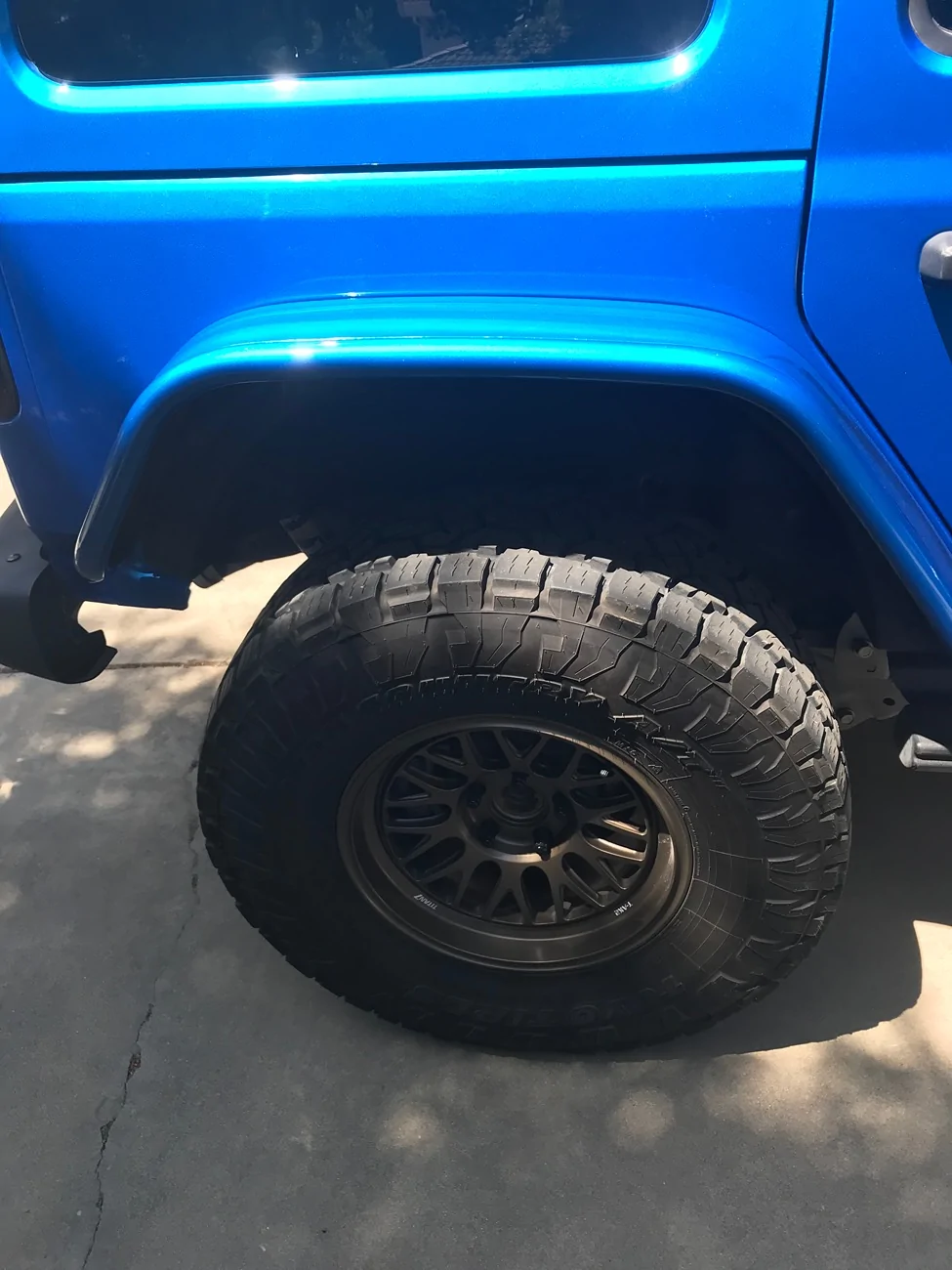

12.50’s on the stock 7.5” did increase crowning. The 8.5’s do not. My chosen wheels only come in 8.5” -1 mm and it is a sweet spot for them. 9” would be heavier anyway and I wouldn’t have spent the money to just go 1/2” to 8” wheels. XR extensions were $75 thru All Mopar Parts, get the rivets to replace the original ones plus 1 extra hole per flare needed.
-1mm, XR Ext. w 35/12.50’s
Jeep Wrangler JL Going from 33s to 35s? A0A72802-166C-47F5-98C0-92DE518368A5
stock w 35/12.50’s
Jeep Wrangler JL Going from 33s to 35s? B47EF1BA-4E18-4966-8B15-FD0EA8288E71
2.5 AEV lift fenders are not gutted. ~12 psi off-road. I really don't have a lot of photos in action but they work very well.
