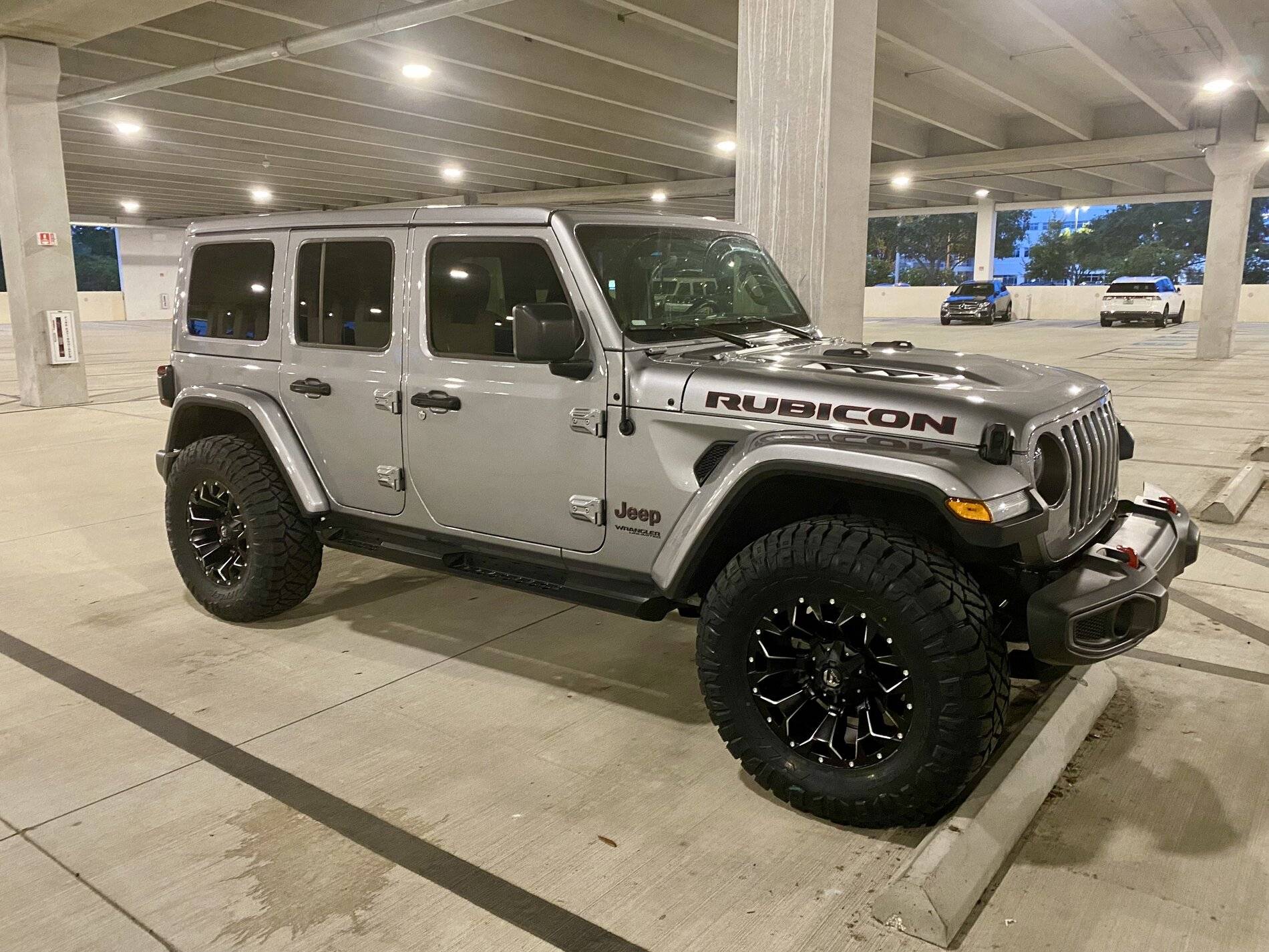

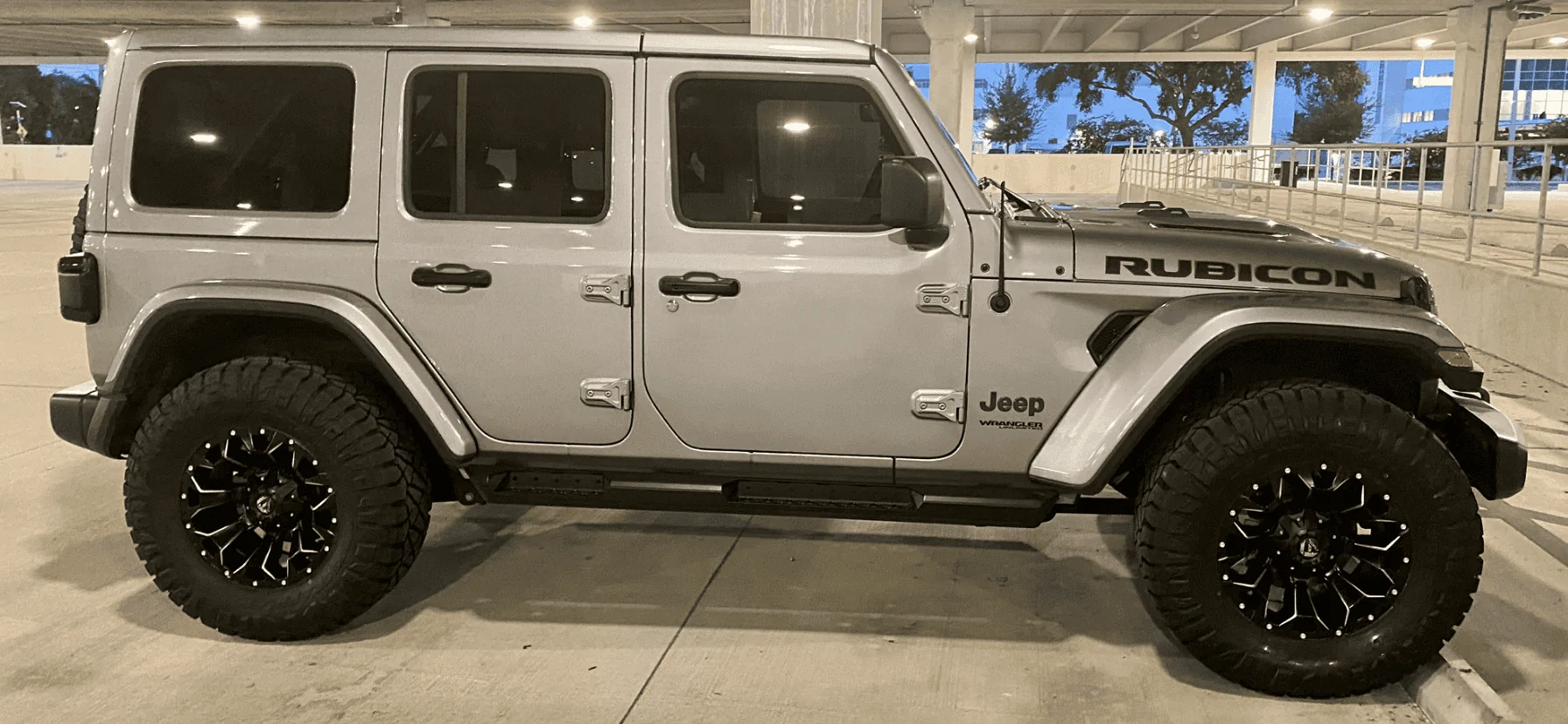

Some fitment pics of the 35x11.50 on stock wheels. The wheels look different than yours, but have the exact same offset/width/diameter.
I have 1.5 inch wheel spacers on my Jeep and that’s probably why it looks different
