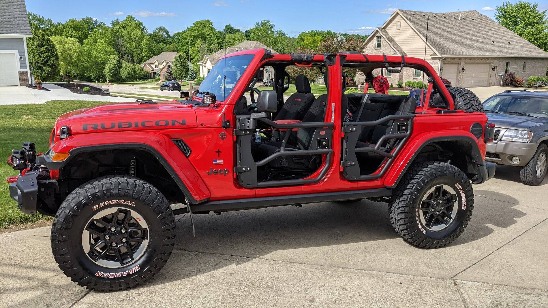

I have the 2" Mopar lift and added adjustable front/rear track bars.
I ran 315/70/17 KO2's which is exactly the same as the 35x12.5x17, except they are C load range rated which makes them lighter and ride MUCH better. They were outstanding on and off the road. I have just a week ago swapped them out for General Grabber X3 mud tires in 35x12.5x17 also in a C load range rating. I think they may even ride smoother than the KO2's, but at least as good. The KO2 was excellent in snow, too, btw.
Anyway, I run them at 30psi cold. The KO2's still have a lot of tread left after 47k miles and a 5 tire rotation. I'll be throwing them onto my JK at some point, but I think they could have gone 70k or so.
Power wise, the 35's will work well with your 4.10 axle ratios.
Oh, and one more thing. I have mine on the same stock rims you have and they are great. Some will say they are too narrow. They are not. They are fine. The narrow rim is known as a poor man's bead locker and they also keep the weight down. Also, if you air down for off-roading, they bulge out nicely and protect your rims.

Some of the MT's have more siping than they used to and will do a little better. My brother has Wildpeak MT's on his Gladiator and they did surprisingly well this winter. Maybe not as good as an AT, but not bad like the KM2's I used to run. The General Grabber X3's I'm now running have similar siping to the Wildpeak MT. But no doubt the AT's do better.

They do wear a bit more in the center, and I've confirmed that on mine with a tread guage. BUT. Some AT and MT tires are actually designed to do that because the center section of tread is designed to be more road-oriented. I can't speak for the KO2's being designed that way except that it appears likely. The 285's on my JK are doing the same thing and they are on an 8" wide rim. Just not quite as pronounced.
At the end of the day, the longevity on the 35" KO2 on the stock rim is there. 47k and they still have quite a bit of tread left, even in the middle. I estimate they'd have gone 70k on the 5 tire rotation. I probably would have replaced them anyway at 60k, well short of hitting the wear bars.
