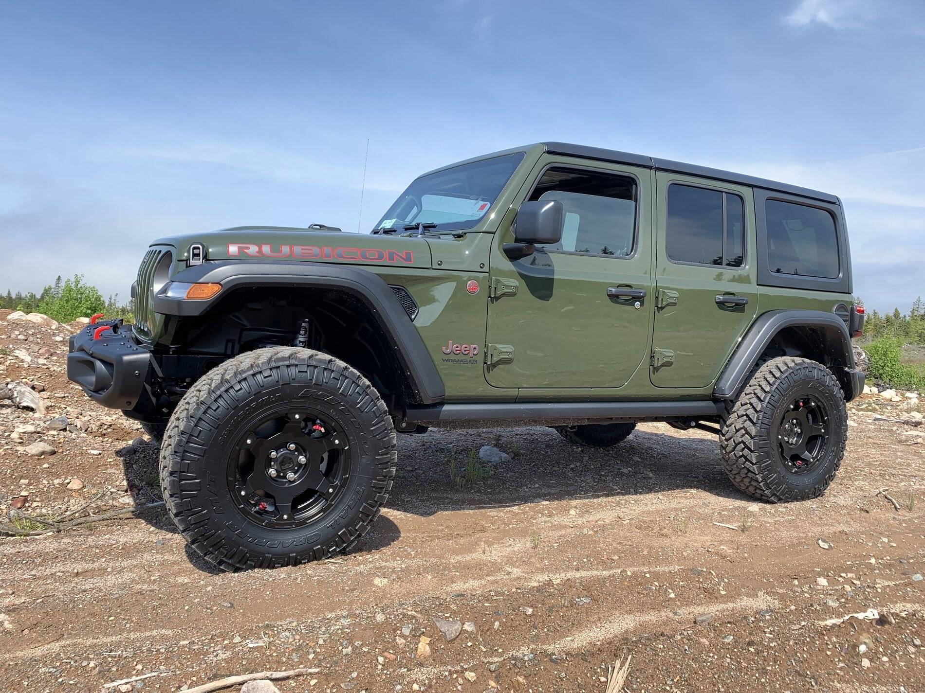

I have been driving the Nitto trail grapplers 35x11.5x17 on my JLURub and like them. Only have 1500km on them. I don’t find them noisy on paved roads.
I do have the mopar 2” lift kit

Rims are 17x8.5 and I installed the mopar tailgate reinforcement kit with oversize spare tire mounting kit so I don’t know if the tire will fit properly on the stock mount

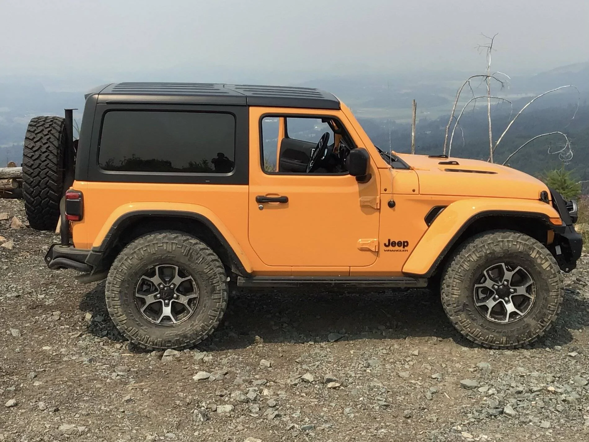

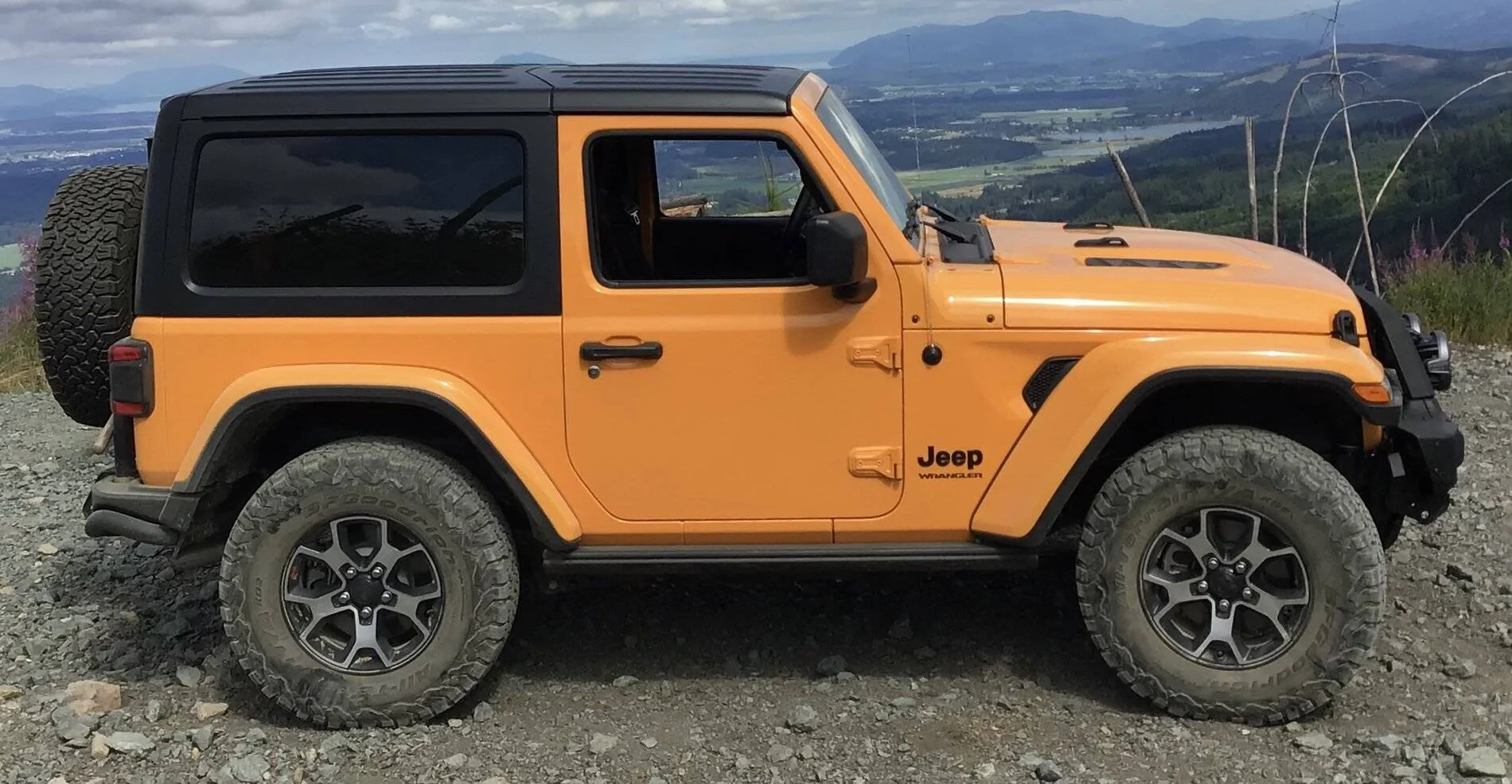

Bought Nitto Trail Grapplers 35x11.5r17s. Have Rubicon and installed on OEM rims. No lift. Took on some mild off road that did involve full flex. I noticed slight touching on the bulge in back of rear wheel well liner under full flex. Before and after pics below.
BEFORE:
Jeep Wrangler JL Rubicon Going To 35s IMG_0062
AFTER:
Jeep Wrangler JL Rubicon Going To 35s IMG_0087
