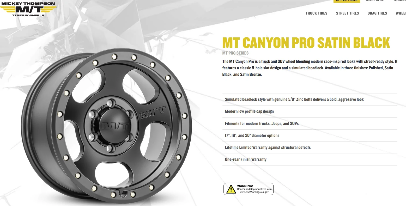

MT Canyon Pro in satin black finish:
https://www.mickeythompsontires.com/wheels/canyon-pro-black

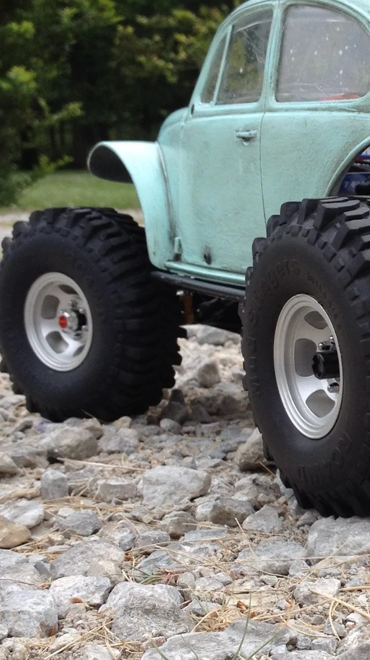

In a way they kind of remind me of a slot-mag. I love me a good slot-mag…
And I love me an RC scale crawler with slot mags!
That was a fun build and one I should have kept for sure lol.

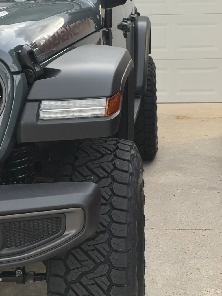

I know I sound like an AEV fanboi broken record but I have had AEV wheels on every jeep and ram I have owned...they have the correct backspace for scrub radius and no rubbing with either 35's or 37's.. for me just the right amount of poke...I don't like wheels that stick out too far but I know some do and we all have different tastes...AEV borahs can be used as bead lock wheels or without or with just protection rings so very versatile. easy to paint the rings if you want too. but again we all have different tastes..some think they are ugly.

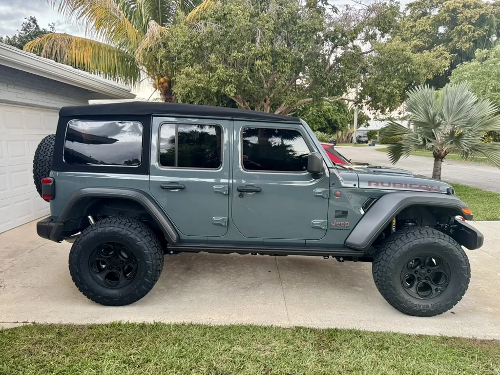

22' JLUD here, Stock suspention & wheels.
I put on a set of falken wildpeak AT4w 35x11.5 on the stock willys rims, no major issues so far.….
Tires have been great in the snow, better on fuel milage, and significantly quieter...
Sounds nice, pictures? Had a chance to flex it and see if and where they rub?
….hard to beat the Mickey 255/85-17 on stock wheels..add some 1" BORA spacers which are high quality and the thinnest spacer you can use without trimming the stock lugs..properly aired down they are a great tire on and offroad.…
I know people will tell you the E rated 255/85-17 will ride rough but I have not found that to be the case nor have the people who actually are running it.
Any rubbage without the spacers?
AskBin
Apr 14, 2025
170
163
22' Willys EcoDiesel
slight rubbing here and there at full lock going over uneven surfaces. i was going to put on my shocks that came in and do some testing today but its currently -22 out and i learned the hard way that metal tools in sub 20s dosent feel good haha.
from what i can tell theyre perfectly useable daily driving, ill have to get some pictures for ya when i go out next. might do all that at the same time with my flex testing, ill make a full post about what i find
