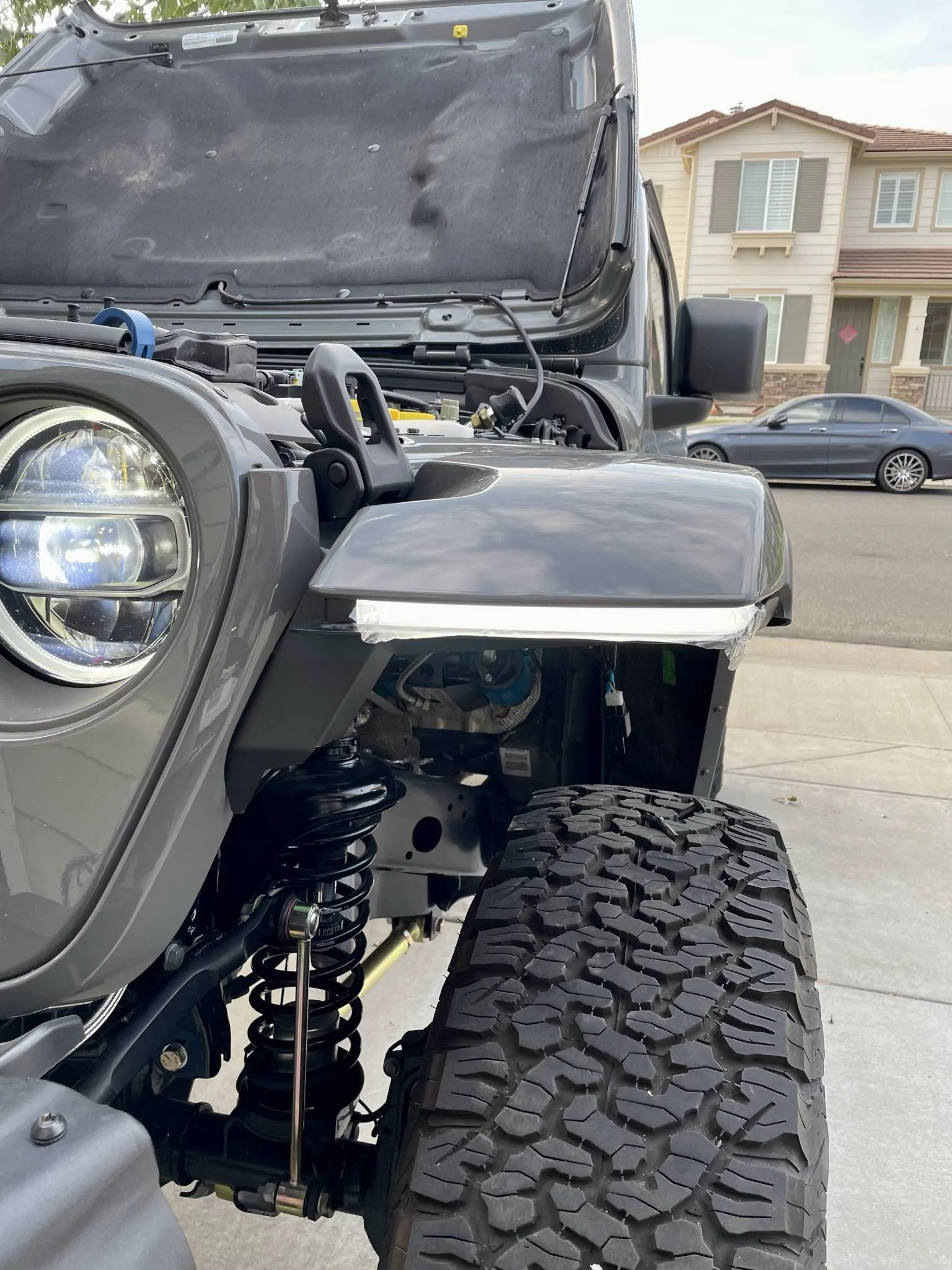

MetalCloak Front Track Bar Reinforcement Kit/Sector Shaft Brace
I just finished getting the MetalCloak parts installed to strengthen my steering. MC wasn't cutting any corners when the designed this bracket, super beefy.
Here's a few pics of the new parts going on Rubi. It's a pretty straight forward mod, however, there are 4 holes to drill and nutserts to install. That always takes some time. Also, my sector shaft/pitman arm nut was a beast to get broken loose. We had to put a torch on it and warm it up a bit.
Jeep Wrangler JL Rubi Recon IMG_6634
Jeep Wrangler JL Rubi Recon IMG_6635
Ready to mark and drill the new holes...
Jeep Wrangler JL Rubi Recon IMG_6638
Jeep Wrangler JL Rubi Recon IMG_6641
Jeep Wrangler JL Rubi Recon IMG_6646
All finished up. Now, I've got to admit there was a surprise waiting for me with this install. My steering had always been good on my Jeep. I never expected to feel any difference in the way the steering felt after this install. I did this mod for strength reasons...the 37's are capable of applying a good amount of leverage against the frame side track bar mount and I want to beef that up.
Here's the surprise...the steering on my Jeep feels better now with the new brace/brackets in place. I didn't think I was going to feel anything from the steering wheel with this mod. I noticed on the first turn out of the garage that the steering feels more direct/responsive. So, this is telling me there must be a little flex to the frame side track bar mount running 37's, larger wheel offset. Who knew(I certainly didn't)? Next up, hoping to get the Apex Steering Boost on Rubi here soon. Stay tuned.

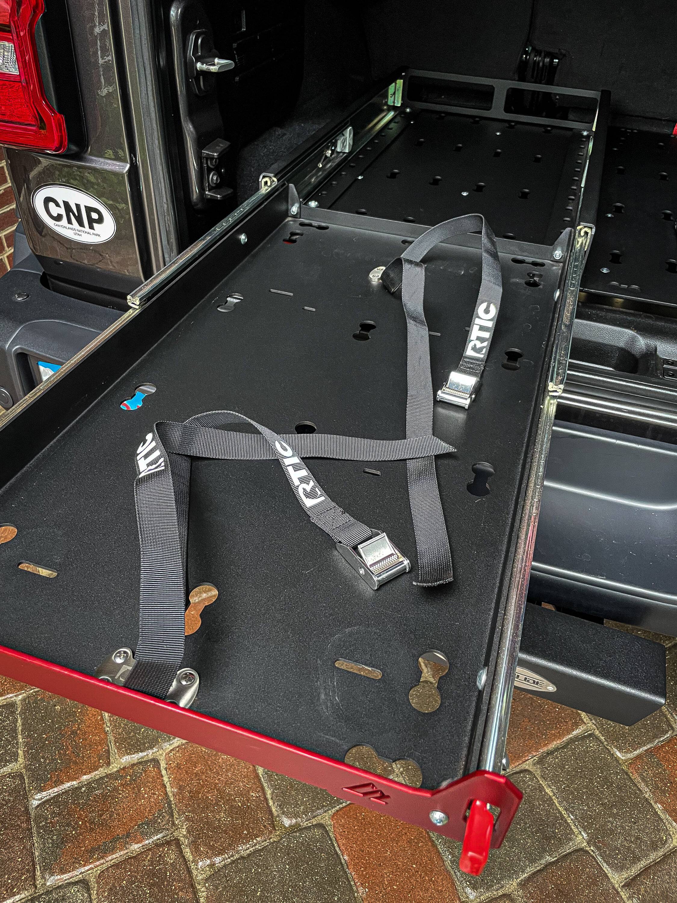

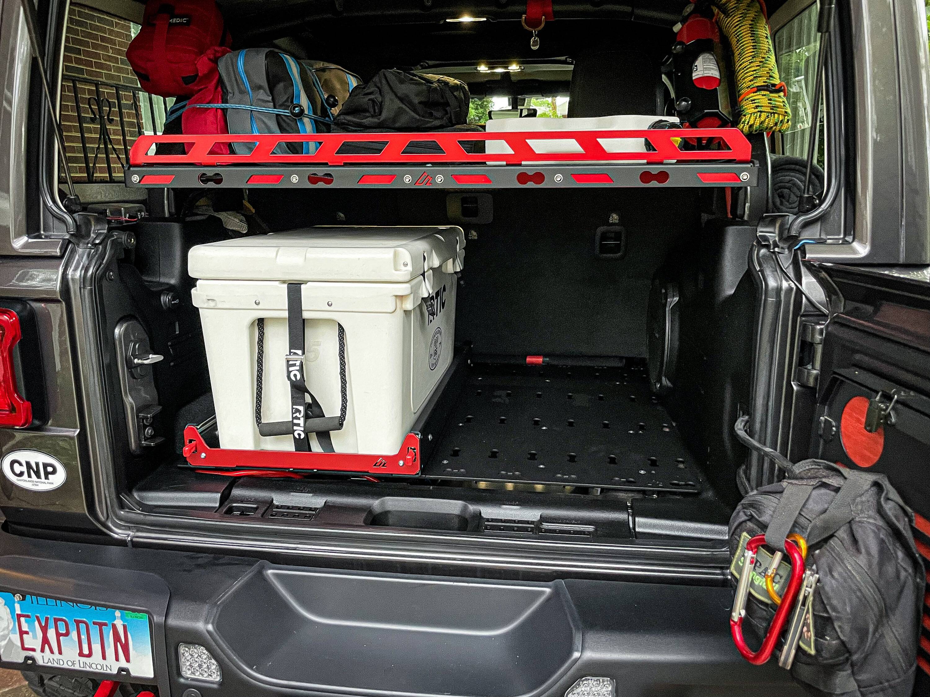

I love this AAL Fridge Slider setup. When we are not out on the road I remove it from the Jeep to give me more cargo area. When I need it, four(4) small bolts and it's back in the Jeep ready for another adventure.
Jeep Wrangler JL Rubi Recon IMG_6712
Jeep Wrangler JL Rubi Recon IMG_6714
Let's get out of here.....ready for the road in about 15 min...
