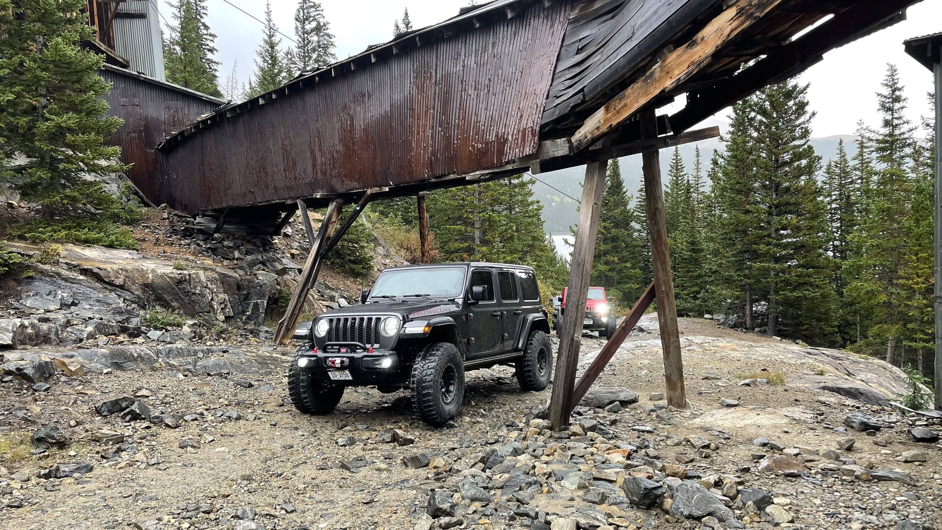

I didn't realize how new your XR was, nice you got a feel for it before the lift goes on. Did you rub much with the new 37'S on the trail?Thanks! Jeep did great. I had a 2021 and was ready to regear end of last year. I decided to trade and ordered an Extreme Recon instead and settle on the OEM 4.56s in the ER package before I got much further in my build. I had the Mopar 2” lift on the 2021 so swapped that over to provide a little more room for the 37’s. So I left last week for CO with 800 miles on it with 37’s. I’ll have to say it did pretty darn good. It won’t hold 8th at 80mph into any sort of head wind but does better than it did with the 4.10’s before. Highway speeds it’s fine. I have the MC 3.5 GC and steering system to go on here at some pint. Just putting on some miles first to eliminate warranty challenges should I need something done then I’ll change suspension out. Moab is on my list in the next year or two. Here it was in the rain at the mill at the beginning of Wheeler lake.
37's look perfect...trail looks amazing!
My plan is to leave the 4.56’s. I live in smaller community so daily driving for me is 50mph and slower. That gearing and 37’s so far seems to work pretty good.I didn't realize how new your XR was, nice you got a feel for it before the lift goes on.
We had a stock XR with us when we ran Top of the World at EJS this year. All it really needed was more ground clearance. Do you think you go 4.88's at some point or leave the stock 4.56's? I guess it depends on how you use your Jeep.

That sounds like it will work really well for you. Looking forward to seeing more pics.My plan is to leave the 4.56’s. I live in smaller community so daily driving for me is 50mph and slower. That gearing and 37’s so far seems to work pretty good.
