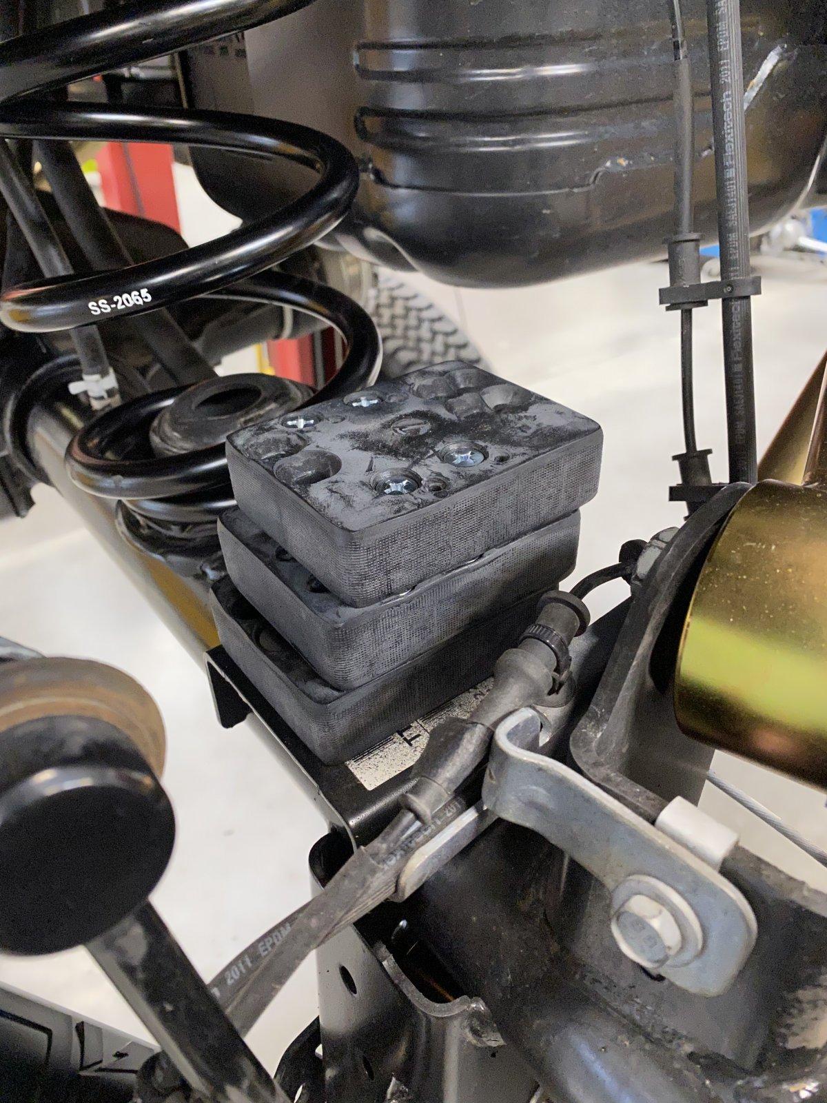

Can you share how much front and rear bump stop you ended up with?
Hi JJ, I'm running ~ 3" (3 pads) front and rear. The MetalCloak bump stop pads I recall being right around an inch each.

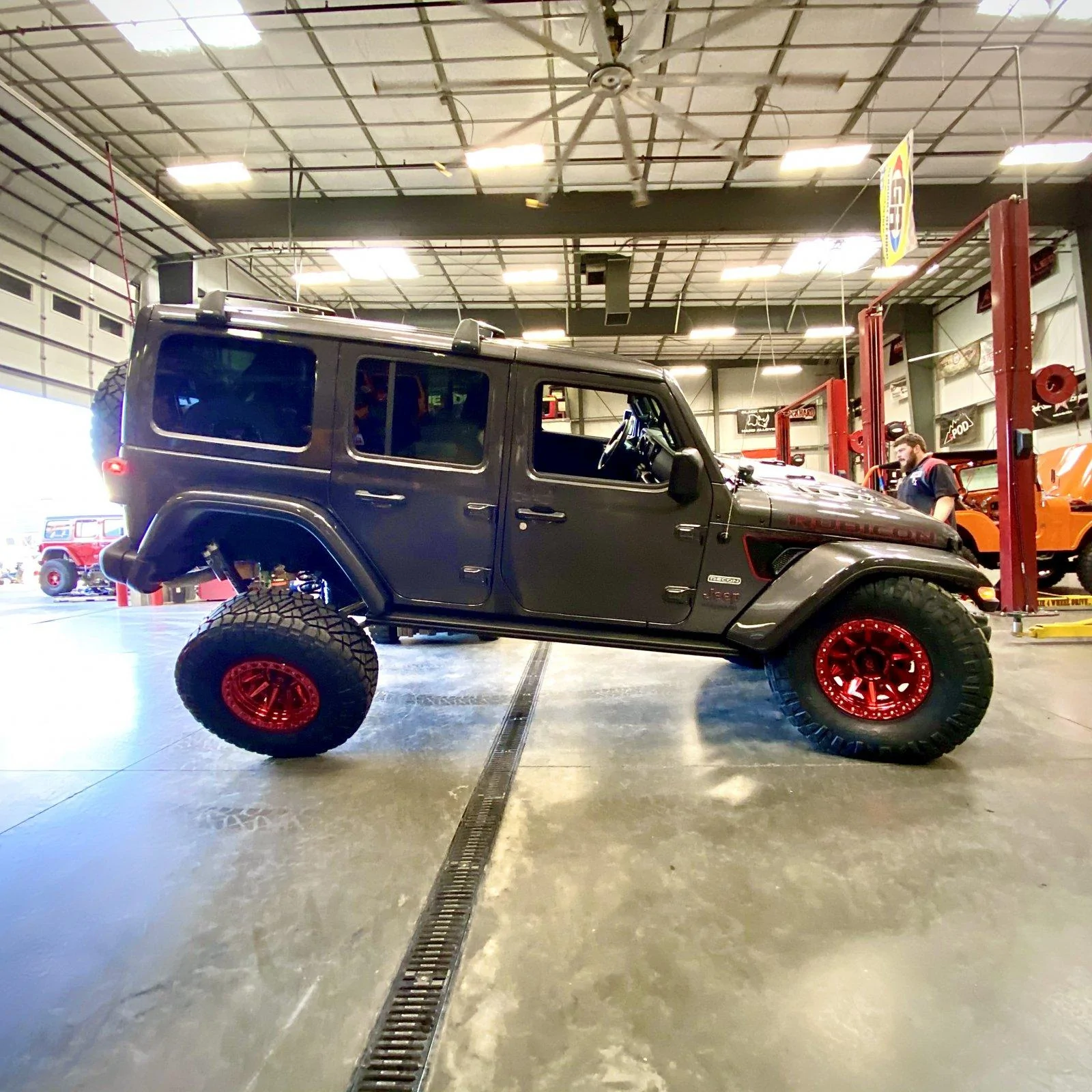

That moment when it's sitting on the ground for the first time and you're thinking...wow, I really like where this is going!

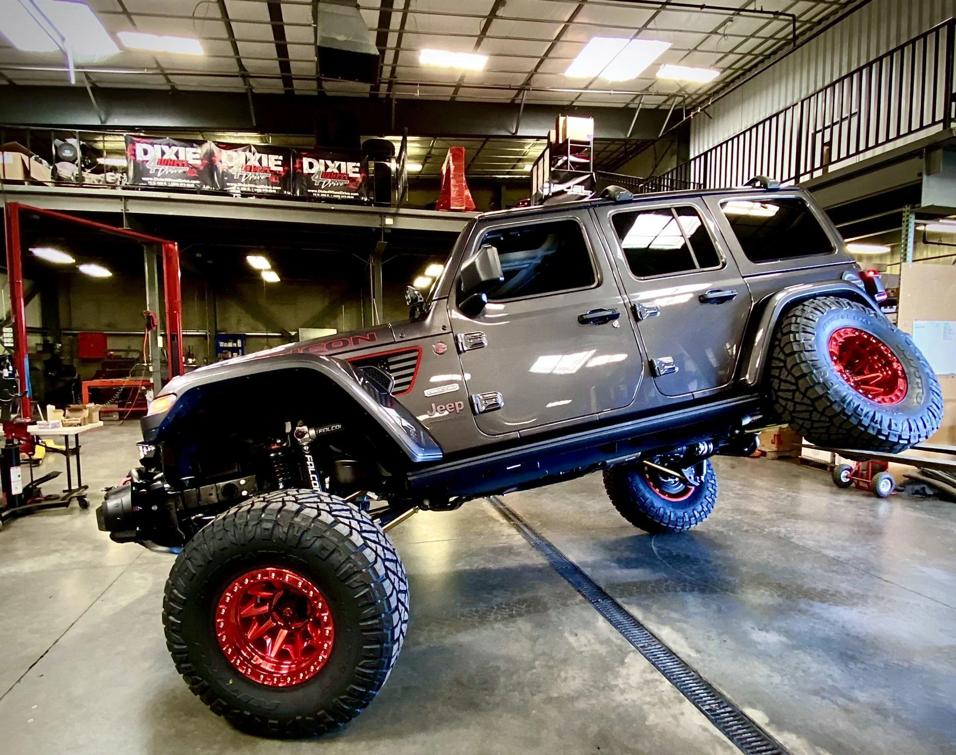

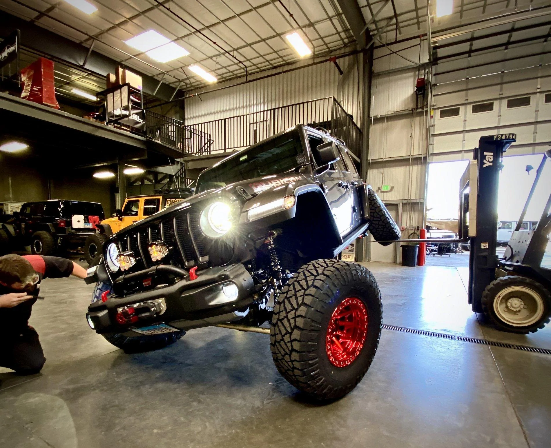

First flex and clearance check...I was grinning like a fool when I saw this!
After first flex, we moved the front axle ~3/8" forward and made a small adjustment to the steering stabilizer.

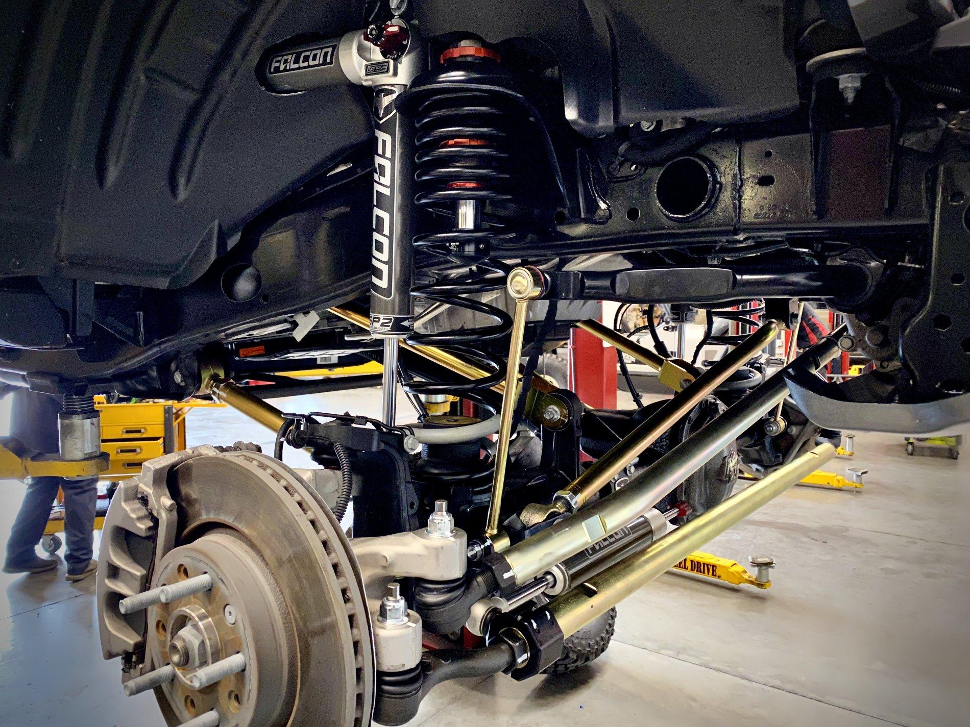

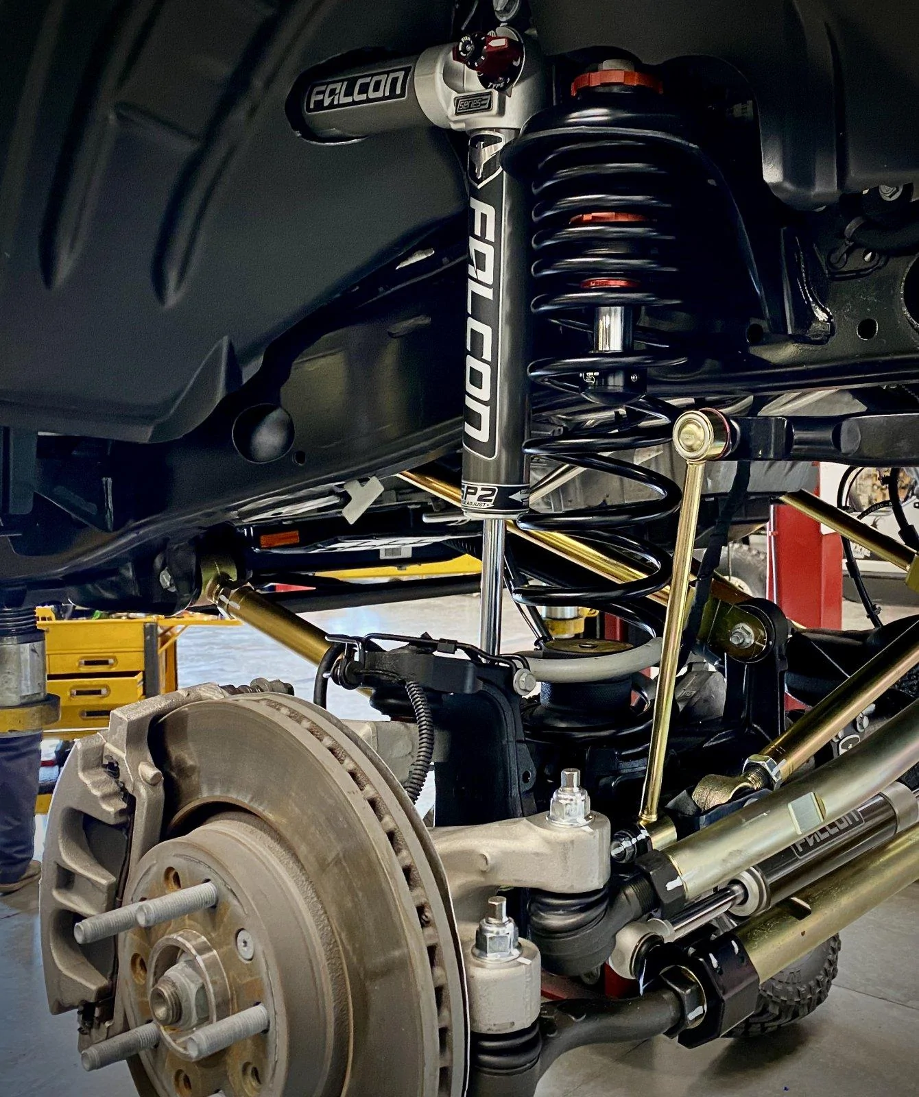

Hi JJ, thanks for the compliment on the build, appreciate that!
You are correct, we did not install the lower shock relocation brackets. When we were installing the MC lift, we did have lower shock offset brackets as part of the lift.
If I'm recalling correctly, the MC lower shock bracket changes the orientation of the lower shock mount. The Falcon SP2's are designed to run at the stock lower mount orientation as the lower part of the shock rotates to adjust compression/dampening between Soft/Performance settings.
Also, the Falcons have a built offset to allow clearance between shock body and frame at full extension. Part of the 'dialing in' of the new lift involved full flex and checking all clearances. No issues of the shock hitting the frame at full flex.
Jeep Wrangler JL Rubi Recon IMG_0854
Jeep Wrangler JL Rubi Recon IMG_0852 2
In the above pic, Travis is checking clearance between the new Nexus steering stabilizer and the new AEV diff cover. That involved cycling the steering while at full flex. Until the parts are actually on the Jeep, you're not really sure it will play nice together.
I was also able to get in two wheeling trips (St.George and Moab) right after the lift was installed, we saw no issues with clearances at all.
-Steven

Those pictures of your Jeep at full flex are just fully insane and I love it. :rock:
Hey Aaron! I couldn't stop grinning when I saw it go up on the fork lift.
Here's another pic just because we're Jeepers...
Jeep Wrangler JL Rubi Recon IMG_0860
We pulled out a tape measure to check it...we saw 36" floor to underside of the rear tire. Seeing the flex helped me imagine coming off obstacles on the trail. I've been super happy with the MC Game Changer.

Looks great Steven ! Rig came out sweet. Are the falcon shocks 2” dia. ? Also do you know what the extended length is in yours ?
I think that the only time hitting the frame becomes a concern is when the shock is 2.5” dia. and up. The MC relo brackets also locates the shock up 1.5” as well as out. I didn’t want to lose that much up travel as I only have 5” as it is with the shocks I’m running. I opted for the EVO bracket.
I think the brackets best benefits the 6 pk shocks. Anyway, your rig looks dialed in none the less ........... great job.........:like:.

Oh yes. Those Falcons do have a slight offset and that’s right. I didn’t think about turning the bottom to adjust between their two modes. Your are right those MC brackets do require a 90 degree rotation at the lower mount. So glad to hear that the MC relocation mounts weren’t needed. Those again for your prompt response!
Justin
Thanks Roky! Here's the specs on the SP2 3.3's I'm running the 2-4.5" length.
The shock dia. is 2.25".
(F) Extended: 28.40"
Compressed: 17.90"
Travel: 10.50"
(R) Extended: 30.00"
Compressed: 18.90"
Travel: 12.20"
-Steven
Justin
Hi Justin, glad to help!
The Falcons have offset at the top as well as at the bottom. The top is for frame clearance, the bottom eyelet is offset as well to aid axle clearance.
-Steven

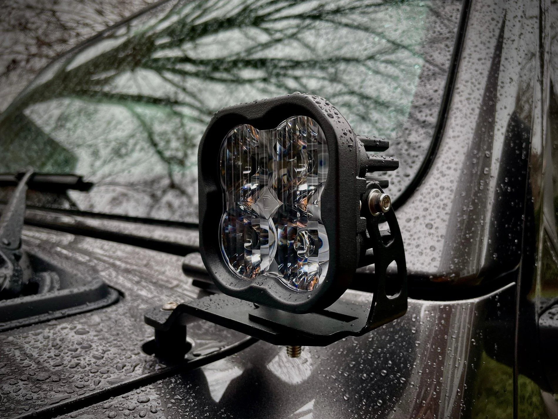

Mod update. I recently installed a set of Diode Dynamics SS3 Pro pods on the A-pillar. These are the SAE Driving lens. Really impressed with them.
