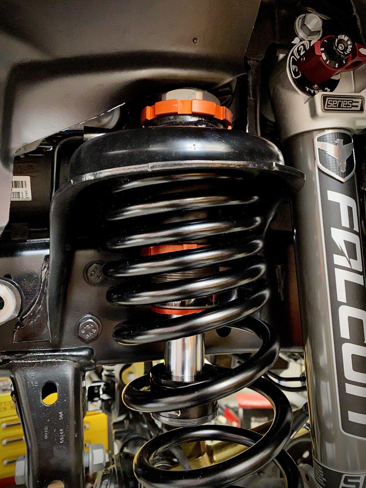

In your picture it appears that the bump is loose, that the upper ring has a gap to the top of the tower. And the top of the bump stop head his bending the inner fender. Can you clarify. 1) Is it supposed to fit that way 2) are these made for the JL, or did you/your shop just make it work 3) how hard was the install 4) do you have a link to the ones you used 5) Why did you chose Fox over King and 6) are these adjustable for pressure with a nitrogen port?

In the pic you are referencing, I shot that during the install. I'm not actually sure the bumps stops were tightened down, although I suspect they were as the springs are in.
I went out and shot a new pic to use as reference.
Jeep Wrangler JL Rubi Recon IMG_2156
Here's answers to your questions:
1) The bump stops are adjusted up/down to the desired length/point of contact. We then clearanced the stock fender liner.
2) These are made for the JL. These are Fox # 883-02-167
3) Not too hard to install. You will need to cut the factory jounce tube. Be sure your cut is square, paint it and install the bump stop.
4) https://www.ridefox.com/product.php...ep&model=Wrangler+JL&year=2020&position=Front I ordered mine NorthRidge 4x4.
5) The Kings were on back order.
6) These use both nitrogen and oil. They are rebuildable. The air valve is located under the strike plate. To my knowledge, they are not adjustable.

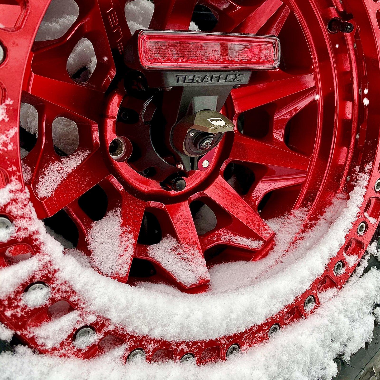

Do you have a final pic of the TF tire carrier to see how the 3rd brake light is installed? I am debating between teraflex and the mopar relocation kit which is more basic.

- Love the TeraFlex Alpha HD Carrier. Rock solid. Here's a pic of how the light relocates.
Jeep Wrangler JL Rubi Recon TeraFlex Alpha
Jeep Wrangler JL Rubi Recon IMG_1159

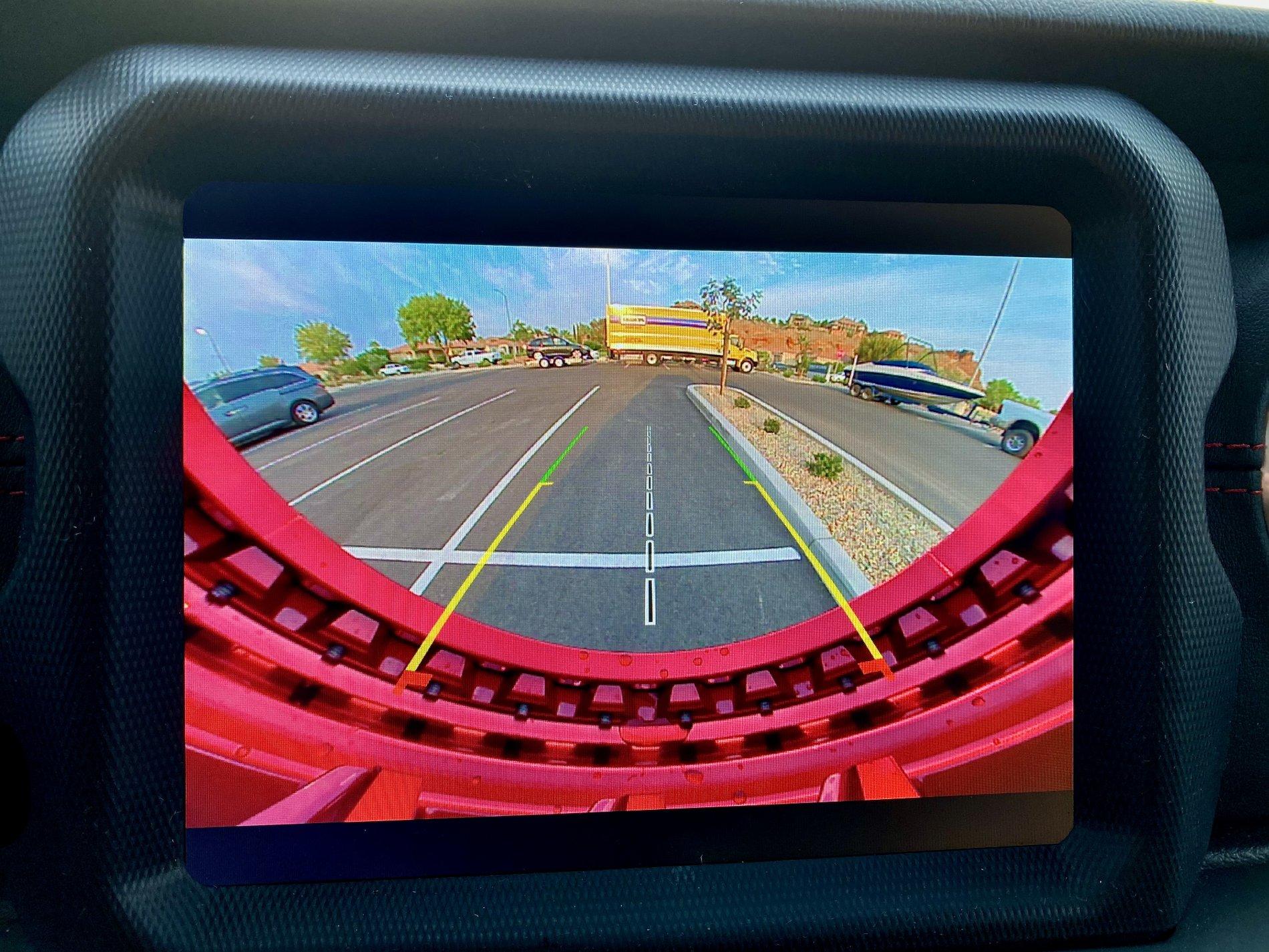

The only thing I'd change is this, with my offset on my beadlocks the camera need to move further out. I plan on doing a mod for that when it's not so damn cold.
Jeep Wrangler JL Rubi Recon IMG_0904
You can see I'm giving up a lot of the downward view through the excellent OEM camera.
