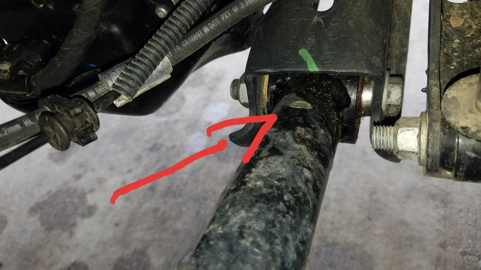

I would measure it. Doesn’t look right. Did they use the relocation bracket?SO, Ive got a question. I just had the x-factor 2.5 LCA's installed along with the front and rear adjustable track bar. As I looked over the work that my shop did on the install I see something that concerns me. The rear adjustable track bar appears to be too long to allow for proper adjustments. Take a look at the photo that shows where the joint is in comparison to the bar.
I just read through your instructions and you don't even appear to offer the adjustable track bar for the 2.5" kit. BTW, Im using a Dyantrac 2" springs with Fox shocks and my added weight I'm probably not even at 2 inches.
The concern I have is that I kinda feel a little wobbly in the rear along with what feels like a bit of crab walk.
Did I receive the wrong part number? (this is what I ordered: RK06692)
How do I actually 'adjust' this if I cant move the joint in closer?
Overall Im really happy with the LCA's and the front adjustable track bar but this rear has me scratching my head.

Rear Track Bar (RK06692)
2.5” lift (w/ bracket) – 37 9/16” 3.5” lift (w/ bracket) – 37 13/16”
