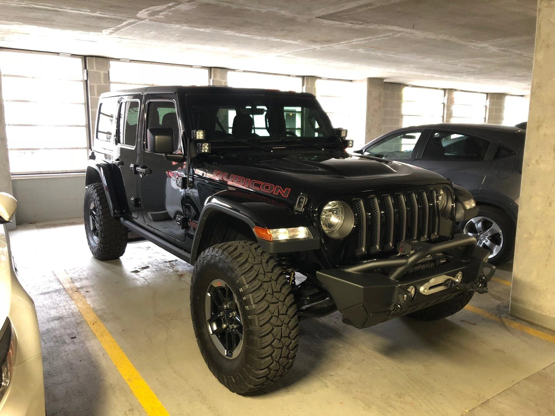

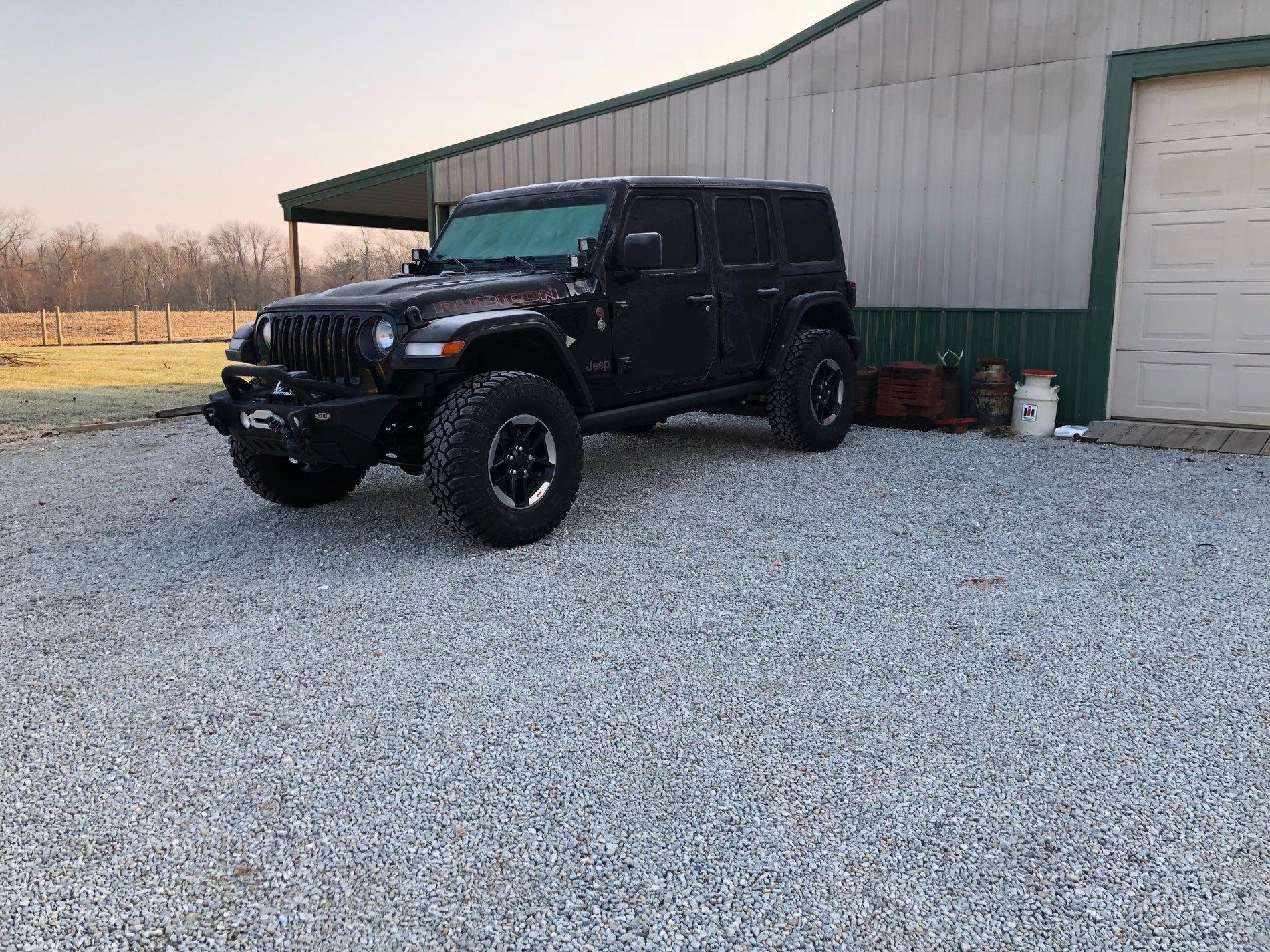

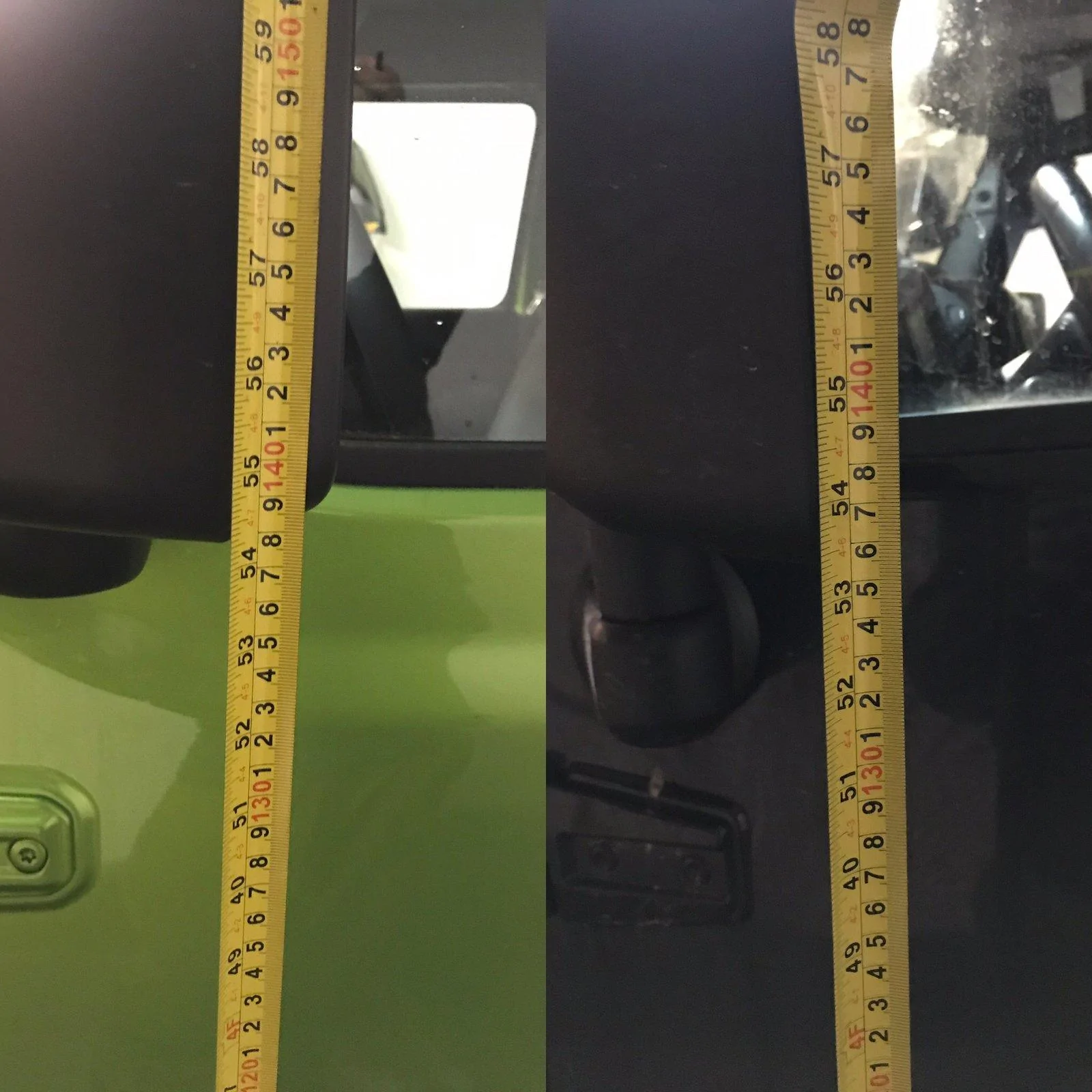

Question here. I have the 2018 JLURubicon 4 Door. I purchased and installed your 2.5" X Factor Suspension.
I feel like my front end is a bit higher than my rear. Would it make sense that my nose is higher than my rear? If so, is adding a 1" or .5" spacer in the rear a good idea?
Thoughts here? I definitely don't want my nose up in the air.
