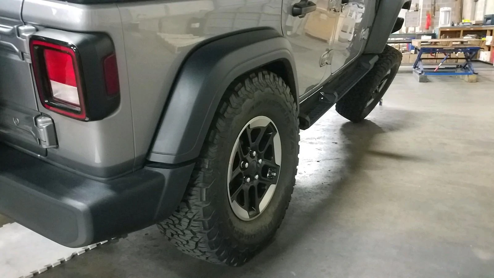

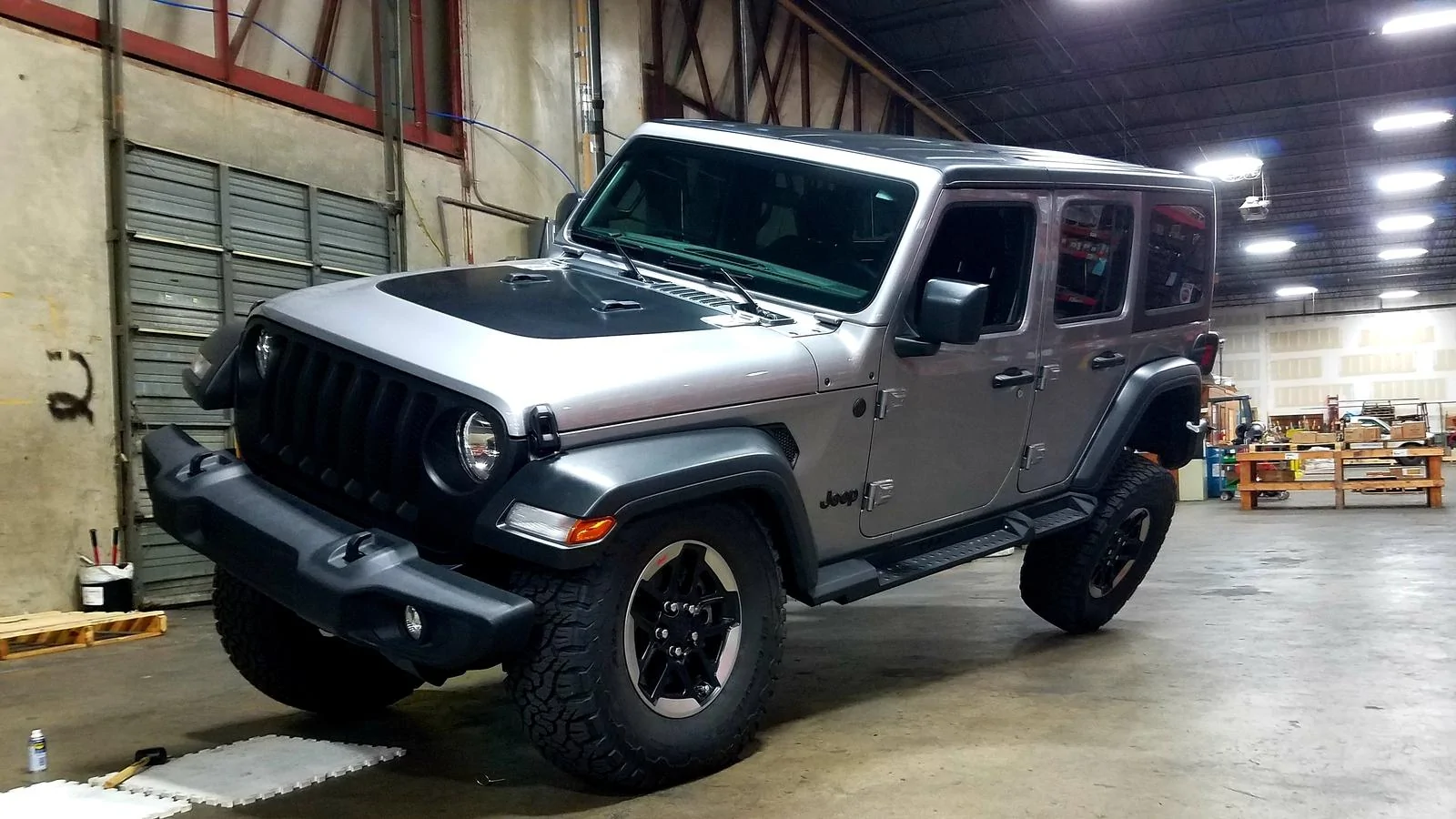

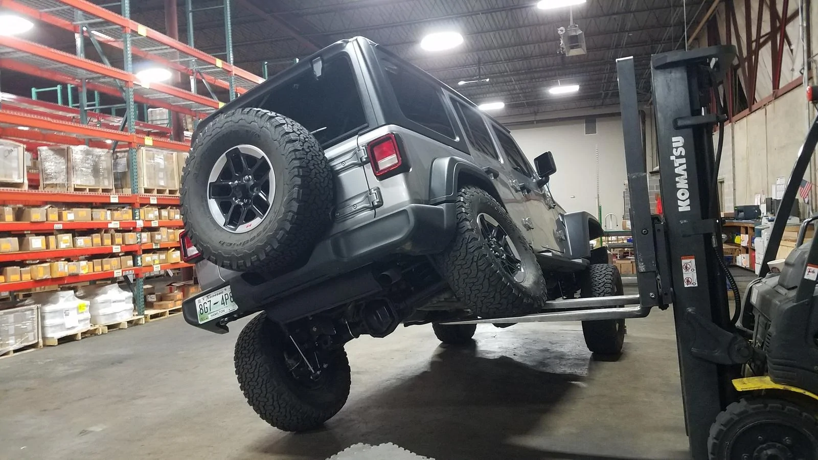

I have 2 bumpstops in front and 3 in rear and with a forklift have been able to compress the front shocks almost all the way with bumpstop fully compressing the round white upper pad. When I lift the rear tire up to 32", I've only been able to compress the upper pad 30% or so and front tire lifts. The rear shock is about 4" away from bottoming out...I checked the tire and it's not touching the inner fender or sway bar. I wonder why it wont flex up more like the front and tuck? @River City Offroad @Rock Krawler Suspension
Here's the front tucking properly and compressing

Here's the rear that should tuck further
Jeep Wrangler JL Rock Krawler 2.5? xbhdEVz
Jeep Wrangler JL Rock Krawler 2.5? hTrRebT
Jeep Wrangler JL Rock Krawler 2.5? ie9YKj

Matt, since you have chosen to run springs that didn't come with the kit, there's too many variables to make an accurate assessment. If you can provide the spring rates, we can make a more accurate call. My hunch would be one of 2 things, one would be that the bushings in the arms are bound up, possibly that they weren't relaxed when springs were changed and they their bind is adding to the effective spring rate. The other would be that the rate of the springs you are running is simply too high for a lightweight JL to fully compress.

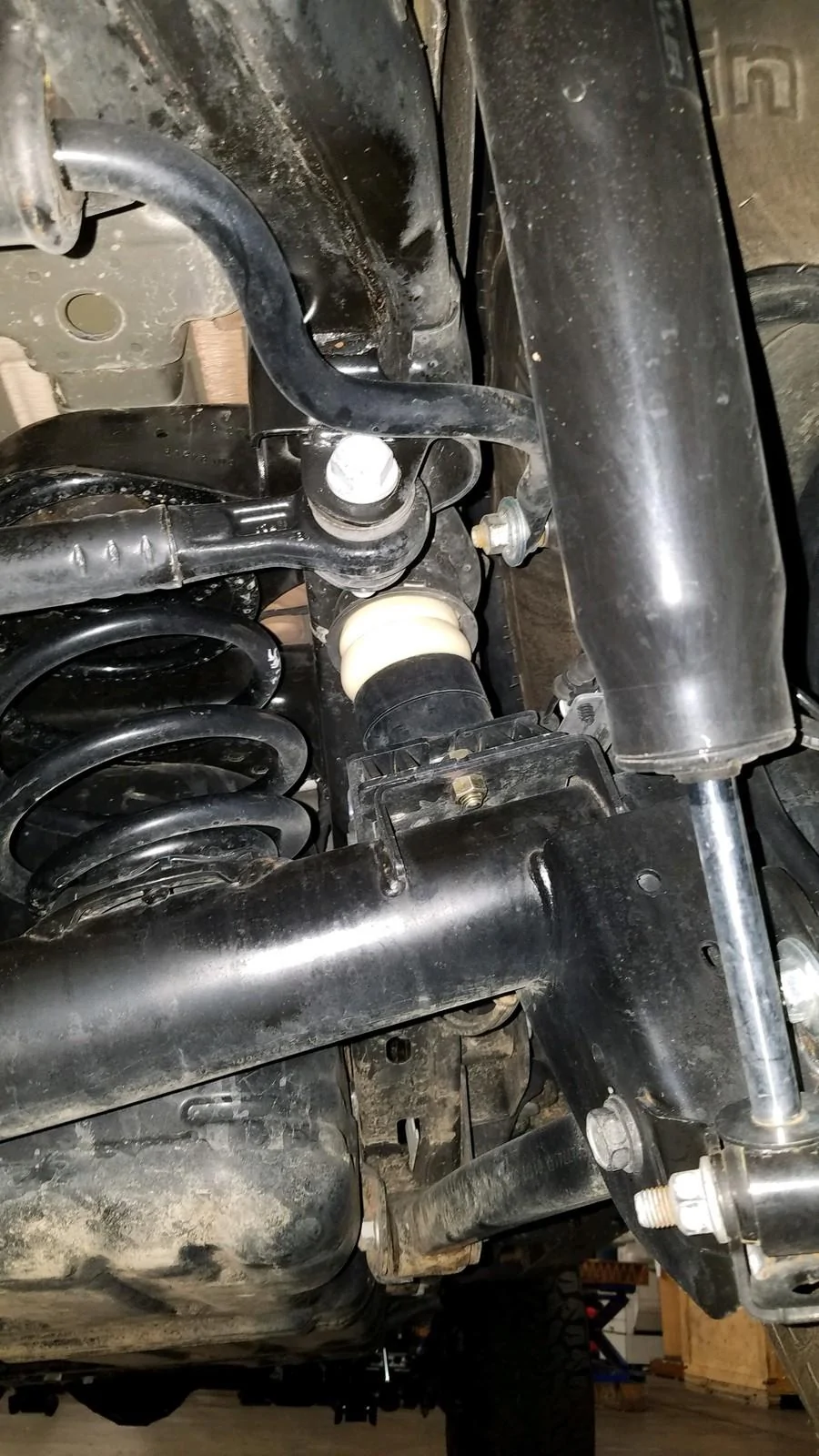

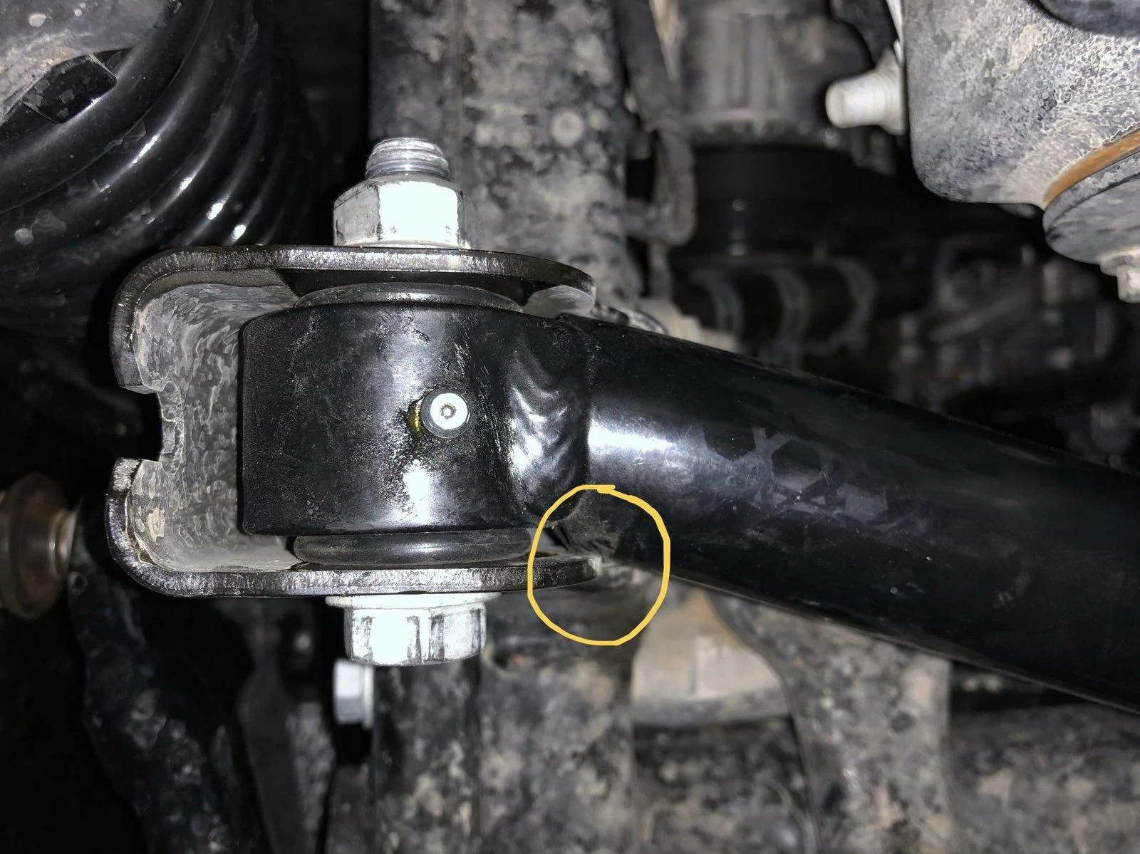

Today I discovered that the lock nut on my front RK track bar was loose so I took it off and tightened it. While doing this I noticed that the bar is pressed up against the bracket on the frame. Is this normal? It doesn’t seem like it.
Which system and which lift height are you on? We see this from time to time and the answers we have found so far is that the arms are adjusted too long, pushing the axle forward. verify the length on the control arms, particularly the lowers and assess from there.
Normally I'd say thats a plausible answer BUT if you look at that picture again you will see that the bushing is parallel with the bracket. Actually, in this and other photos, it appears that its being pushed a hair the other way. If the axle were pushed too far forward then it stands to reason that the joint would be flexed in that direction, correct? To me it looks like the joint was welded a bit off center. Combine this with the tolerances we have to work with on the Jeep, which all seem to be different, and you get a recipe for rubbing.
Sorry for not listing the other components. The LCAs are your RK X-Factor and I have them set to give me around 6.5 degrees of caster angle so as to correct the wandering steering (which it does). I'm running stock upper control arms. with a 2" lift from Dynatrac (springs, Fox shocks and longer swaybar links).
Shoot me a PM, we'll get you taken care of.

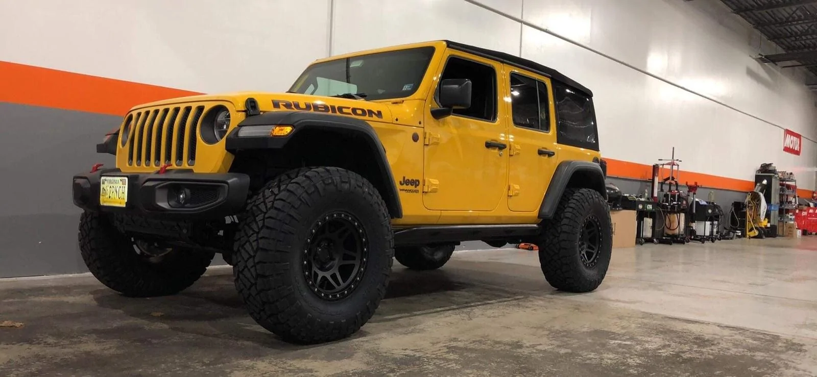

Installed the RK 2.5" XFactor kit with Falcon 2.1s over the weekend. Overall a pretty straight forward install. Ride is a little harsher than stock, but still very comfortable. Dropped it off this morning to get my tires/wheels mounted and aligned.

Looks good, we have heard a few times that paired with the 2.1's we are rather firm. Several of those customers have switched to 3.3's and couldn't be happier. You can fine tune with tire pressure, what are you currently running for pressure in those tires and what load range are they?
D load and currently around 28 psi. I still need to do the chalk test on the tires. What are your suggestions?

On a D load range (I'm guessing 37x12.50) Ridge Grappler, I'd be around 26 front 24 rear and chalk test, should be very close. Plus those are some of my personal favorite tires on the planet.
