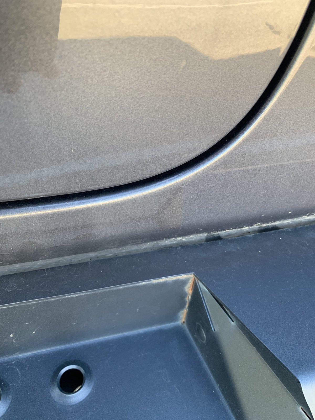

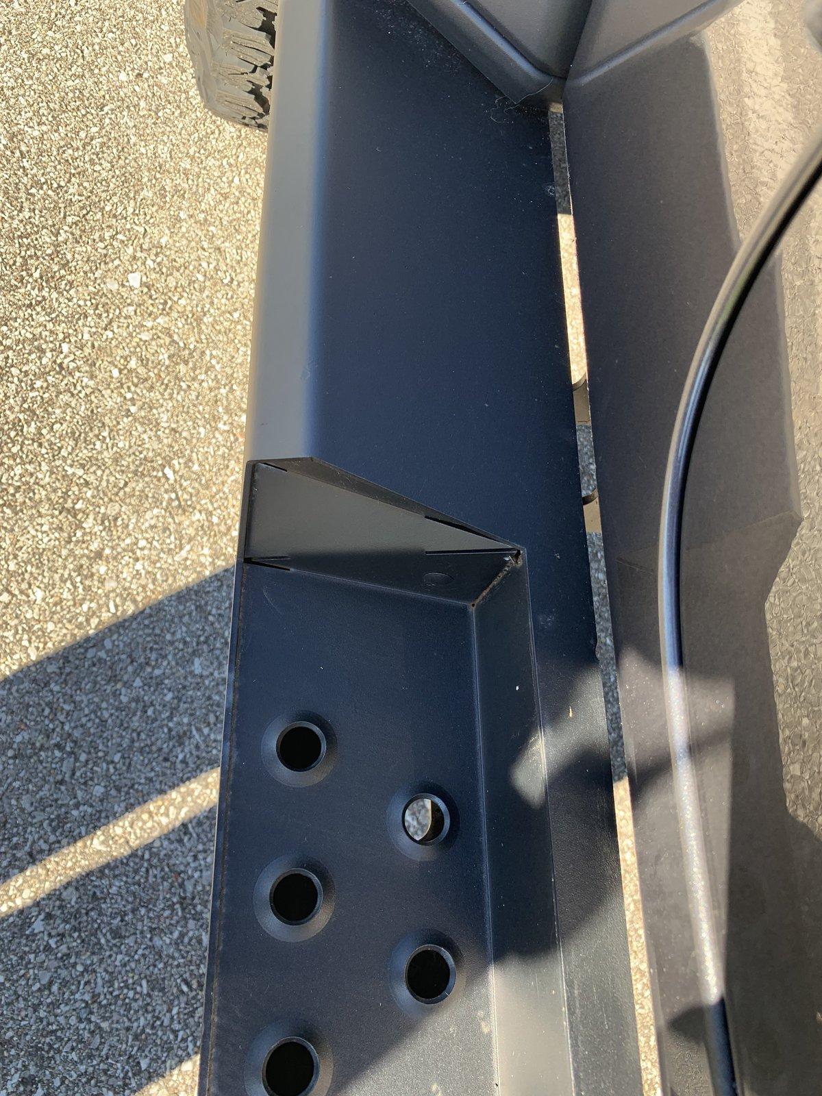

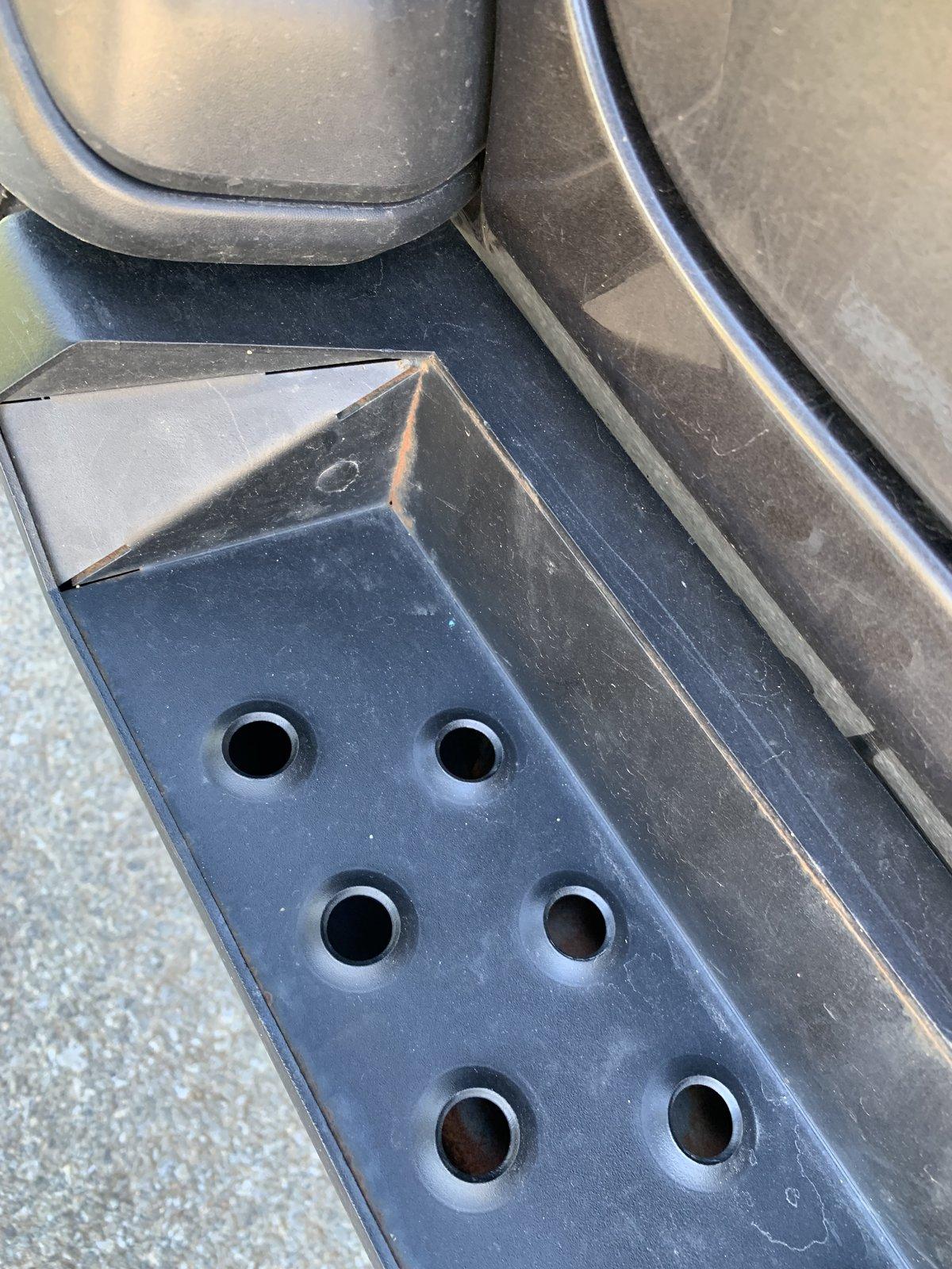

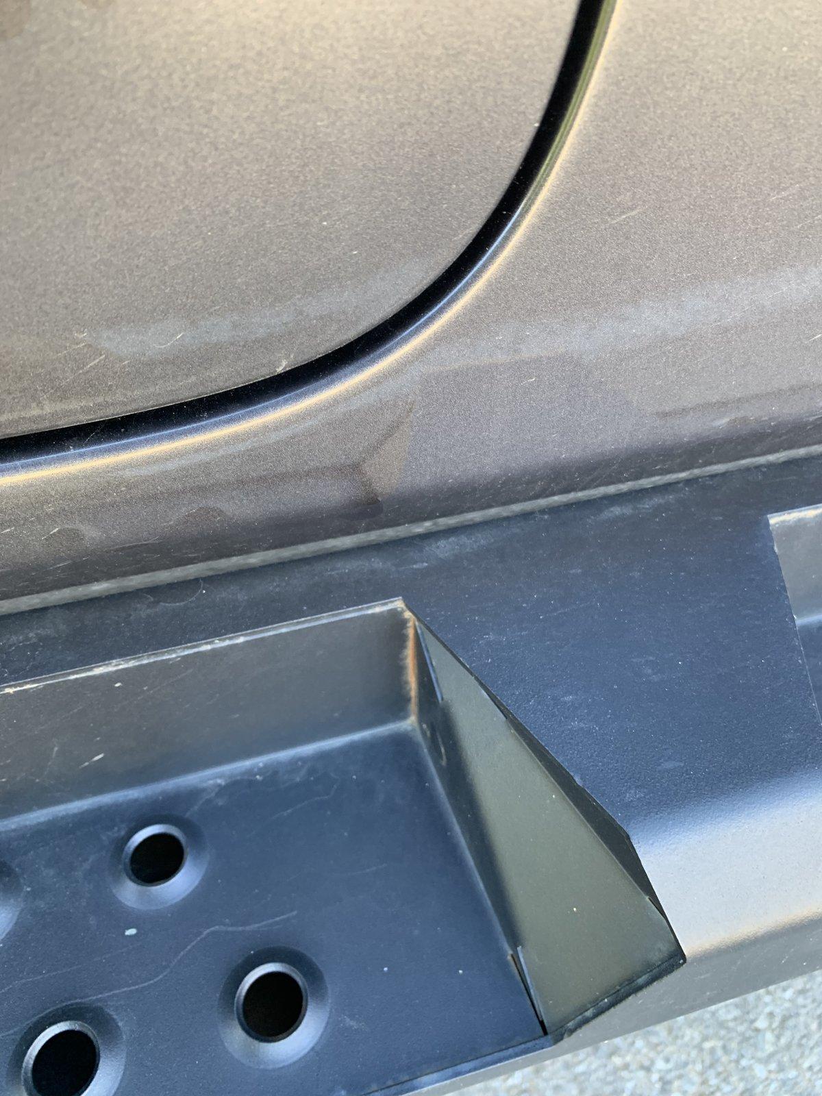

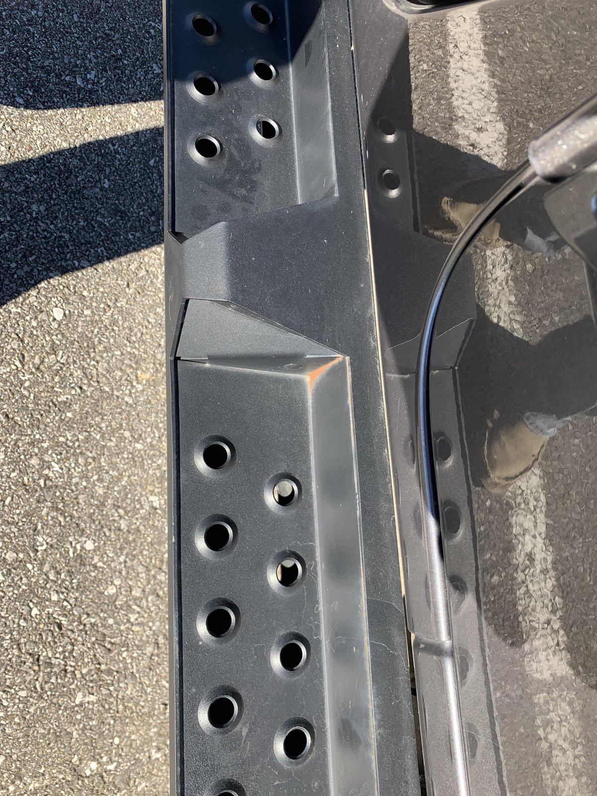

Well, mostly sorry to see others are having the same issue, but a little glad that I’m not the only one. I emailed them with the following pictures and received no reply.

Mine has rust spots very similar to yours. It's even worse inside if I see through the holes. Could you please let me know if you get a reply? Thanks!
