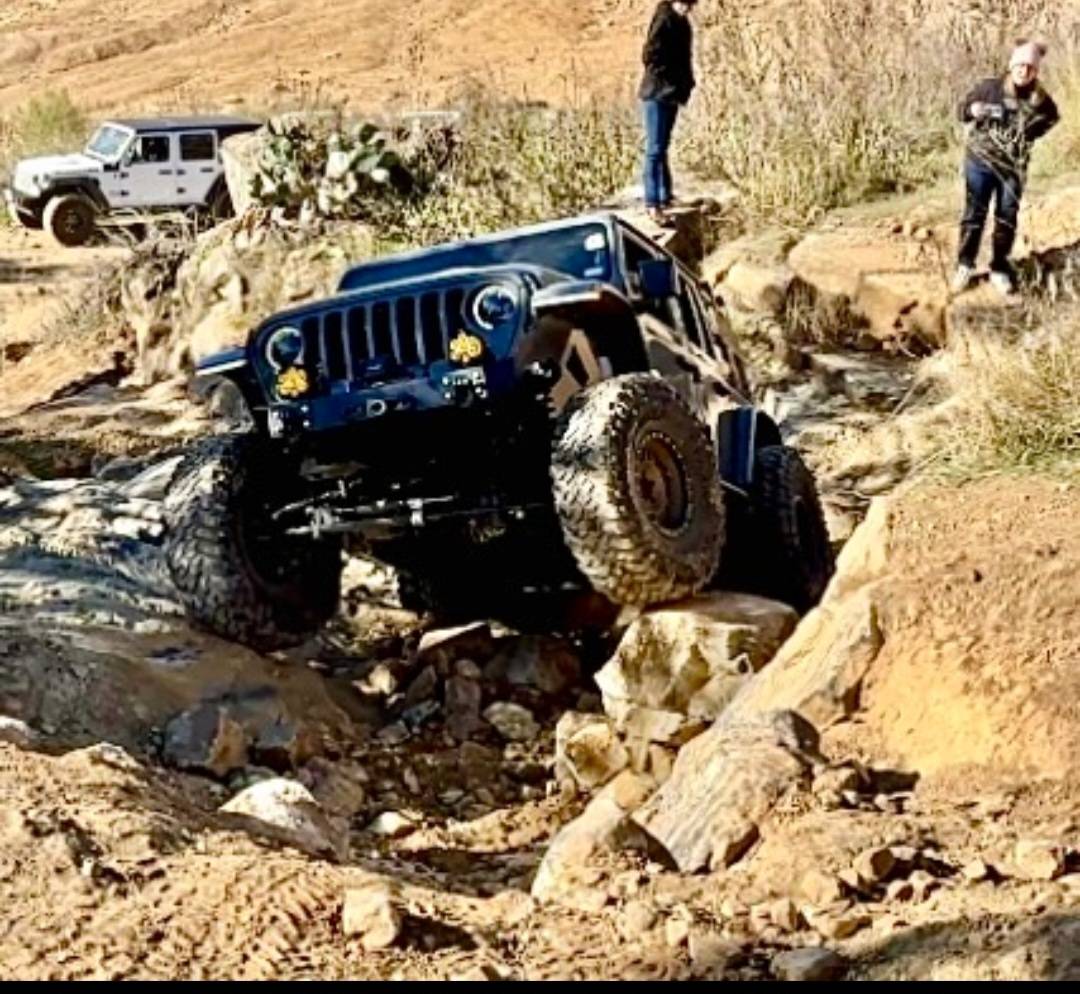

Being the guy who slid off a 4.5-foot boulder, and the steering wheel caught my arm, ripped it out of the socket, and tore 3 of the 4 rotator cuff tendons off the bone, along with the labrum and bicep, I will agree with you. This is with my Teraflex Falcon SS set on firm. I think without a SS, it would have ripped my arm off.
I am 3 months post-surgery and still have 6-8 months of recovery left. The second I was released to do light-duty driving, I went directly to the shop and had a full PSC installed. I am released to go off-roading, on minor trails the middle of next month. It seems like it's been 2 years...

This picture is right before it happened.
