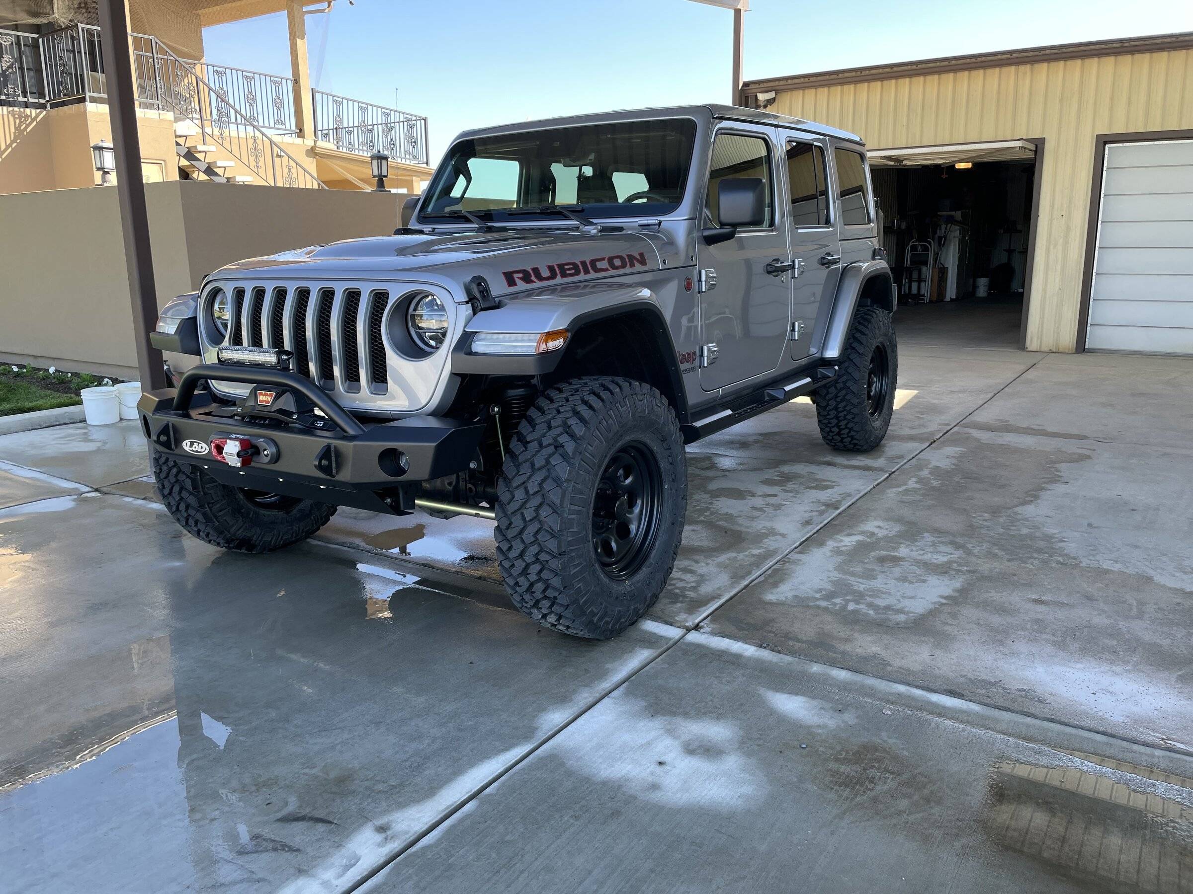

Well, funny you should ask. Just came out from under my 2021 JL and my Rocksport SS is shot. Has a 3/4” jump, when changing direction. Gonna grab a Fox 2.0

What do you mean a “jump”?
