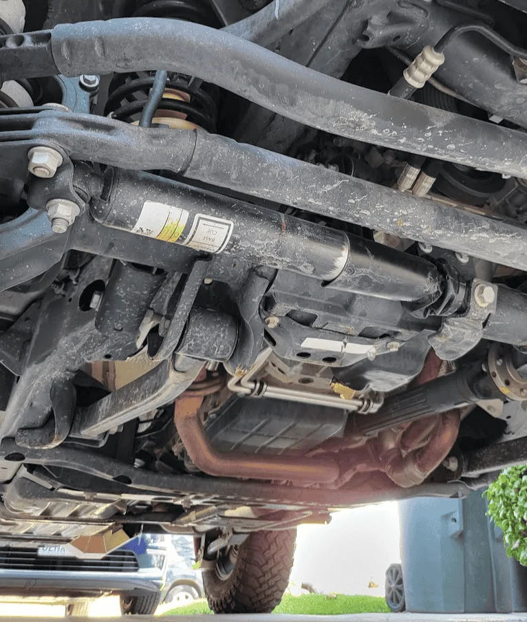

Or replace if you take it off road and bang it up because of the dumb placement below the tierod?!?!?! Why they move it from the JK location?
