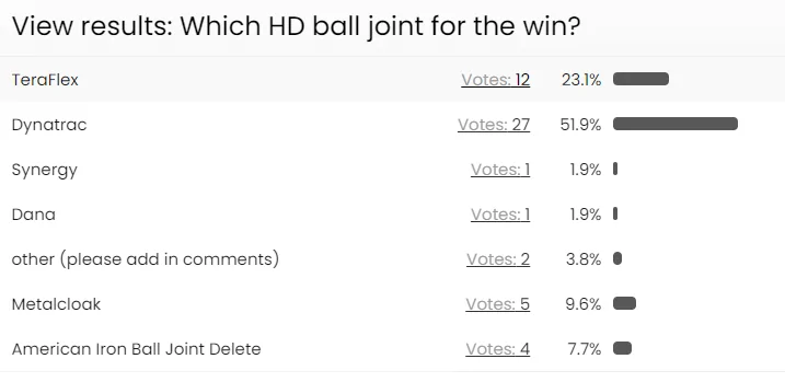

The time has come. I have some deflection on the drivers front that I can feel while driving and hear when the jeep is on jack stands. 20k miles, 17k of that on 37's.
Currently it looks like we have 4 popular options. Am I missing any others?
Metalcloak ~ $650
Dynatrac ~ $650
Synergy ~$300
Teraflex ~ $300
I know the Metalcloak and Dynatracs are rebuildable in place, but $150ish to rebuild them means the break even is 3 full replacements of the synergy or teraflex sets. I only average about 7500 miles a year and don't plan on being buried in this jeep.
Is there a massive increase in strength or durability going to the rebuildables?
I do wheel in the rocks, but I don't drive it like I need to win King of the Hammers either.

Dynatracs ……. It’s not the amount of times you’ll replace them, it’s the fact they don’t come back out, especially with the aluminum knuckles…..the less remove/replace the better…. Besides they’re tried and true, proven badassness….. The other companies talk a good game but until they walk the walk, I’m not drinking the koolaid……….

Roky, that's kind of where I wonder if there is an advantage in my use case. The crappy factory ones lasted 20k.. will the synergy ball joints last 40k? how bout the dynatracs?
I honestly don't think I'm going to keep this one for 5 more years. If/when the new engine comes out in a JL or the JMs land, I'm probably switching.
I understand the rebuild in place aspect, but is there a real strength difference in the joint itself?

I couldn’t say if they’re actually stronger or not to be honest….. And this day and age it’s hard to predict how long anything is gonna last……but I’m in it long term with this rig, so what’s good for me is not necessarily good for everyone…… With your plan, I’d say anything but oem will probably work for you…..

Thanks Roky. Any thoughts on knurled vs not? The Apex joints that @Hucke_250 posted look slick, but only come knurled.

I am with Roky on this one i went the route of dynatrac. they back their products and have good customer service. you pay a price for good parts made in America. My OEM ball joints lasted 20K as well. I am now 7k miles into the dynatracs and they still feel great even with running 37's since day one. my OEMs spent most of the time with 33's

I wouldn’t worry about the knurled, you’ll likely won’t need to replace them again, and if you do you’ll probably want to get steel knuckles at that point anyway….. I’d be more concerned about the brass bushing, not a fan…..

I like the Teraflex. They have an adjustable preload nut. As they wear you snug it up to spec. That makes them last a lot longer. No having to disassemble half the axle to rebuild them.
Either way, doing ball joints is a good opportunity to upgrade to steel knuckles. When I did mine both MOPAR and Reid were close to the same price.

No issues with the zerk layout on the teraflex joints? Saw someone smashed the ports during install, and Murphy's Law is a thing.
