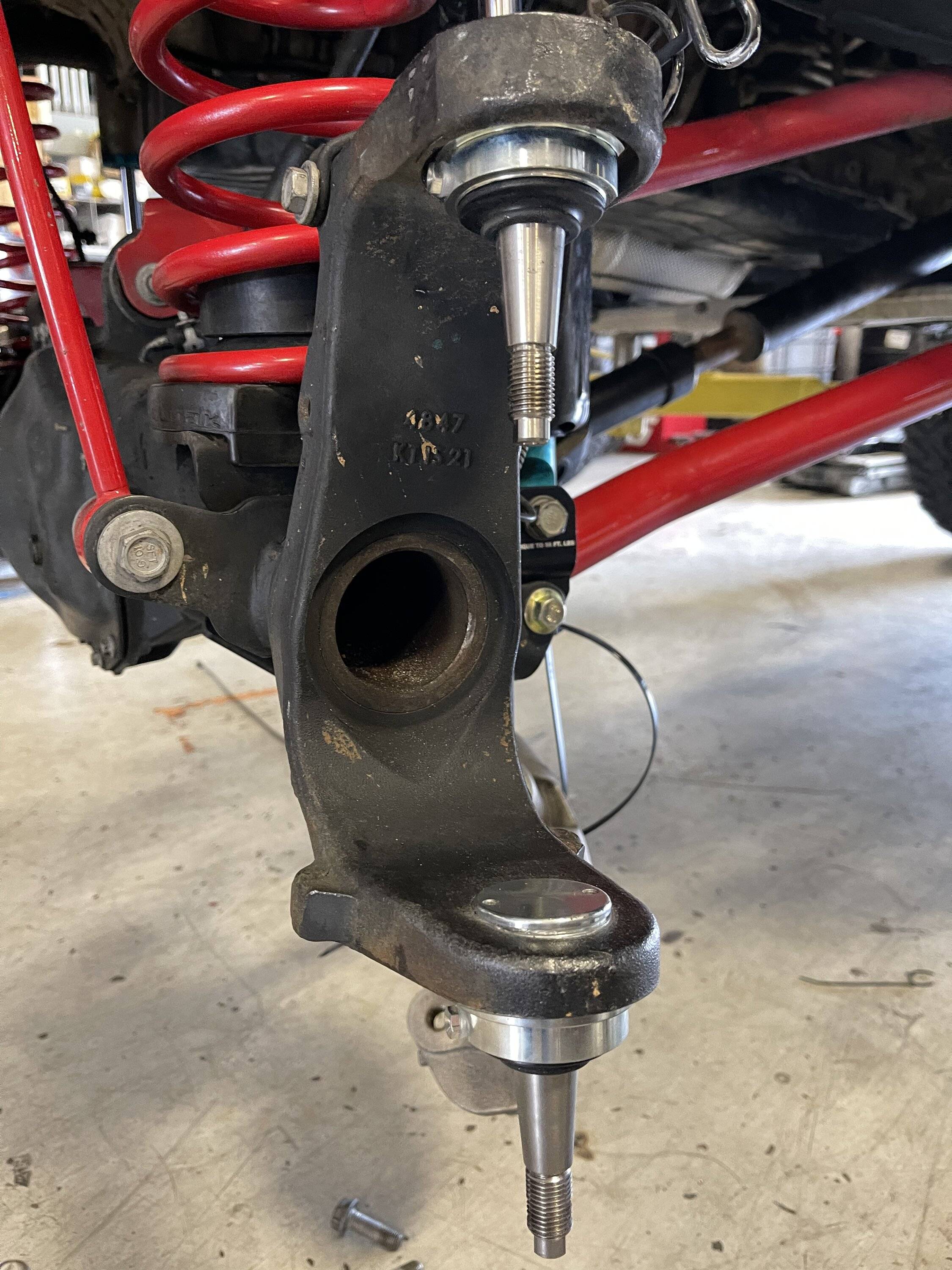

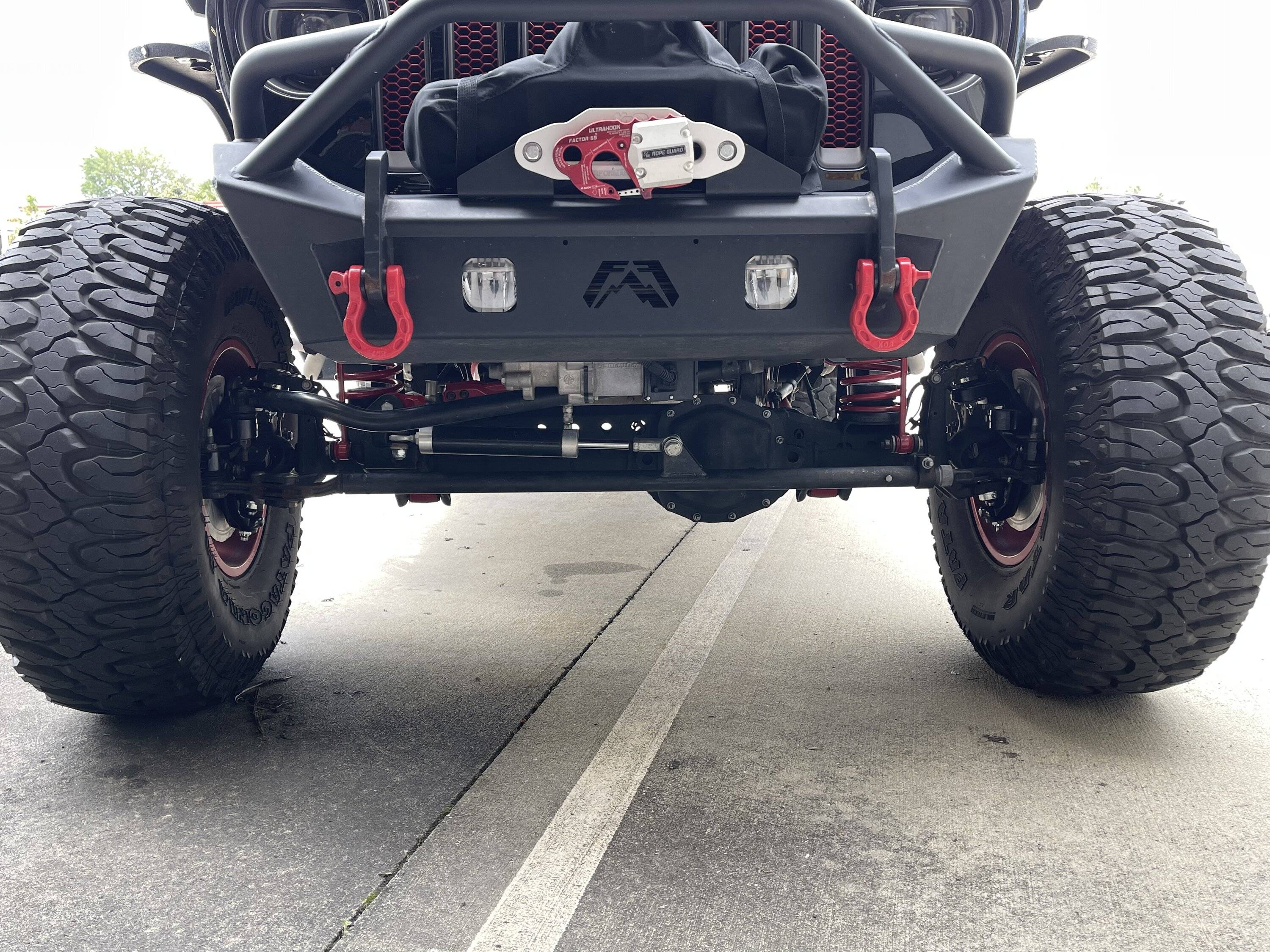

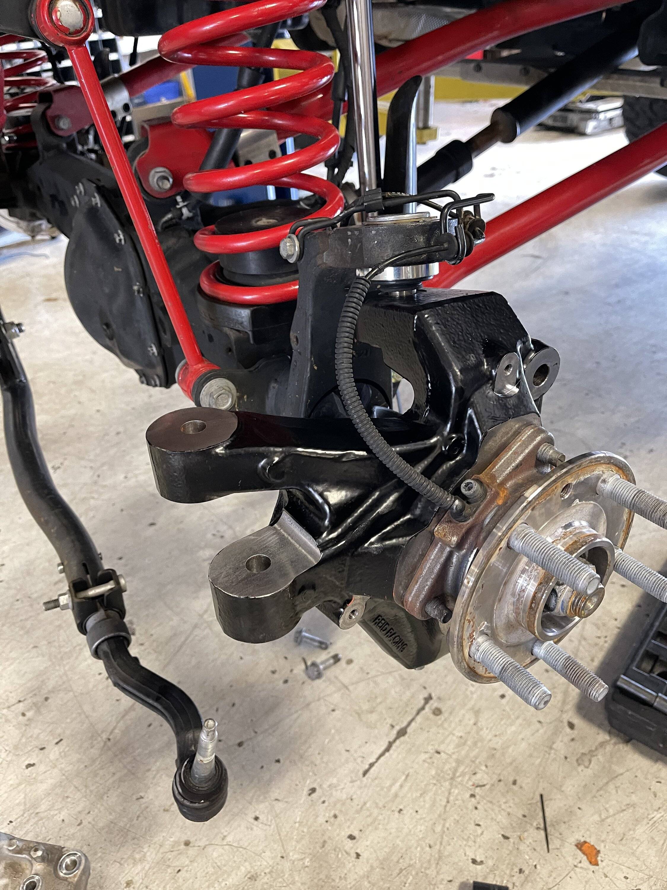

Just want to give a shout out for these! I am running 17 x 40” Pats and knew I need to upgrade the front end. The Jeep drove fine for having 40” balloons so I didn’t suspect the ball joints were a problem as they passed our inspections. I wanted to install the Reid knuckles and knew it was the best time to replace the ball joints. We just drove our Sunday ritual drive 30 miles down I-4 to Universal City Walk and I’m blown away at how tight the steering is and I didn’t even realize I had bump steer until today when I drove one handed 75-85! I can’t praise these enough! If you are on the fence, get off of it and install some Dynatracs!

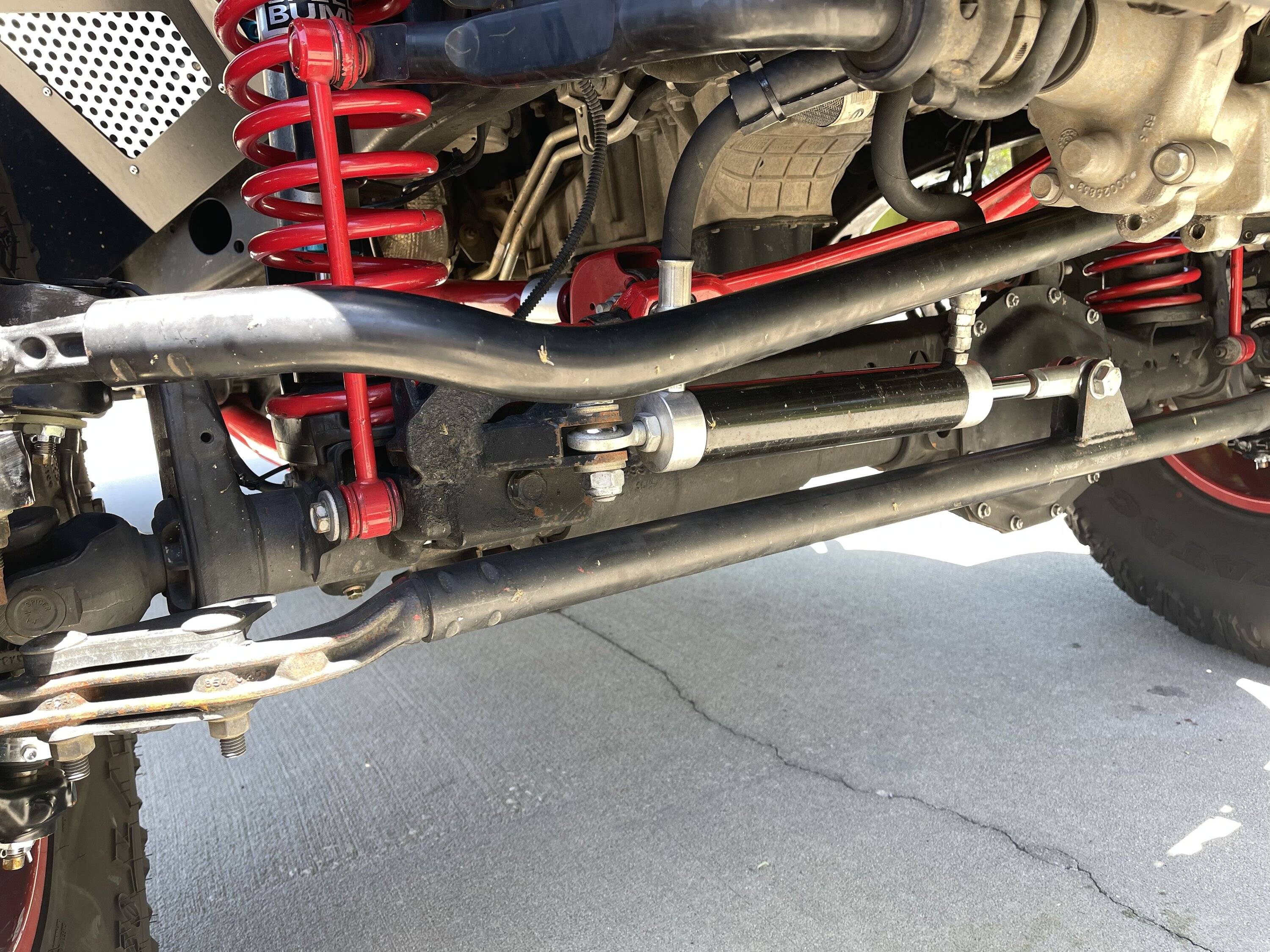

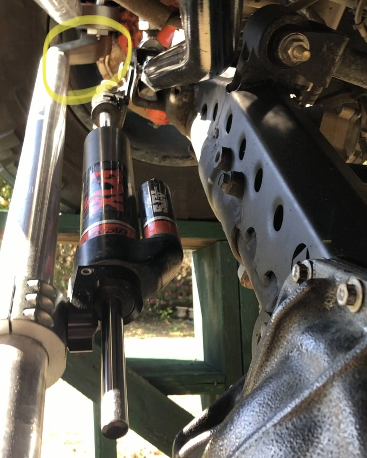

Do you think I will have any clearance issues with my assist ram due to the size of the RPM linkage? It looks like the drag link is straight where my face one has a curve and misses the ram. It sure looks like it’s going to be close!

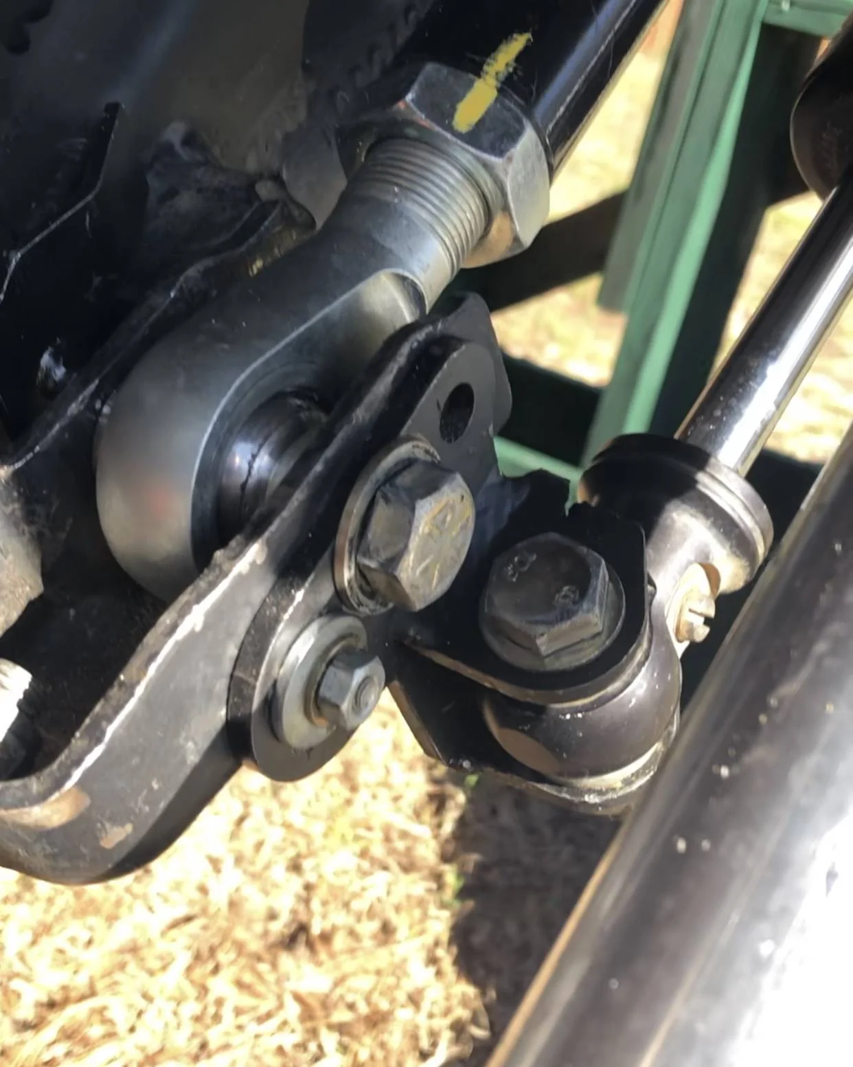

It depends on how much of a bend is in the ends…all aluminum bars are straight that I know of for strength, but the ends very in configuration….,. This is where I ran into trouble with my RK linkages.
The end has a very slight bend in it and I had to fabricate a bracket to get my stabilizer to work…. These bars are designed to be used with stabilizer in factory location or a drag link flip……
I didn’t want either one of those options so I turned a MC stabilizer bracket upside down and cut it up to work with my stabilizer. It’s working great, and RK is now working on a new bracket that bolts in the factory location but raised up……

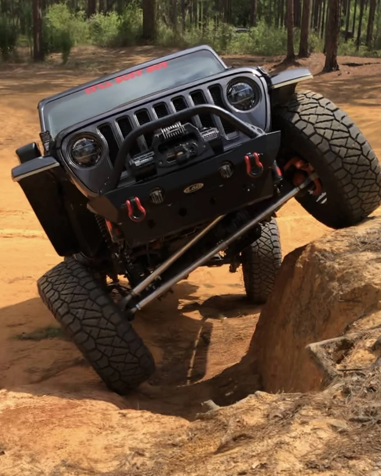

I’m happy with the way mine turned out……you can see how little of a bend in mine, yours will likely have a bigger bend there….

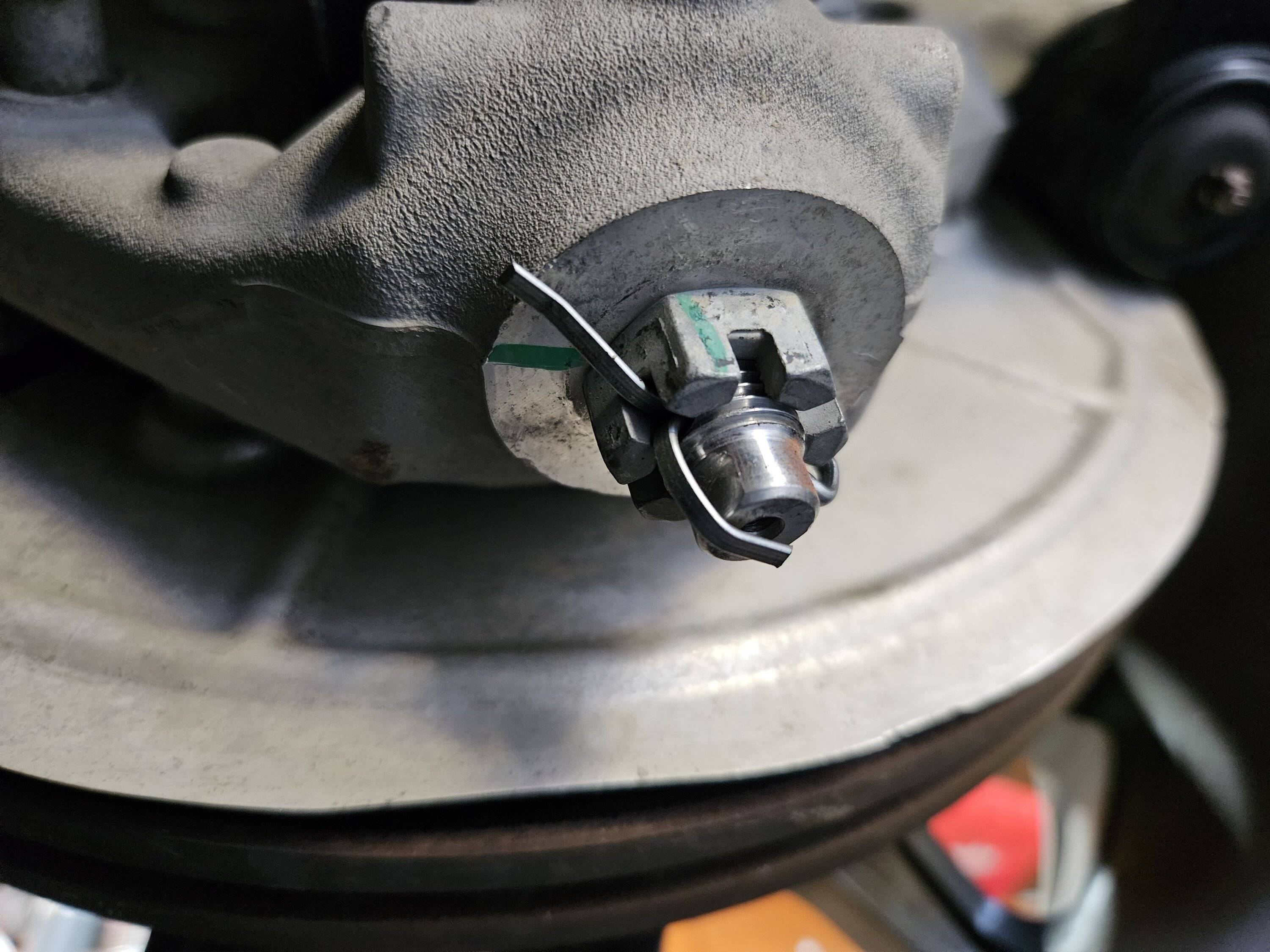

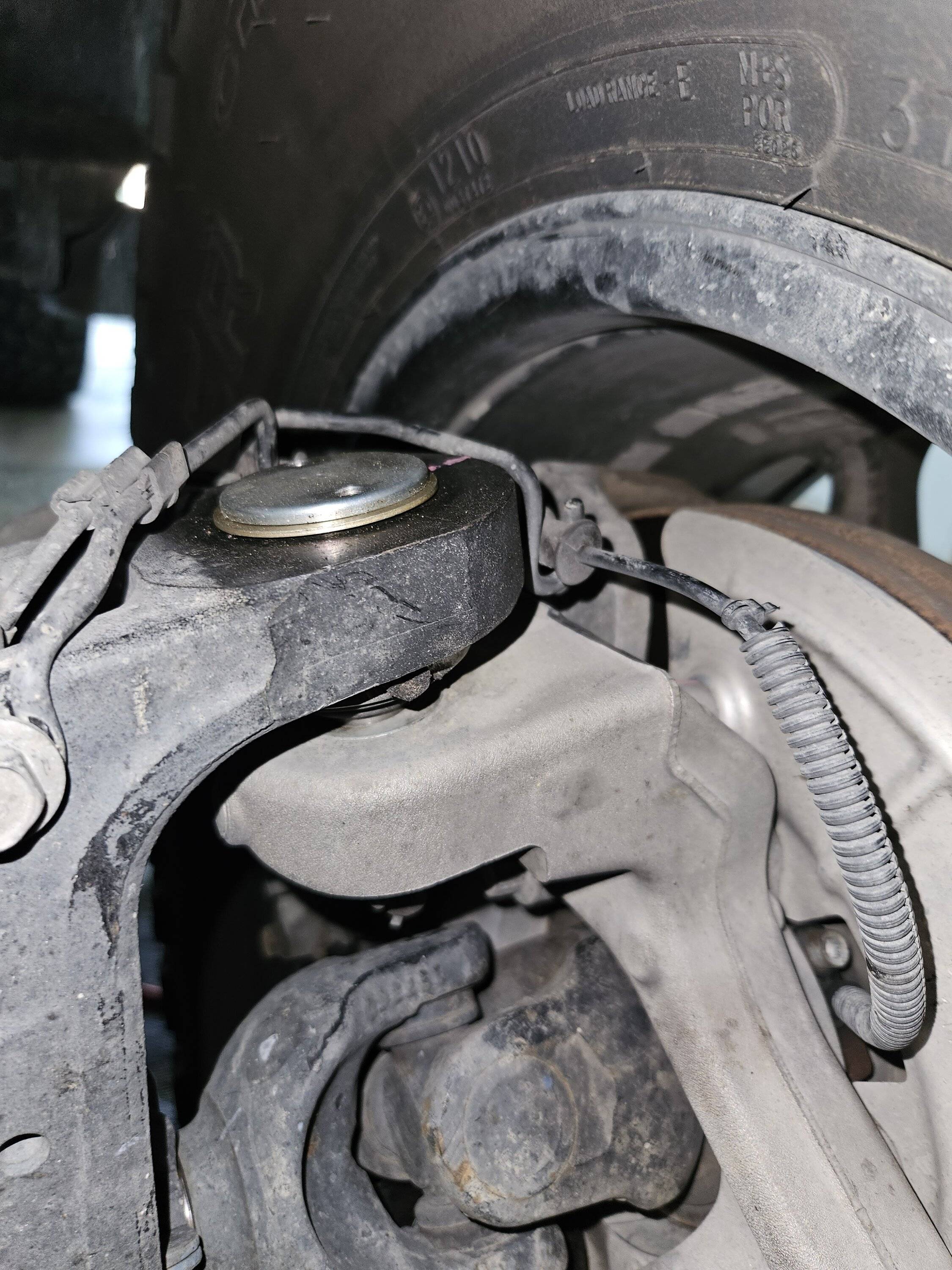

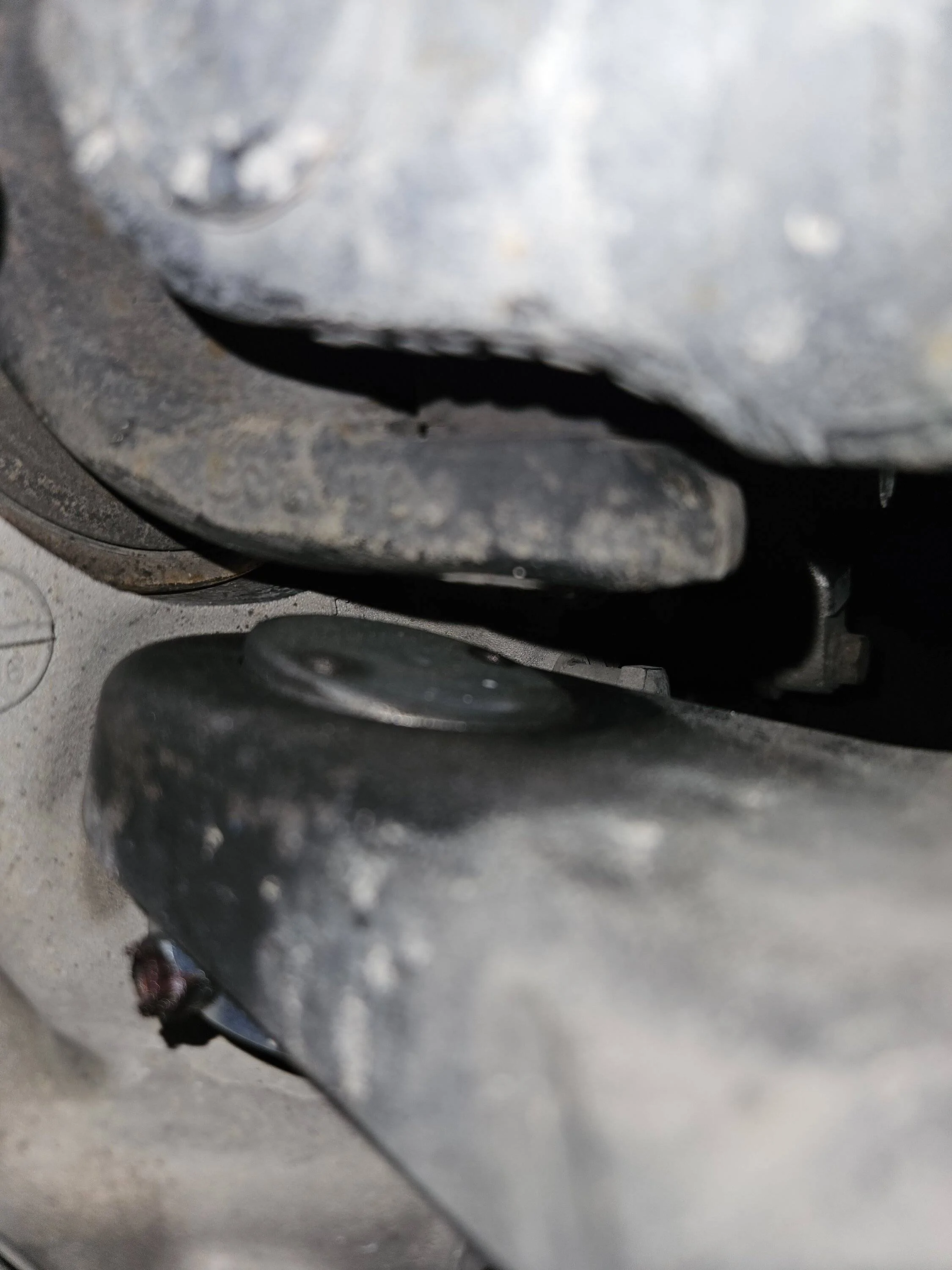

Just wanted to ask to see if this is normal...just got Dynatrac ball joints installed a few weeks ago and noticed this afternoon that the castle nuts have loosened a little bit and it doesn't look like the ball joints are seated all the way. I don't have any experience with ball joints so I just want to know if this is normal or not. See pics.

Just wanted to follow up with a few more pics. After thinking about the obvious...I'm sure the bolt didn't back off because of the pin but please take a look at the pics and tell me if these look to be installed correctly. Any help is much appreciated!

They are not seated deep enough in the knuckle. Granted I have Mojave steel knuckles, but the black rubber boot on mine is touching the knuckle and no part of the ball joint spindle is showing.

Thanks for the reply. I guess I'll call the shop that did the install and ask them about it ?
