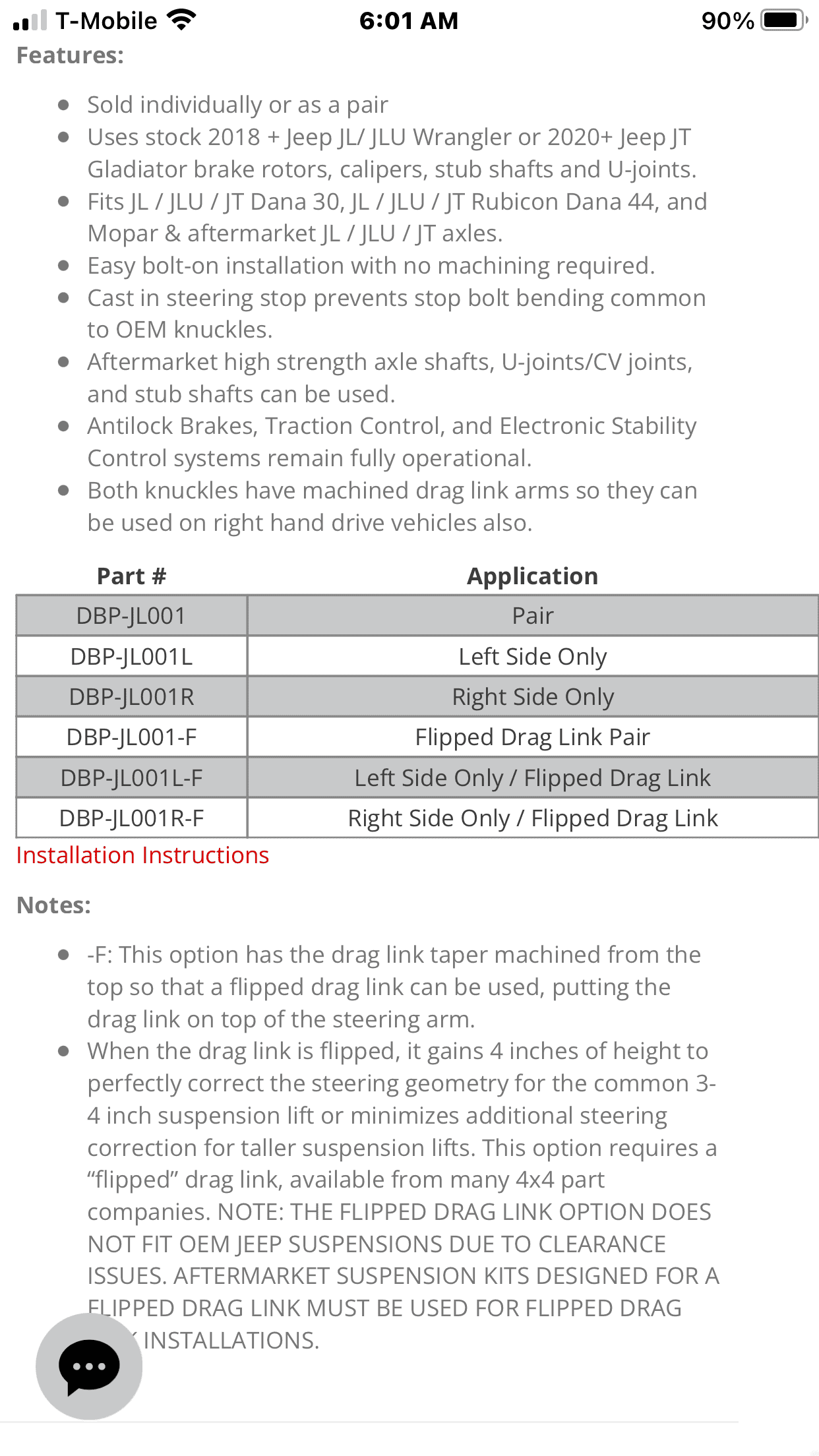

Not sure brother……it might be the retailer’s code, it seems to be different depending on who you get it from….. here’s my source…….Poly Performance
Maybe that is a vendor addendum? I purchased directly from Reid. For my case with no flip, they spec #JL001-R/L.
