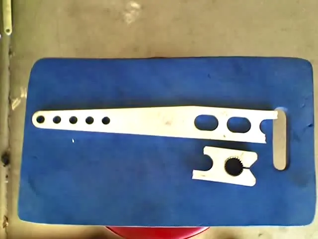

As a HARD CORE Rock man I did the Currie Anti Rock in front first and then kept an eye on the rear...time went by and never saw a reason to disconnect or replace the rear swaybar.
I would do the front, in fact I boght the first Currie anti rock at the Off Road Expo in Pomoma Ca.
This is what happened to it on the very first outing at Moab. I sent them a pic and they rapidly changed the design.
