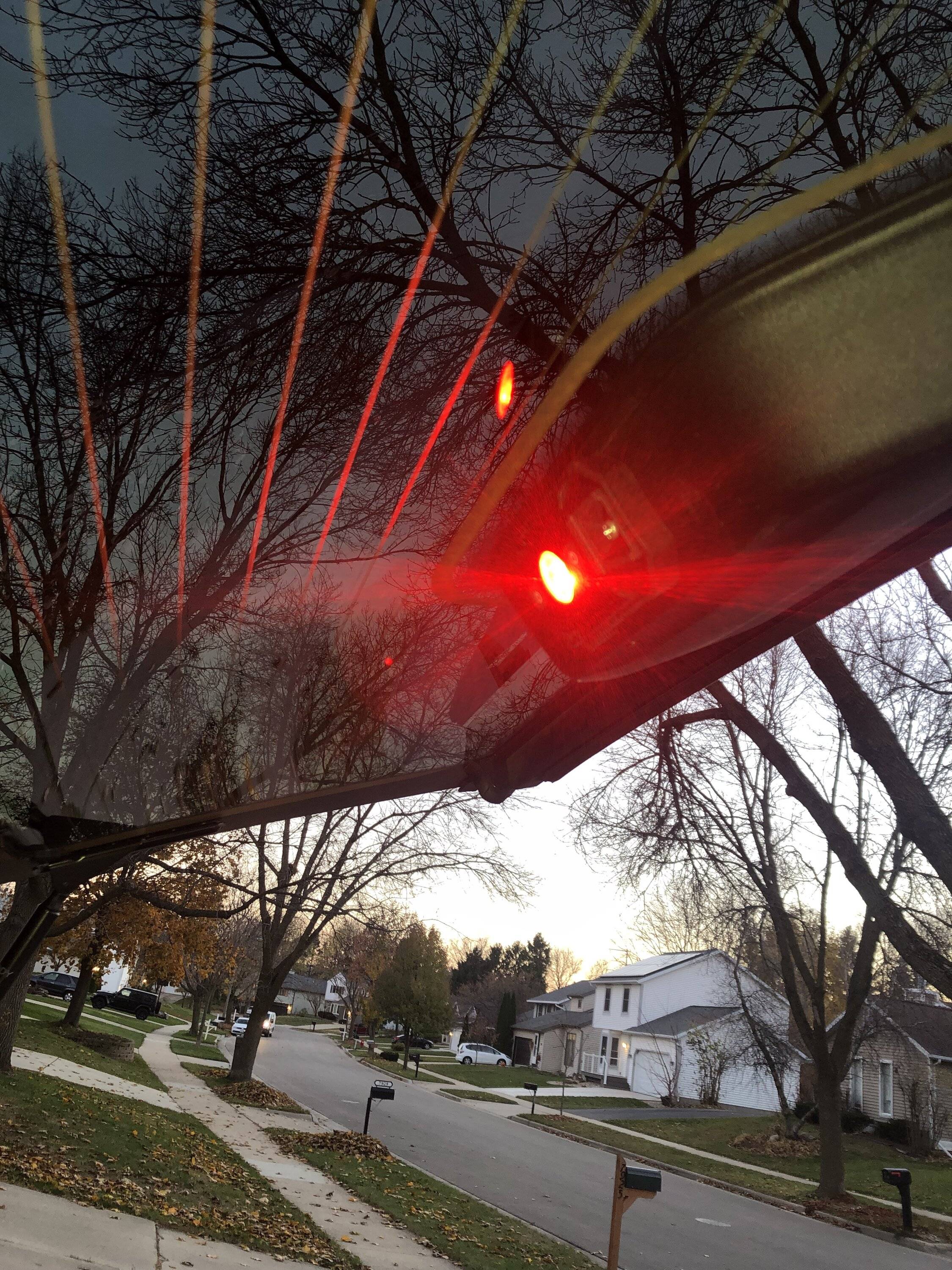

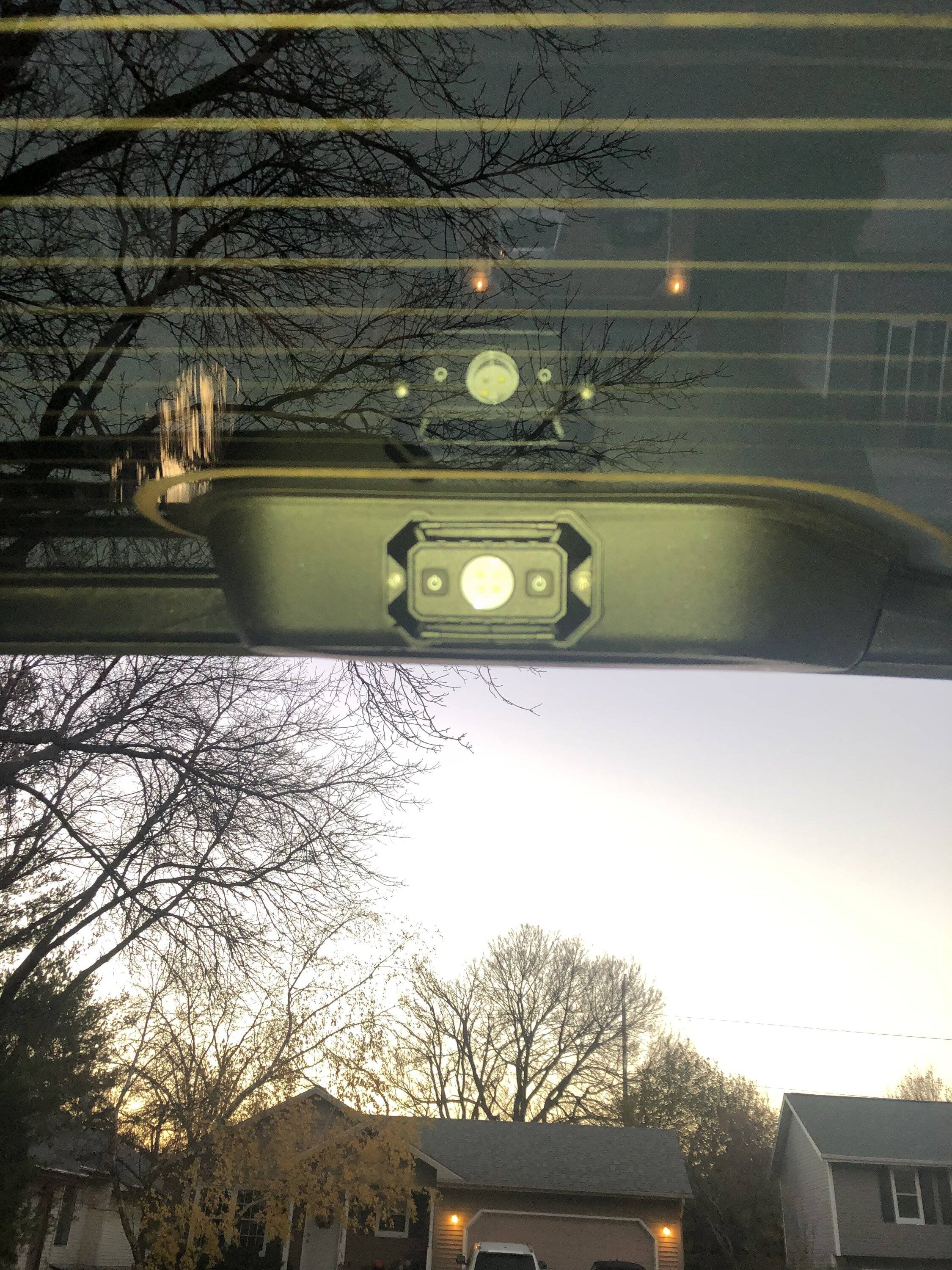

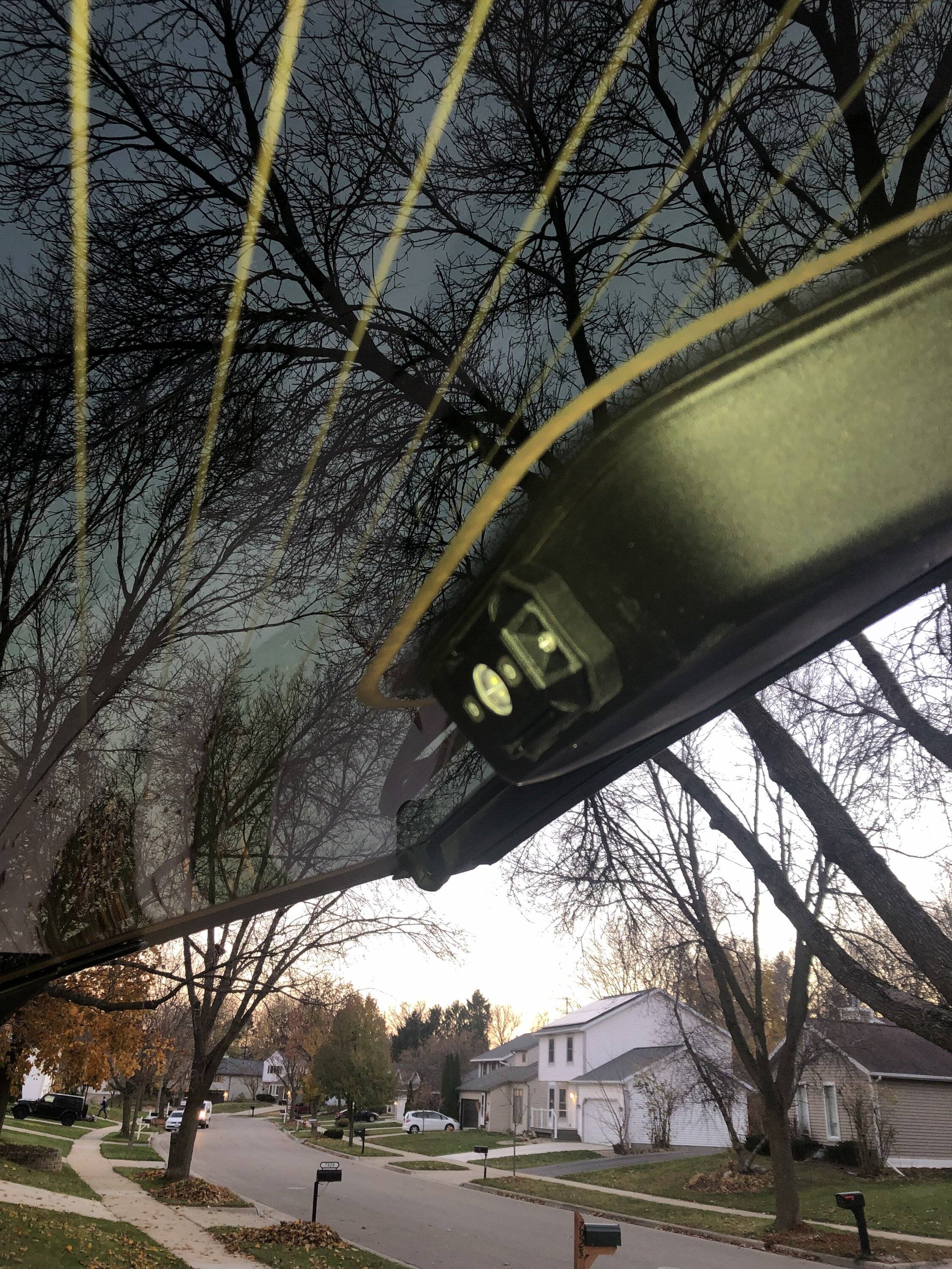

So I got tired of having very minimal light in the cargo area of my JLU Willys and added this UTV dome light to the rear glass. Mounted it to the wiper cover and ran a 12v wire to the 12v power outlet in the rear. Very clean mod. Something Jeep should definitely do in the future! Plus the dome light has a red and white light option.
this is absolutely awesome , nice compact design, and has on/off switch built in! Thank you !

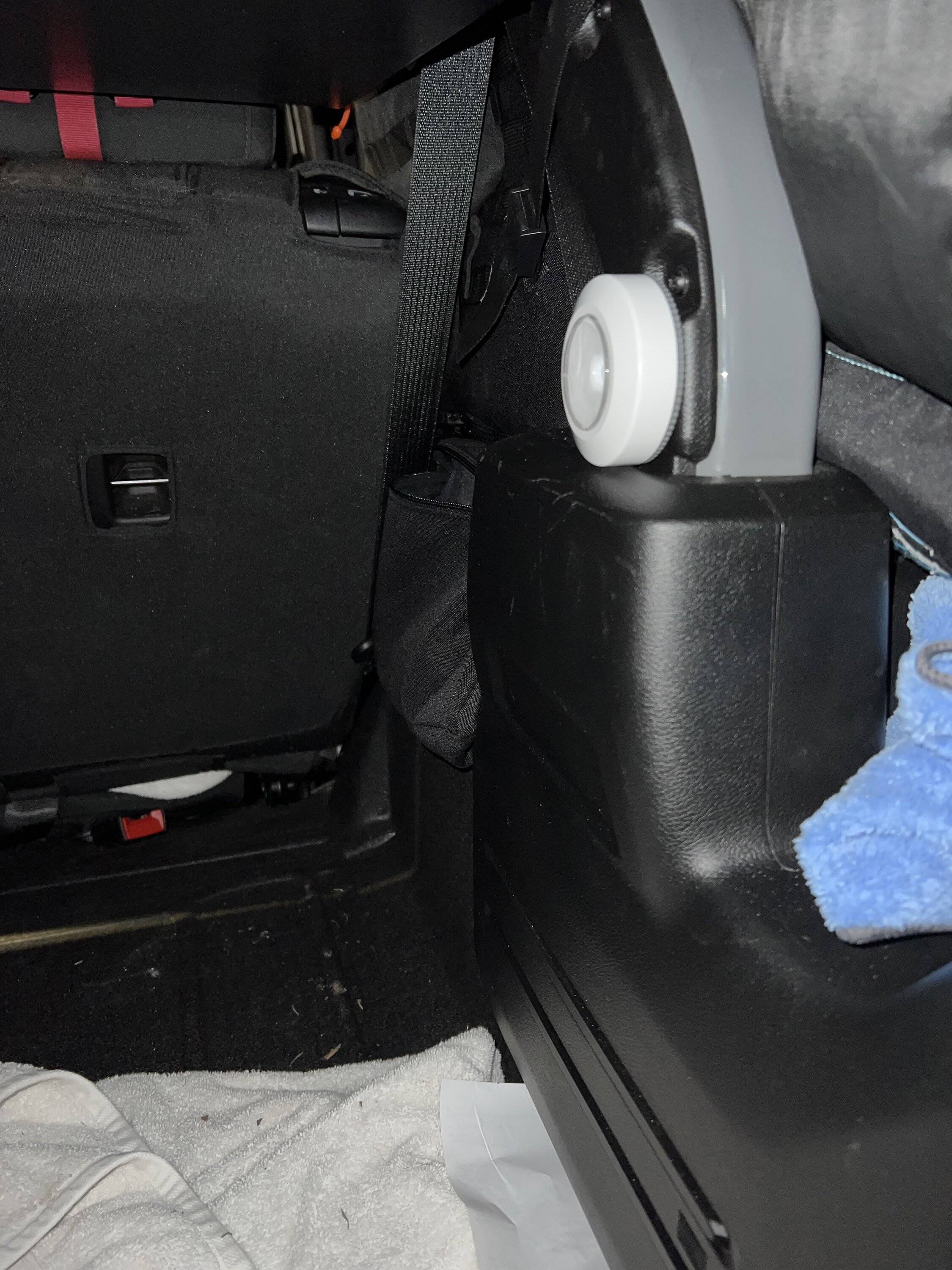

This works well, also, and sticks anywhere. ?

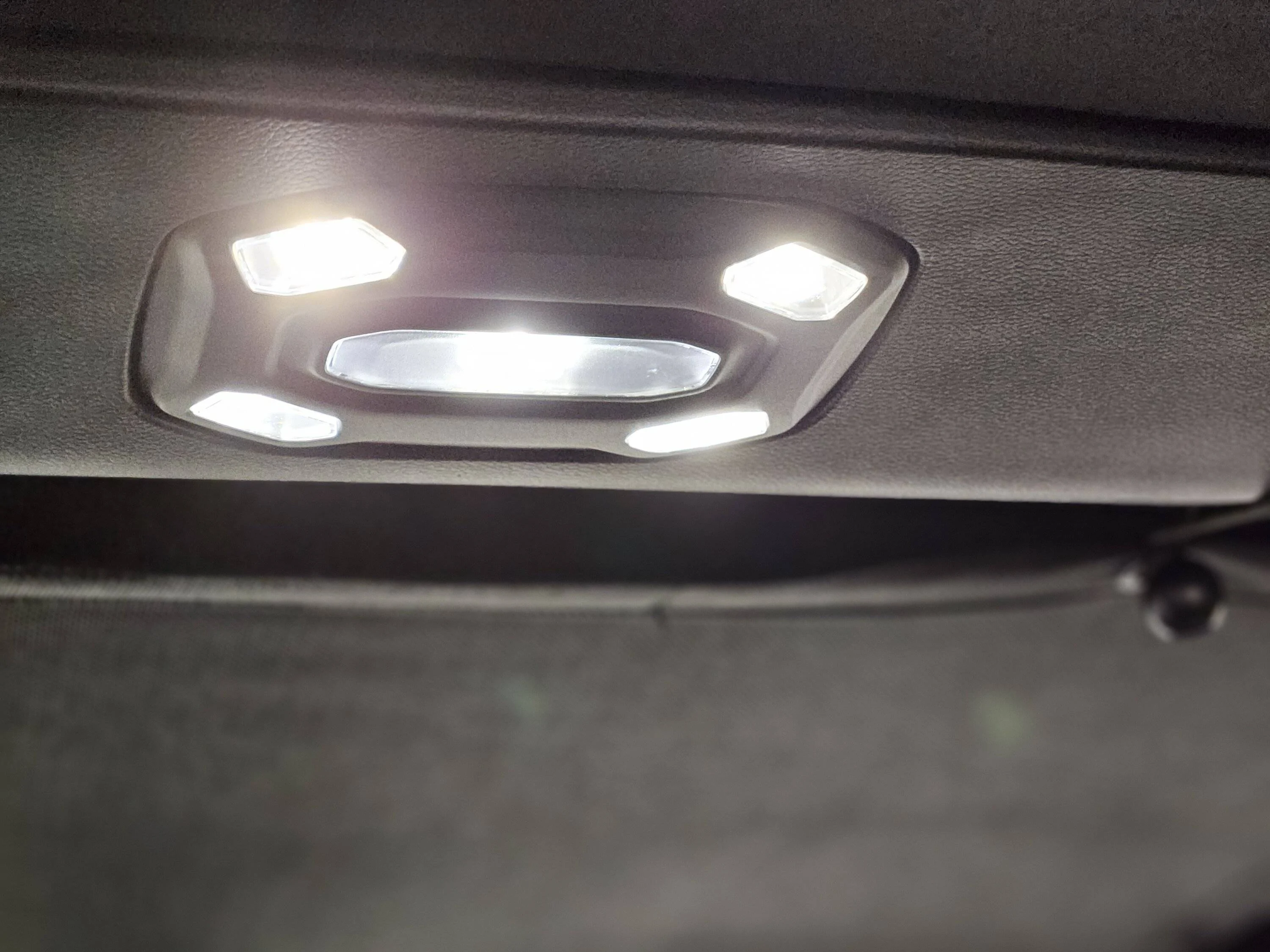

In the 2018 JL's and into the model year 2019, the interior dome light is not bright enough / is very bad in regard to white light output.
Fortunately, the chitty dome light on your 2018 JL, can be easily replaced and the difference in the interior light up when the dome is lighted, is outstanding.
Read here:
https://www.jlwranglerforums.com/forum/threads/cheap-jeep-hacks-show-em-off-here.18785/post-2523234
All K ratings of the LEDs appear identical - Center oval, LED is ~6K (WHITE) and so are the 4 side Led's on the revision.

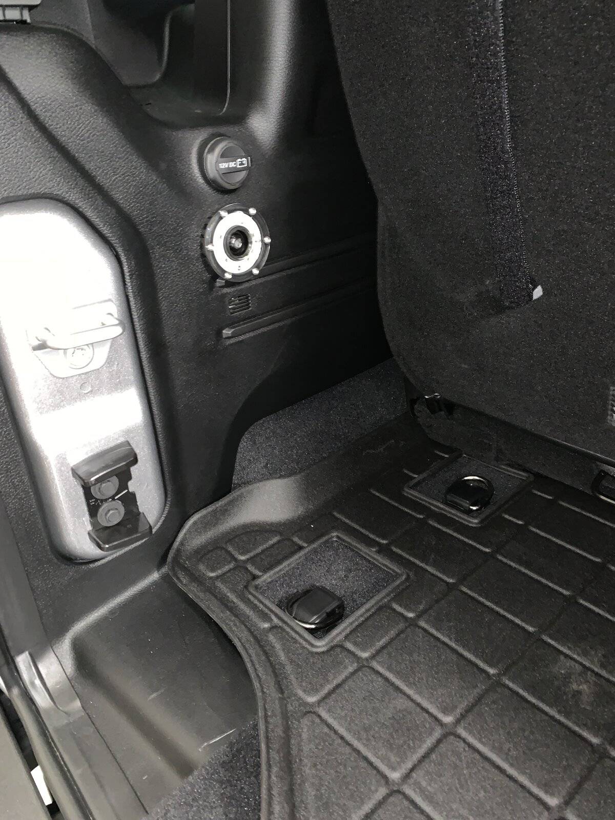

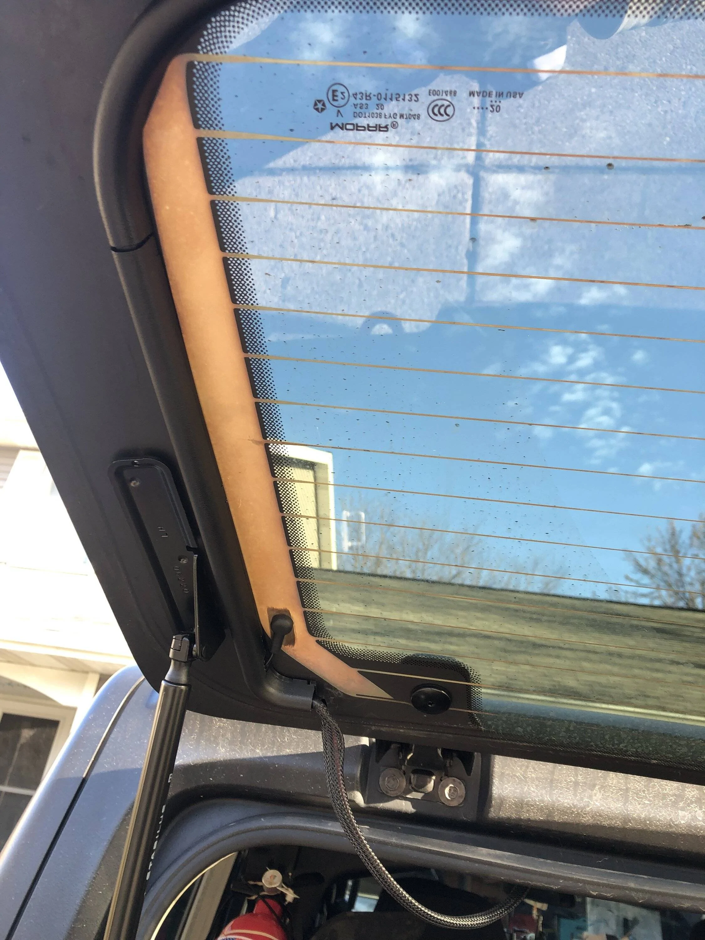

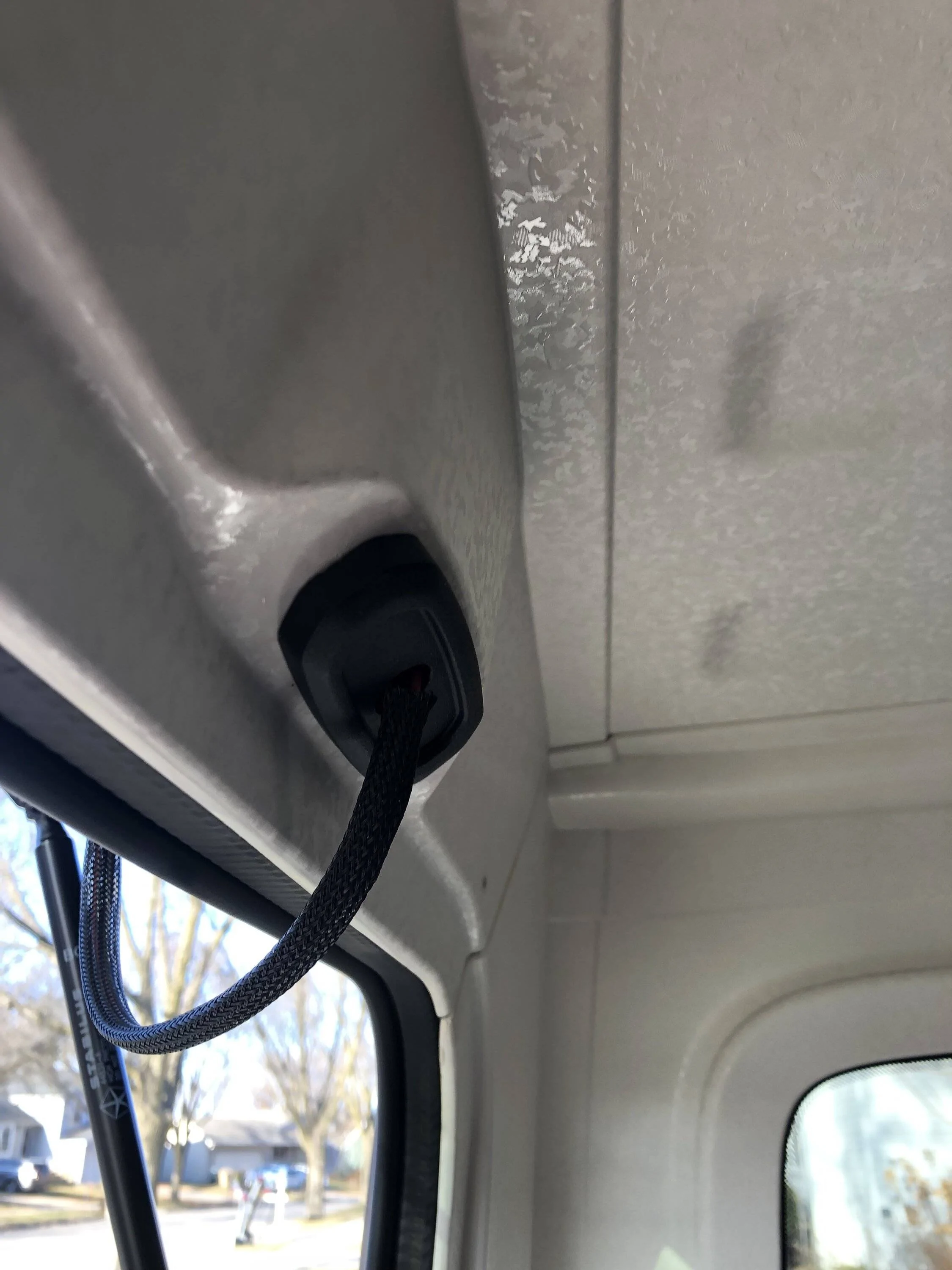

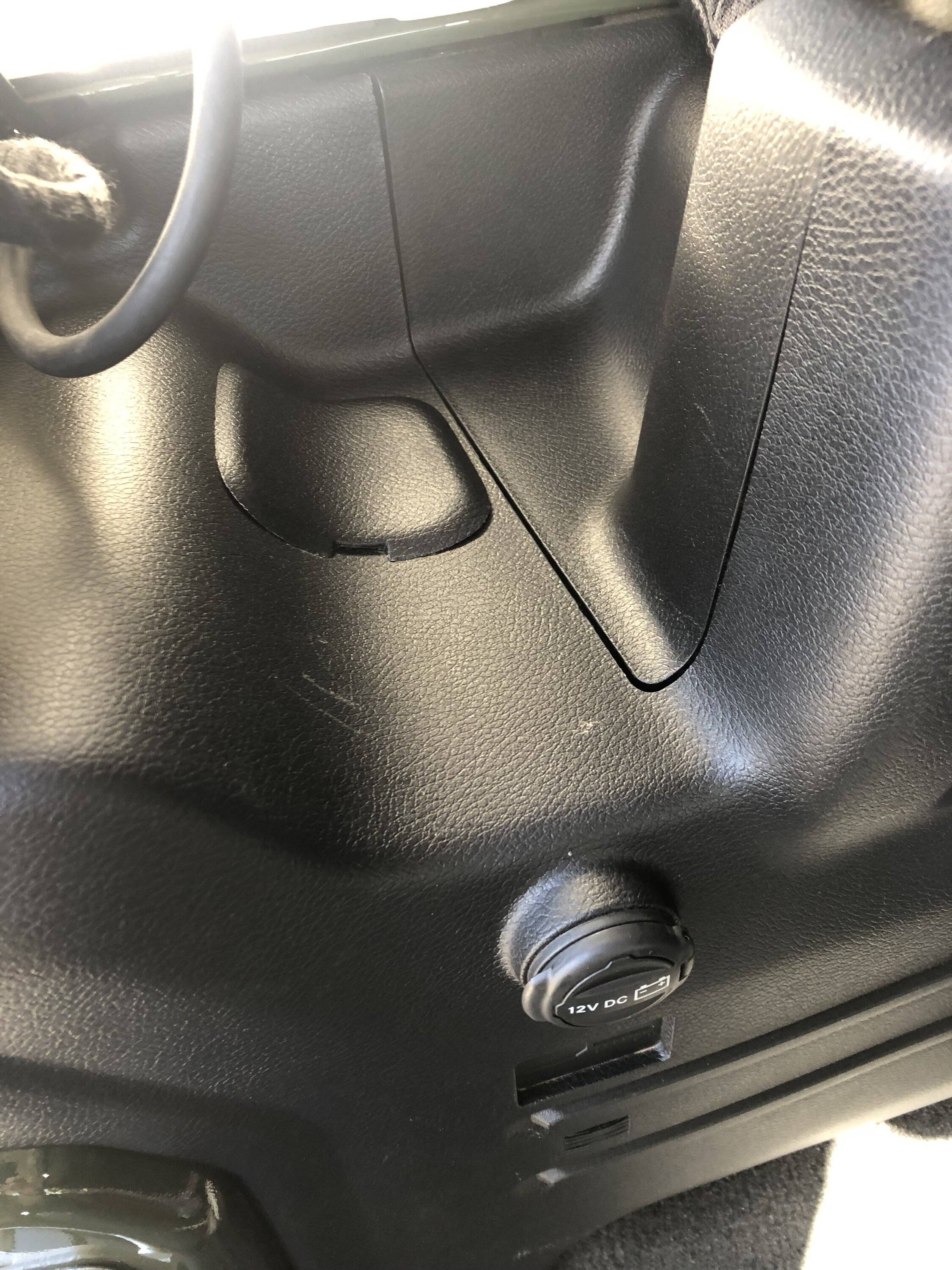

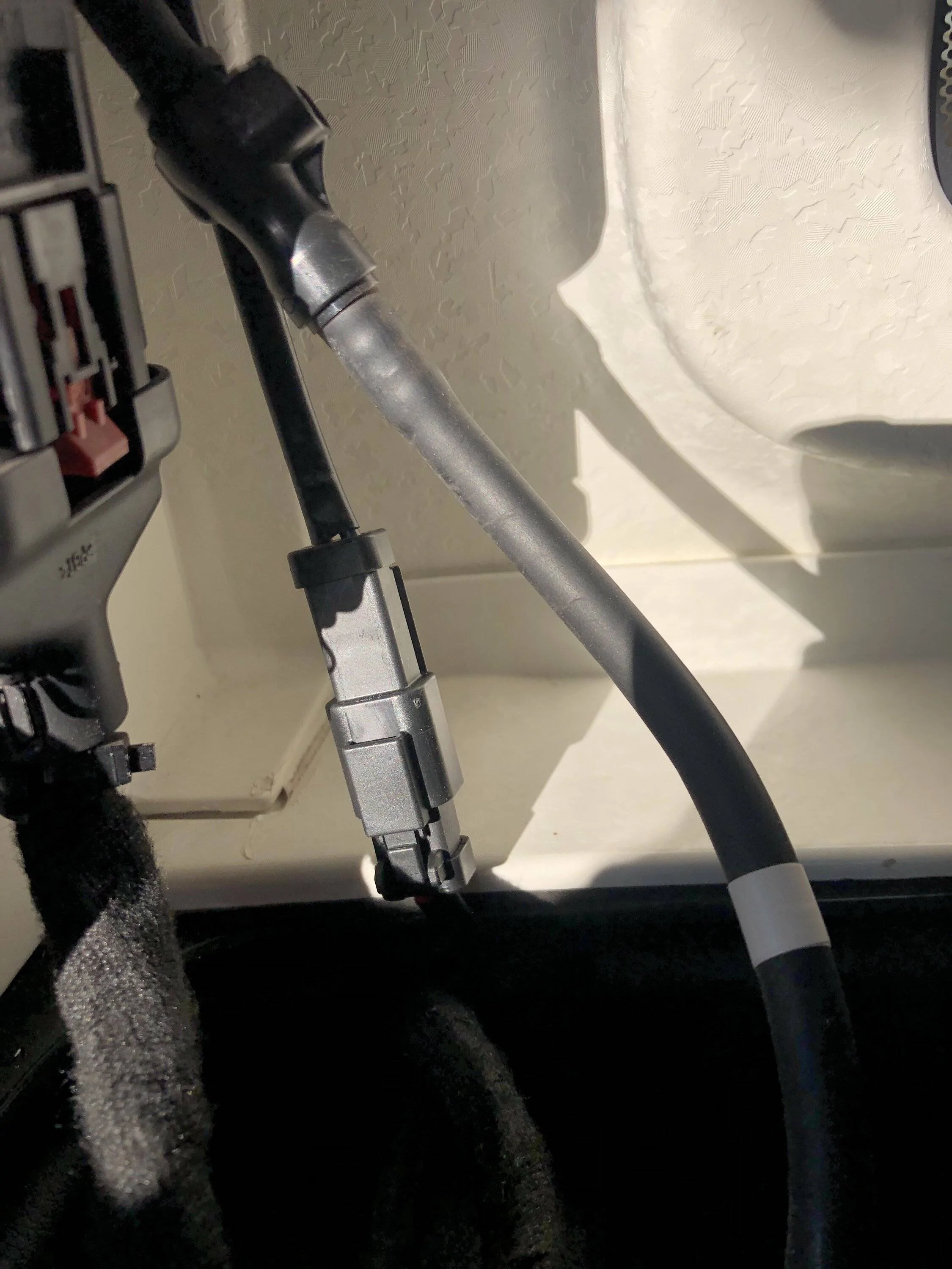

How did you hide the wires? How do you access the outlet back there? Thanks
JLUW83
JLUW83
Jan 22, 2023
Wisconsin
Jeep Wrangler Willys

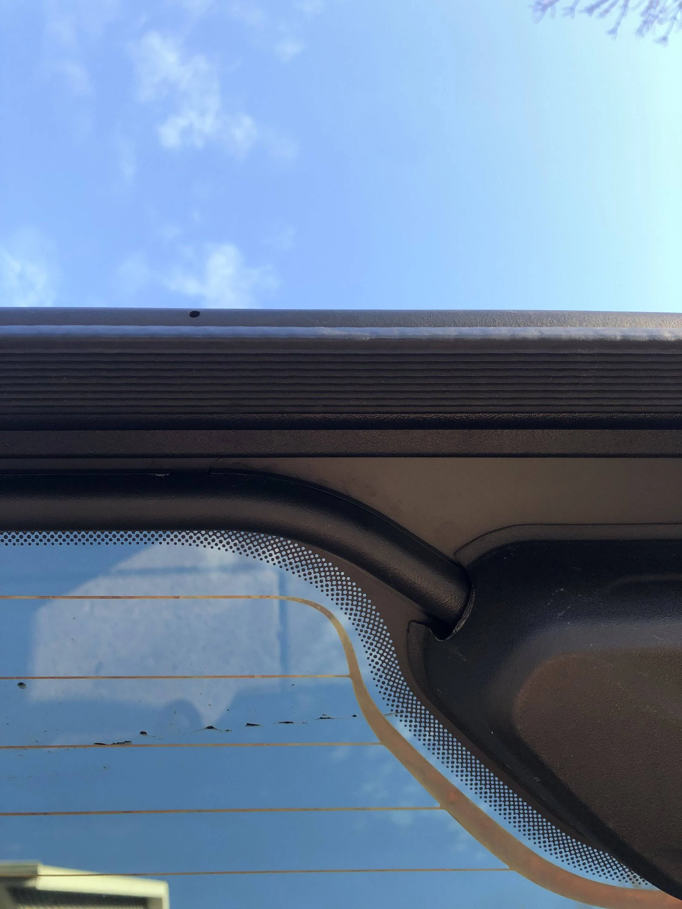

There is a wire channel that runs from the wiper housing to the topside of lift glass then the wires run through a wire loom into the hard top. Run your 12v wire through that route to where your wire connectors are inside the jeep. I used a deutsch connector to somewhat match the factory connectors. Then ran the 12v wire to the 12v outlet and spliced it into the power wire. Back to the wiper motor housing, I grounded the dome light to a metal plate on the wiper motor. Here are some pictures.
Jeep Wrangler JL Rear Cargo Dome Light 62F25F99-8729-4C67-BDB2-46D24366CB69

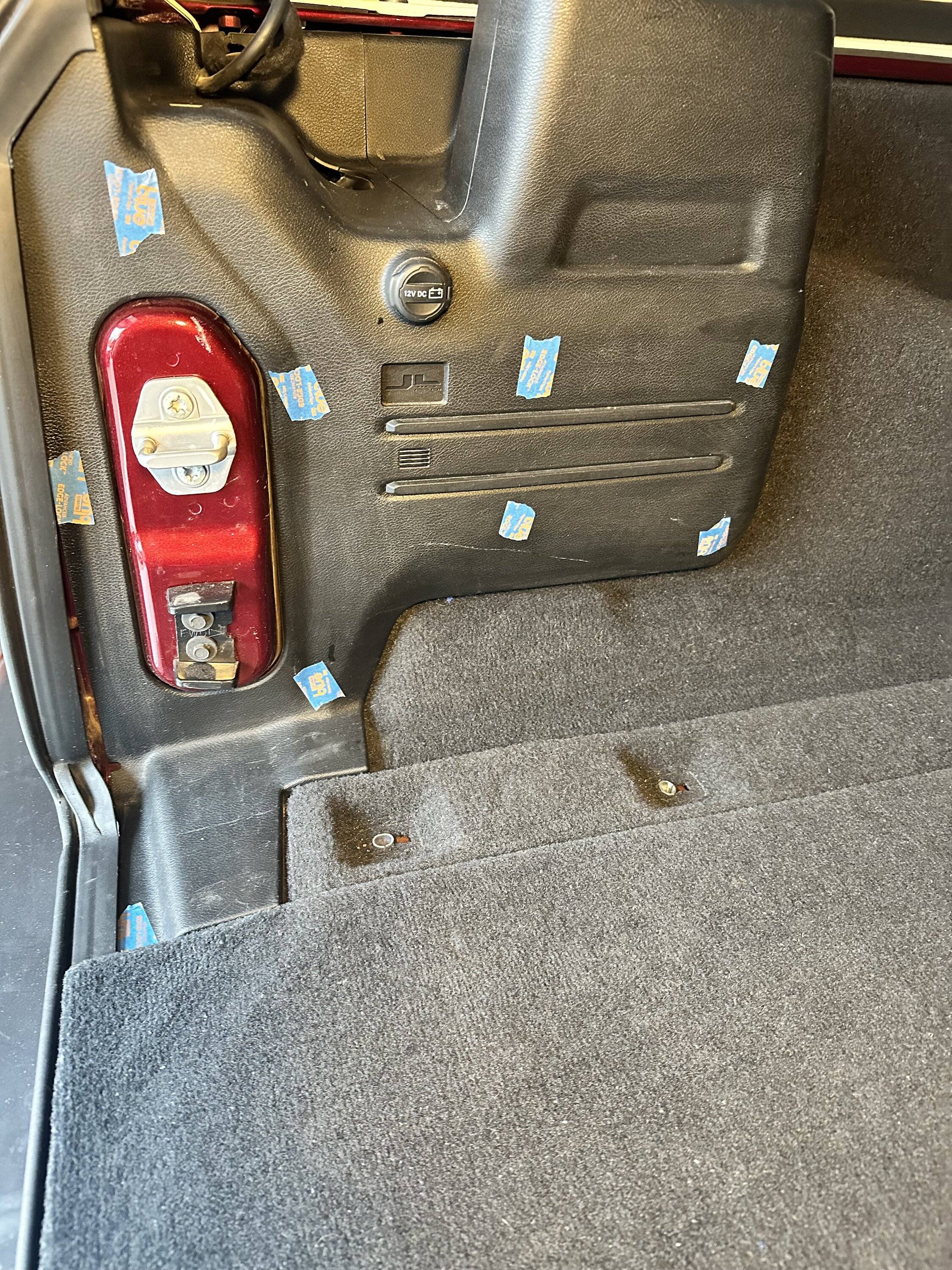

If anyone is interested this is where the clips are to remove the cover.
