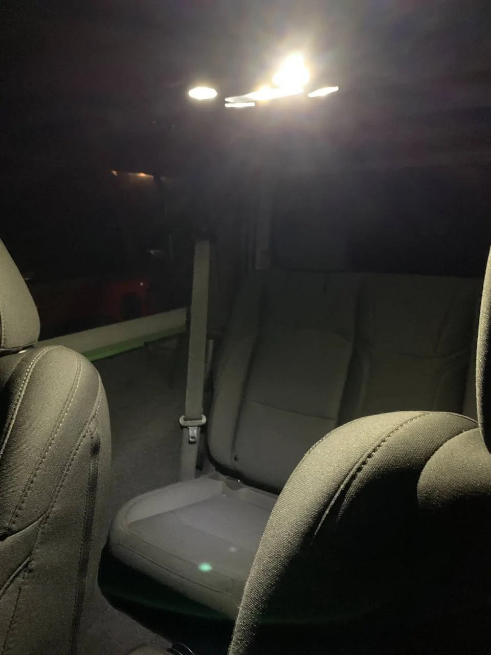

Thanks again @Rhinebeck01 for the part number! I checked with a local salvage yard this morning that does a lot of JLs and picked up a dome light today along with a hitch for my son’s JLUR.
Jeep Wrangler JL Odd Dome/Map Light Question... IMG_6701
Jeep Wrangler JL Odd Dome/Map Light Question... IMG_6702
Wow, what a difference at night!!

Good to hear! I know a local guy that has a salvage yard and he is pulling a replacement dome off of a wrecked 2023 and I will acquire it for my 2018. For the $30 bucks it is worth it. I do a lot of night time traveling and I have been meaning to put the newer dome in my JL. Your post motivated me to finally do so...
For those with a 2018 that want to move to a newer dome light, do know that there iss now a newer part# for the dome which I just became aware of.
So, 2018 JL owner, you would want a replacement dome light with part # 6CD43TX7AG or 6CD43TX7AH.
