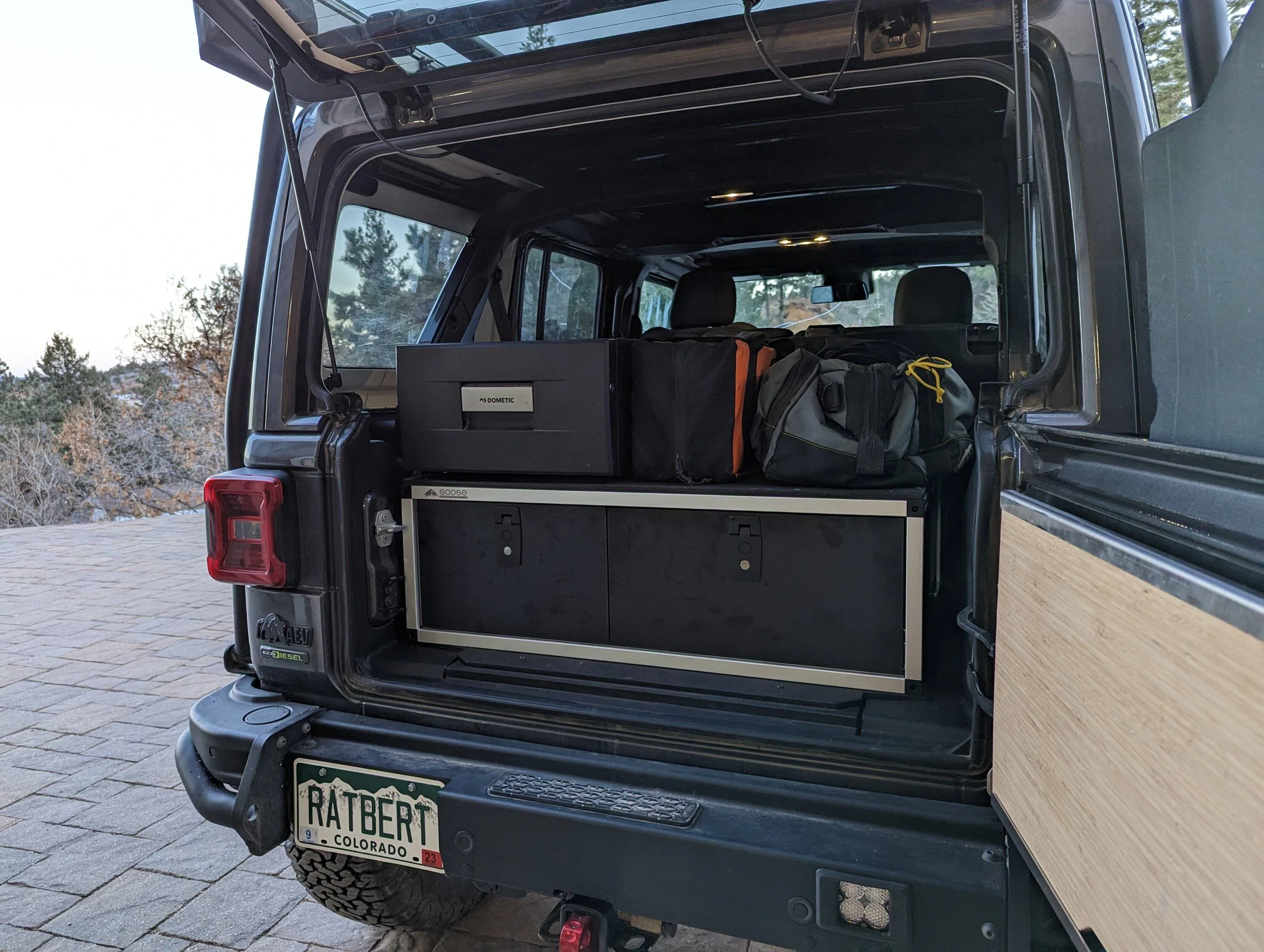

I recently updated my AEV 2.5" springs to the stiffer 3" HD version to deal with the extra weight that I've added to it beyond a stock JL370 (aluminum skids, sliders, roof rack, 270 awning, etc.). Those springs bumped up the height be about an inch.
I'd been putting off installing our Goose Gear drawers until the suspension could deal with their weight. It was finally nice enough out to get that done. Most of the time was spent mounting the Dometic fridge on it.
And yes, the height of the 3" springs is fairy obvious. And living on a dirt road means that your Jeep will always look as intended. It looked like that after driving home from the car wash.
