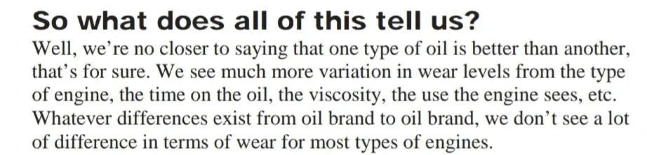

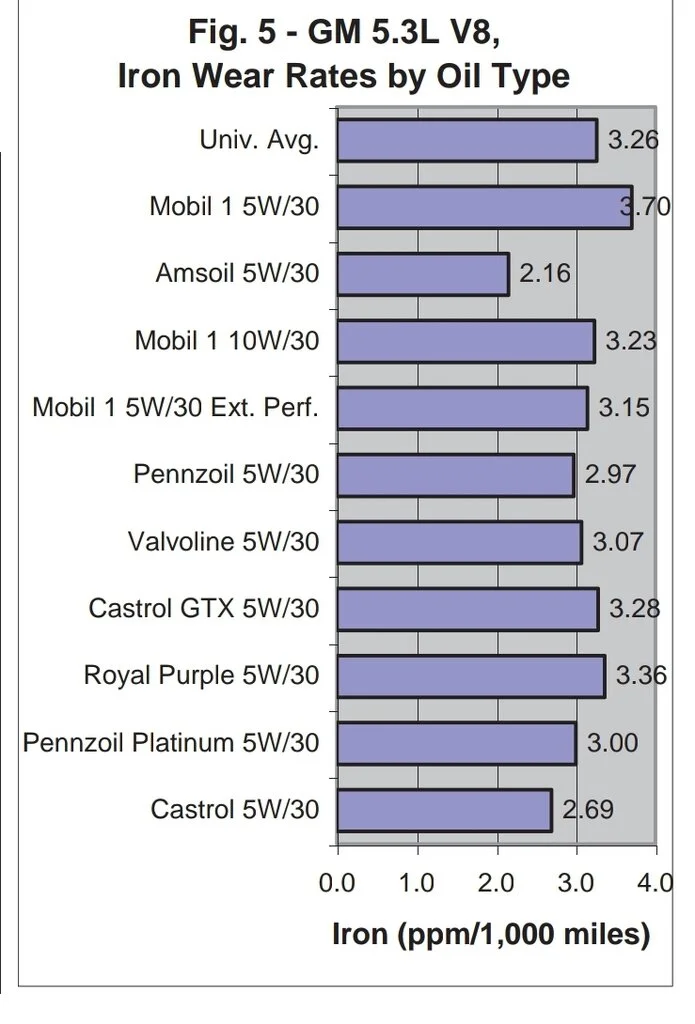

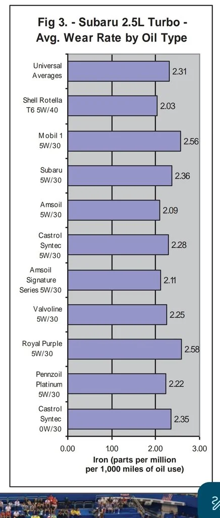

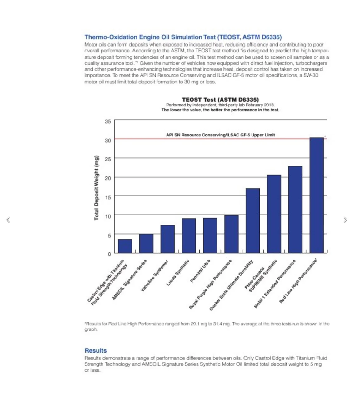

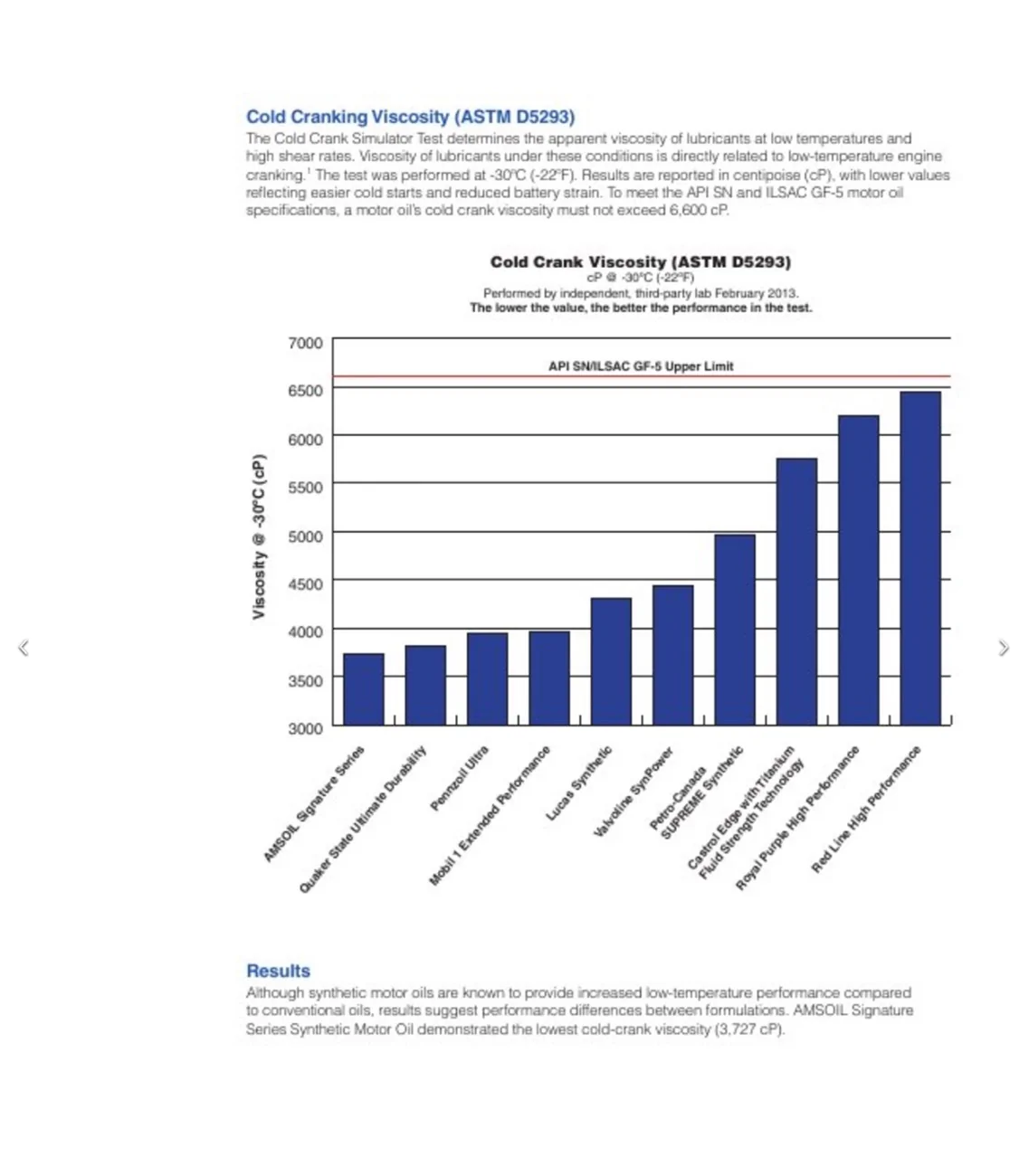

Blackstone did a comparison of 1,000’s of UOA’s in there data base on two different engines. This is their take.

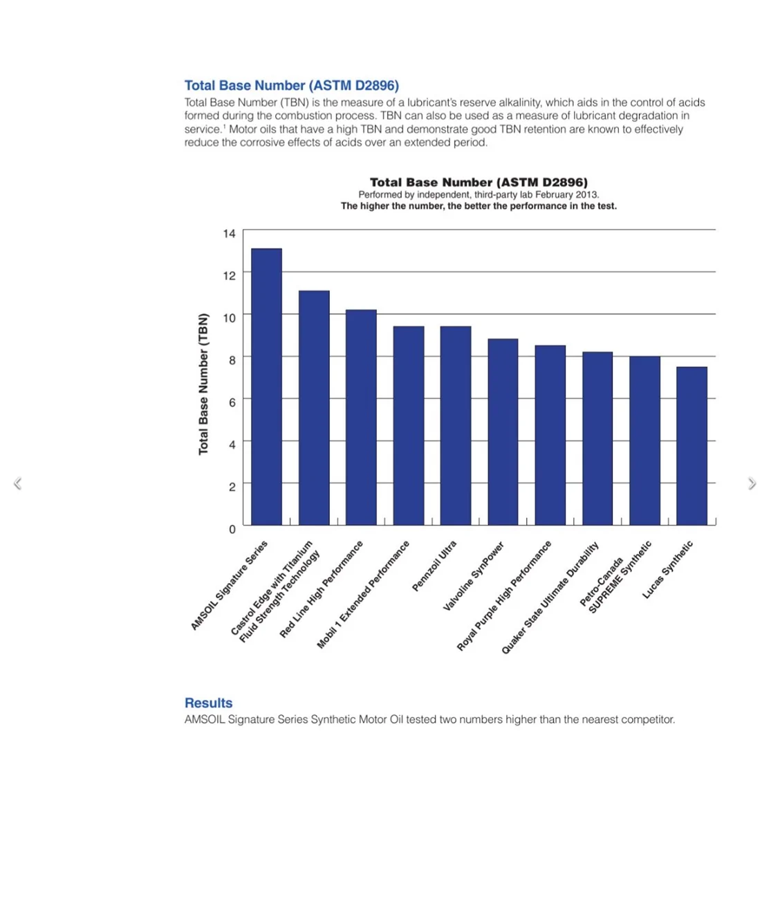

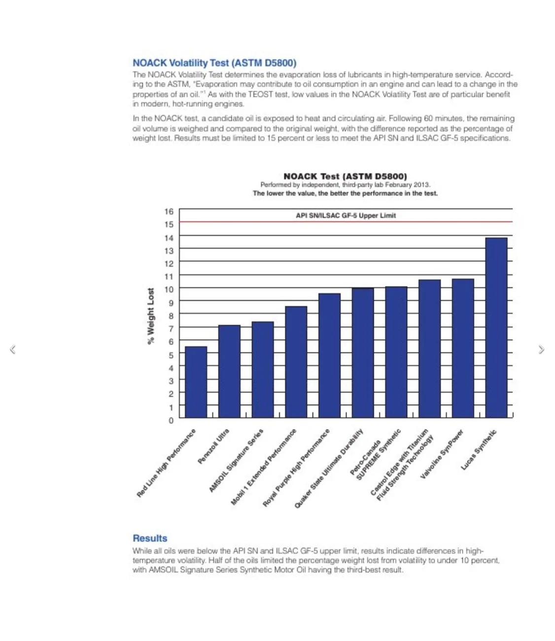

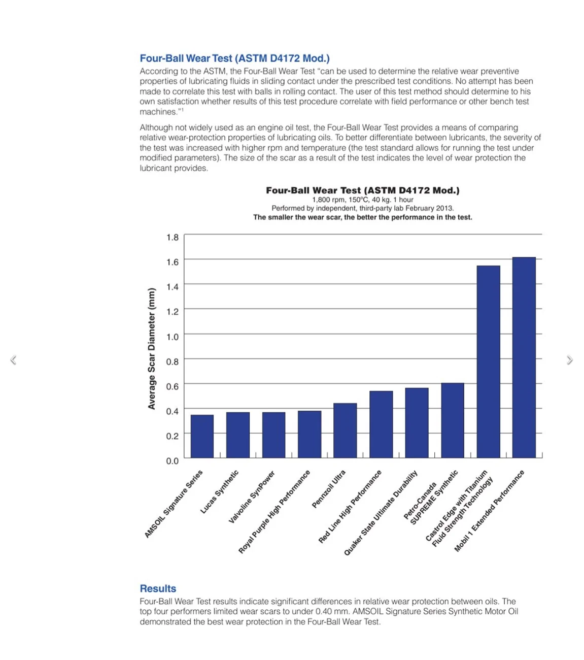

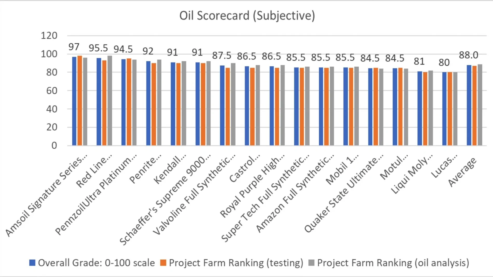

Now, Project Farm's tests are sounding credible to me, in his test PUP beat the crap out of Red Line that had boatloads of additives. PUP's less is more technique is amazing 😎
I checked out these Project Farm tests you mentioned. Interesting garage tests. Here are the final results for what they are worth.
In that test, PUP beat everybody on NOACK, great NOACK means no varnish left, my engine must be sparking clean 🤩👍

You can’t rank oil based a few ppm difference in wear metals. Every UOA company will tell you there’s no difference between brands. Viscosity, engine type, and engine use have more effect on wear metals than the brand. No official wear study uses UOA’s.
A UOA doesn’t show engine deposits which are more likely to kill an engine than it wearing out.

So I should run 5w40 if I own a subaru ? :LOL:
Good example of a low quality oil performing well in wear metals because it’s a grade higher than the rest. Unfortunately there is a following of Brotella in the Subaru crowd….
This is ok, Oil is kind of a personal preference. Let say the data englobe all sort of drivers and driving conditions. That may or may not reflect my driving habit or condition and maybe the best oil in the list is actually a really poor choice for my specific condition but maybe provide exceptional protection in other condition resulting it in being the best.
What I try to illustrate is the aggregate data is nice but still validate it in your setup and not blindly run what have the best rating. If you are in that sort of thing that is.
