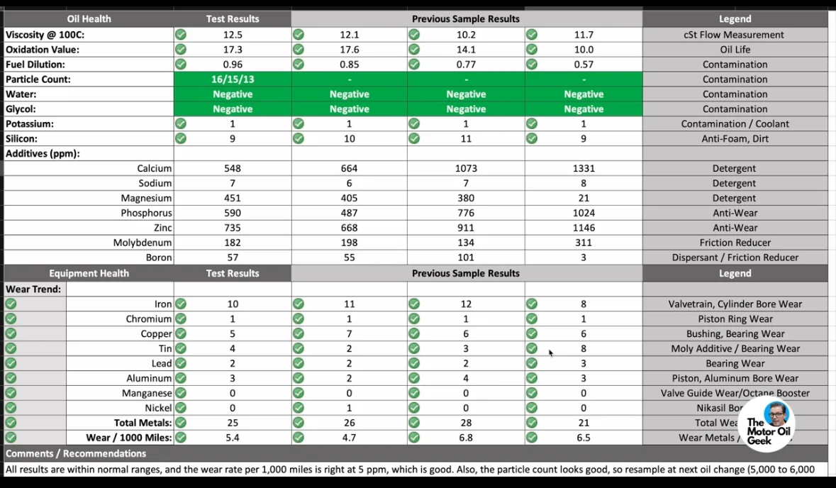

Here are the results from the vid. You can see all wear metals are 1-2 ppm from each other. As usual all oils are statistically identical in wear metals on UOA’s. Wrong tool to compare oils. A UOA is used to monitor for internal engine problems and for oil service life. These vids are clickbait and a UOA sales pitch.

So how come flukes always favor PUP, not Amsoil or Driven? And in Lake Speed Jr's last video, PUP 0W-40 beat the crap out of Amsoil. So how come flukes always favor PUP? No, the fact is that it is not a fluke, it's just a better oil. Do 10 tests in a row, and PUP will beat Scamsoil and Driven every single time. Because it is an oil made by a gargantuan company that knows what the hell it's doing, while Amsoil and Driven are made by tree shade blenders. Shell is the Toyota of motor oil.

You can’t rank oil based a few ppm difference in wear metals. Every UOA company will tell you there’s no difference between brands. Viscosity, engine type, and engine use have more effect on wear metals than the brand. No official wear study uses UOA’s.
A UOA doesn’t show engine deposits which are more likely to kill an engine than it wearing out.

That's why I asked you, how come it's always PUP that shows less wear? It could be a coincidence once, twice, not every single time. No it is not a coincidence, if Lake does 100 tests in his Porsche, PUP will do better every single time. Are you telling us that the Universe is conspiring to make sure that PUP's wear metal show up less every single time? 🤦‍♂️

1-2 ppm isn’t less wear. It’s statistically the same. It’s within the margin of error. I’ve seen VOA’s with more standard deviation in iron than 1-2 ppm.

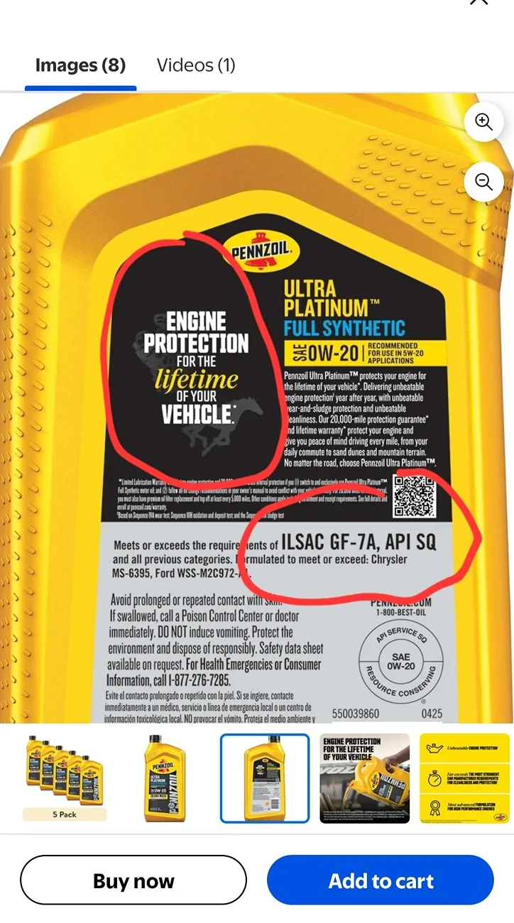

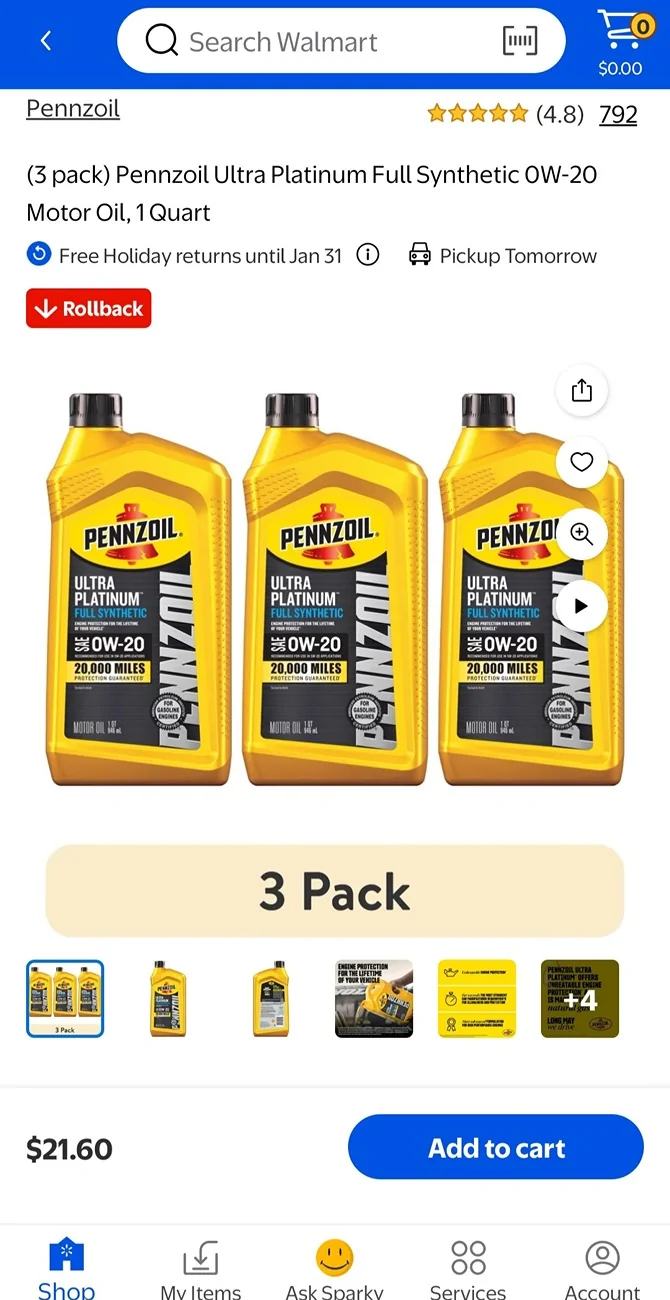

I can't wait to get my hands on the latest version of PUP 🤩🤩🤩
