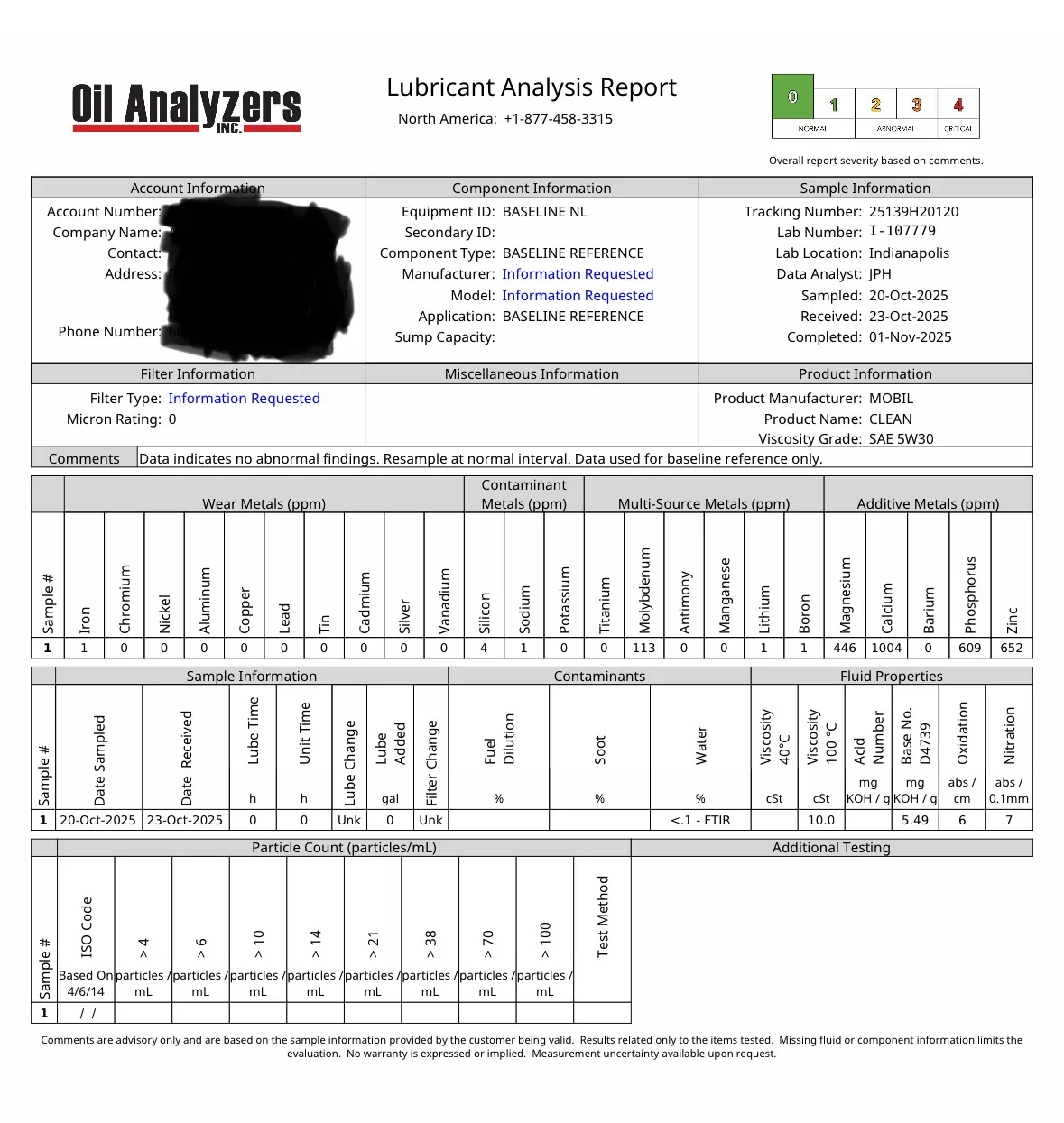

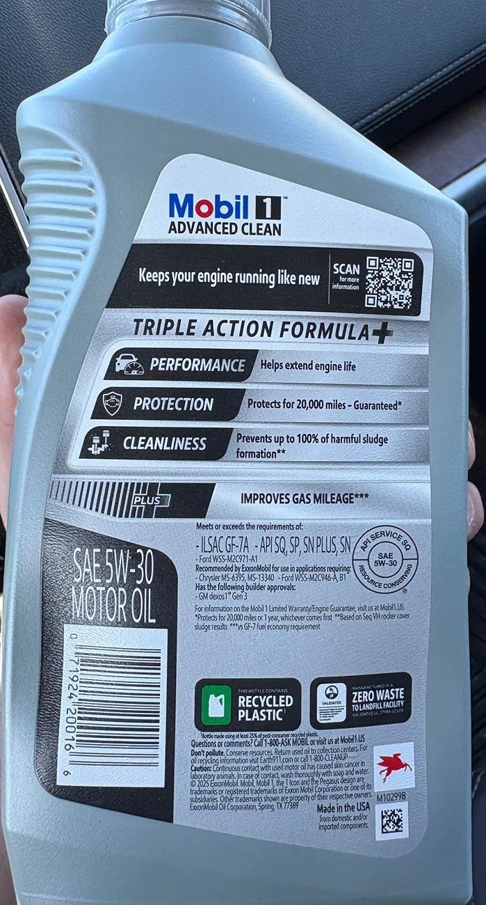

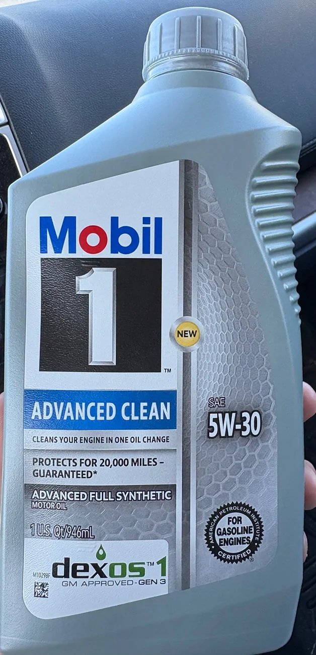

M1 ESP in 7 vehicles I own and or maintain.
This is M1’s newest.
Well that's a great oil, it is Mobil. My best UOA was with Mobil 1 too. I am talking about the boutique scam, they are tree shade blenders who have no clue about making oil. They buy the ingredients made by Shell and Mobil, mix them and hope a good cupcake is made by accident. No thank you!

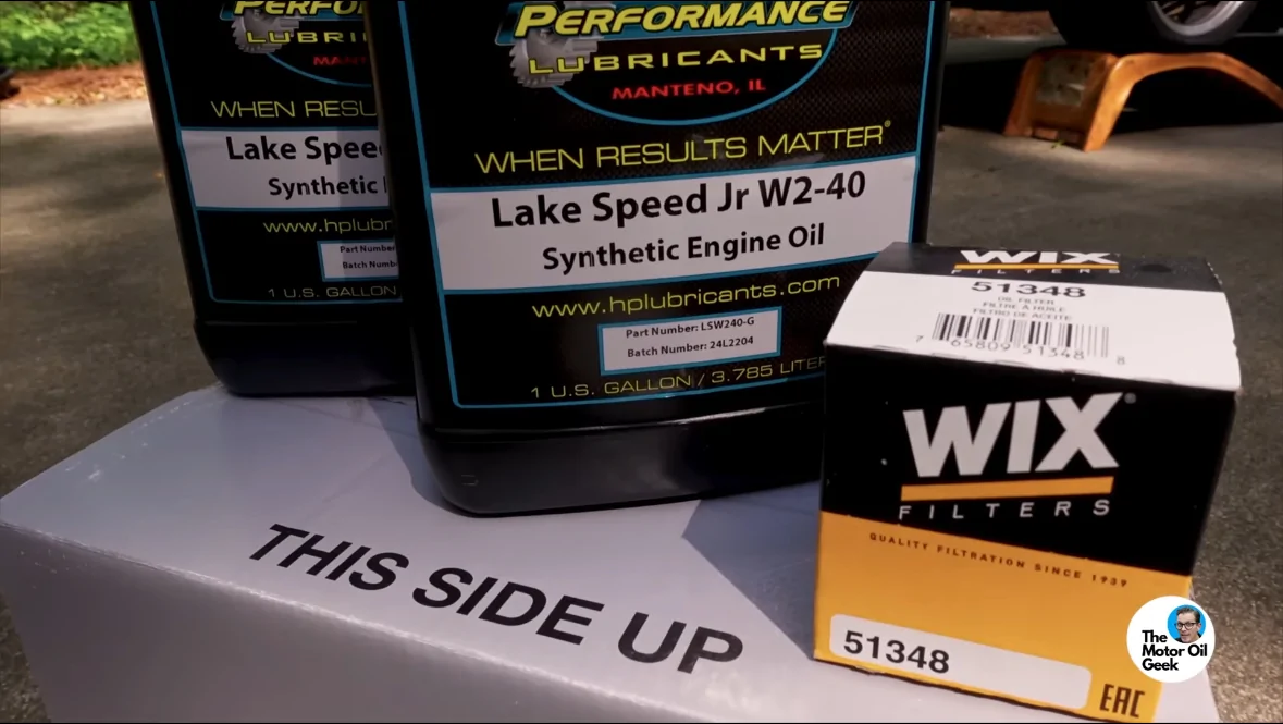

I don’t use boutique engine oils but would have no problem trusting HPL or Amsoil. HPL was formulated by Dr Leslie Rudnick. The god father of synthetics who worked for Mobil for over 30 years. He created Mobil 1 Tri Syn.
I also would have no problems running PUP 0W-40. Lake formulated Driven oils so I’m sure they’re fine as well. I have watched every Lake vid to date. He has yet to test SS but plans to do so in the future. Lake currently has HPL oil in his Porsche because he thinks he can do better. It will be tested against PUP and Driven.
