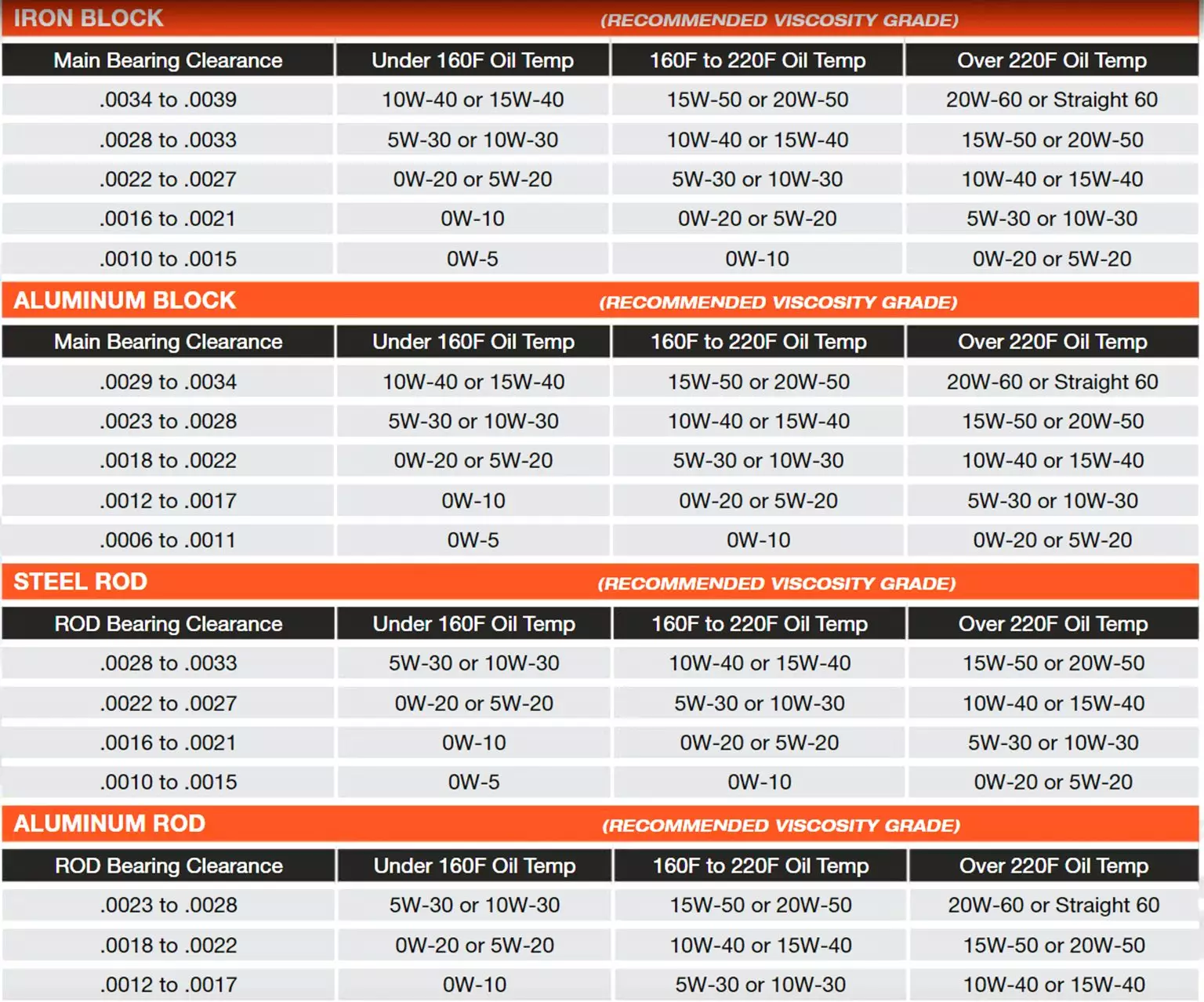

Lake developed this chart when he worked at Driven. How to choose viscosity based on oil temperature and bearing clearance. It’s served me well over the years. The W rating would be dependent on your winter time lows but the grade still applies.
Jeep Wrangler JL PUP beat Driven IMG_6143
So ESP 0W-30 in the Pentastar agrees with that chart? And Seattle area for the temperature, 25° to 95°

In Socal I usually run 5W-30 in winter (Winter lol) and in summer switch to 10W-30 or even 10W-40 if its a particularly hot summer. I also mainly use the jeep for off-roading so lots of slow speed, hot overall temps. Not much air going over radiator and oil cooler. Due to how my jeep is used I do 3000 mile oil changes. Oil is cheap. Plus it gives me opportunity to look it over.

That’s exactly what I use. PUP 5W-30 would work for you as well.
