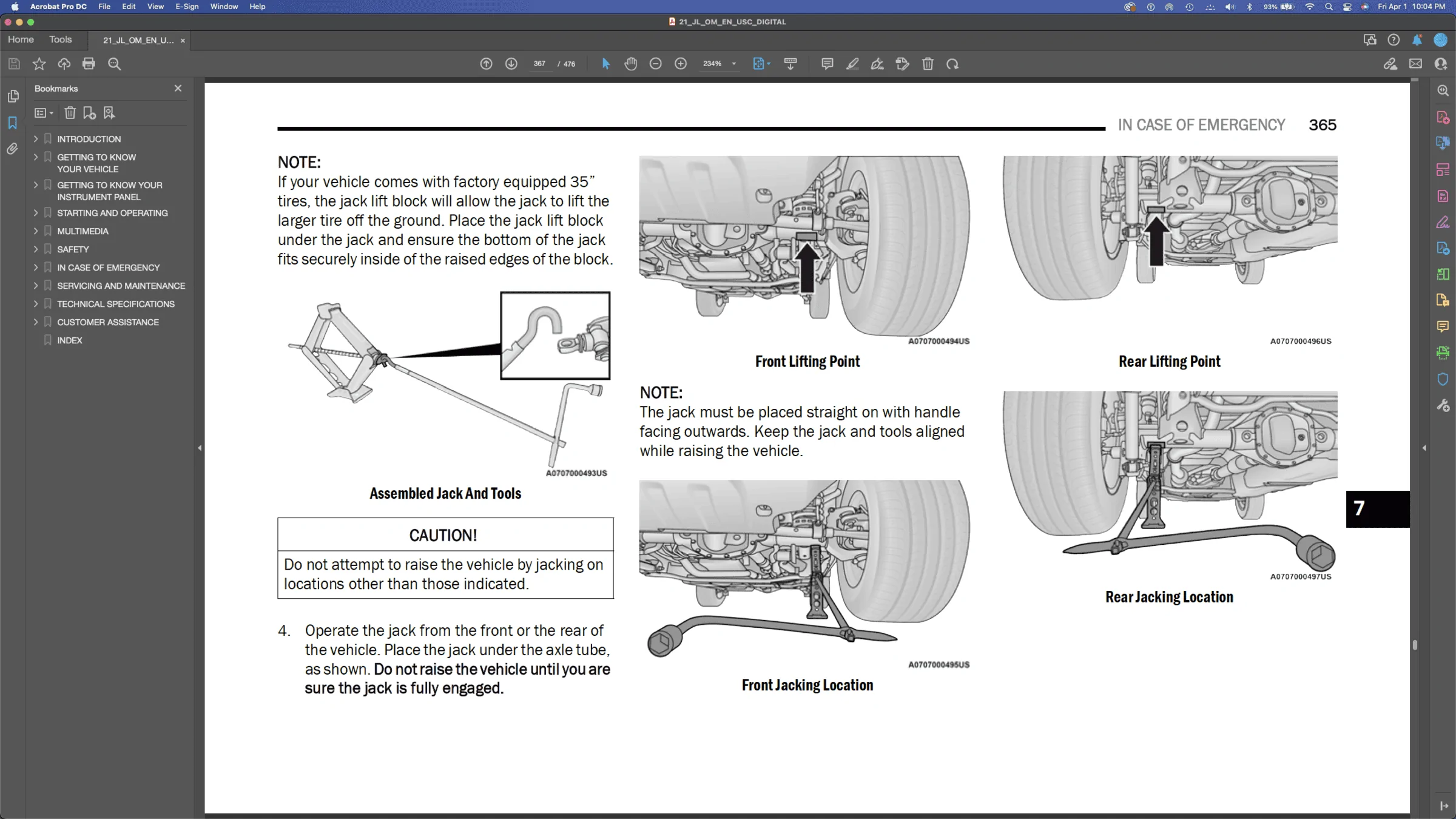

I've seen and heard of others jack on the pumpkin but I won't do it... just seems like a bad idea. I'm in favor of using the jack points described in the user manual - under the axle tube - then placing the jack stands under the frame. Seems like the most trouble-free approach to me. I also have a thick, rubberized pad on the floor jack's contact disc so it's not steel on steel. There's a little give at contact. Good luck.
Where on the frame do you place the jack stands? Also, wouldn’t the jacking points described in the manual be the best location for jack stands?
I mis-spoke earlier, I meant the axle tube, not the frame - my apologies. It depends on how long the vehicle will be jacked up. If just briefly - like rotating tires - I'll use a floor jack beneath the points described in the manual - directly below the spring perches - and not use jack stands. Since writing the above I've also swapped out the differential covers with Dana Advantek nodular iron covers making the pumpkins more rigid. Because of that I'm OK using the floor jack on the pumpkin if I need to get jack stands under the spring perches. Hope that makes sense...

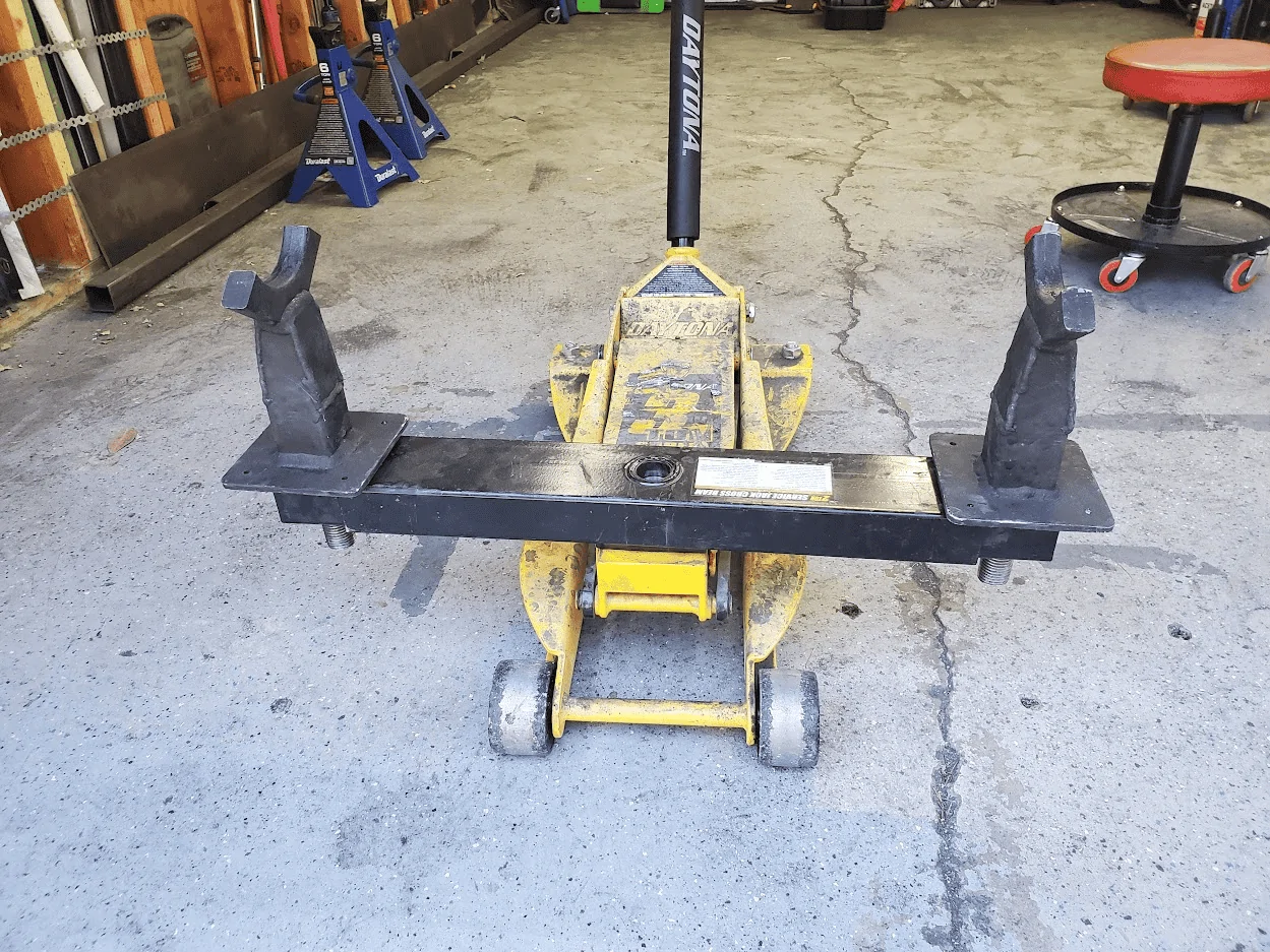

I would not lift the JL from the pumpkin .. especially the front with a heavy engine, and how much heavier JLs are now with all the crap we install on them.. LOL ... imagine the torque / bending forces... no bueno...
I fabricated this using a 3 Ton Floor Jack, Cross Beam, and scrap metal..
Jeep Wrangler JL Pumpkin Jacking....? 1680807098498
I can extend the cross beam arms and I lift the JL from right under the springs.... of course this is just
temporary as I then secure the JL on Jack Stands.. I never get under the JL by using this
contraption... LOL.. I have used it hundreds of times with no issues... I have no idea
if there is an equivalent product on the market... I have seen the ones for lifting Transmissions
and axles... but that is just to transport and lift the trans / axles into place .. they are not meant
to lift the entire Jeep ...

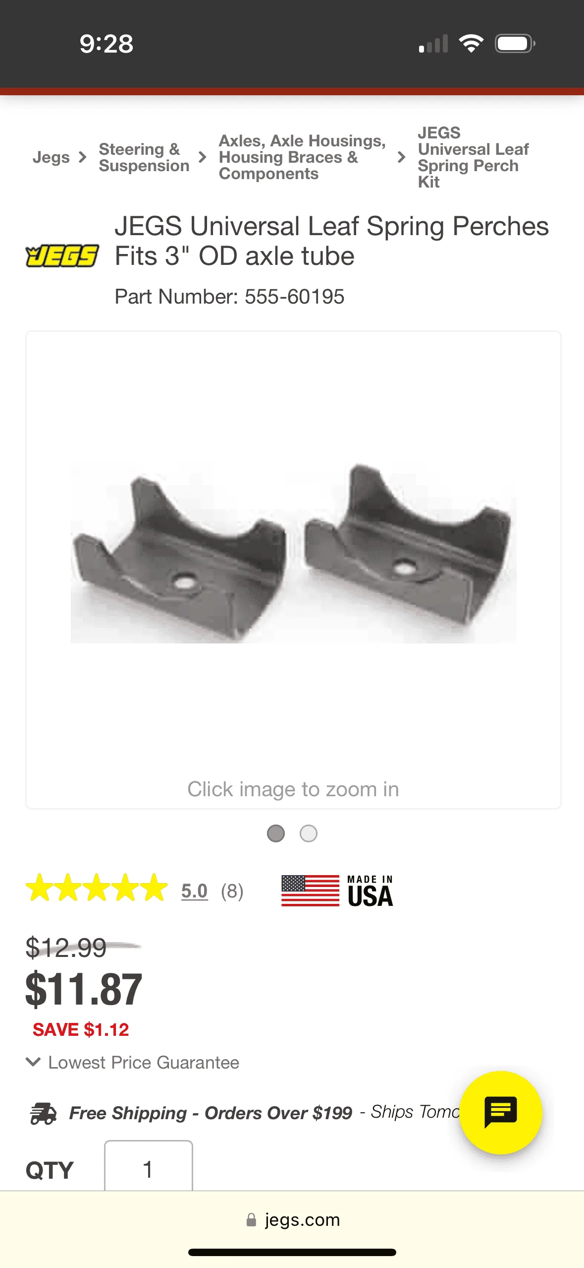

I just lift from the pumpkin in the rear, and use a leaf spring perch in the front, straddling the axle tube in between the pumpkin and the FAD… just enough room for the HF Daytona cradle not to contact anything, though it’s close and I have to watch as I raise the jack to not catch the edge of the FAD or something..
https://www.jlwranglerforums.com/forum/threads/how-to-put-the-jeep-on-jack-stands.24148/post-2121454
I struggled with this until I bought some leaf spring perches… 3” I believe fits the Dana 44 tube.
My HF jack has a pretty big rubber pad and the spring perch fits on there, and is thin enough to go next to the pumpkin in the middle of the axle. Lifts the front level and I can slide stands on the sides just like the rear axle.

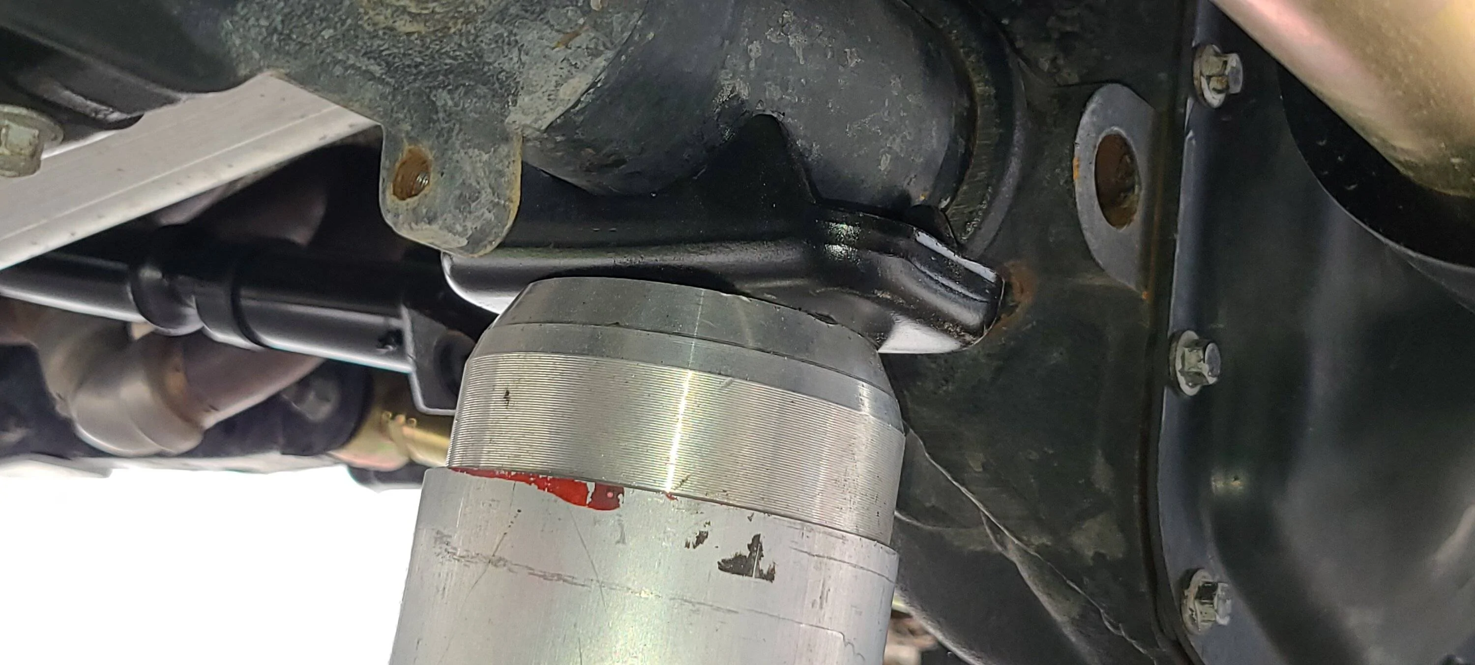

I use the front and rear pumpkins after I replaced the diff covers with 1/2” thick ring and 3/8” thick cover.
Normally I use the frame and axle tube near the areas where under the springs welding points.

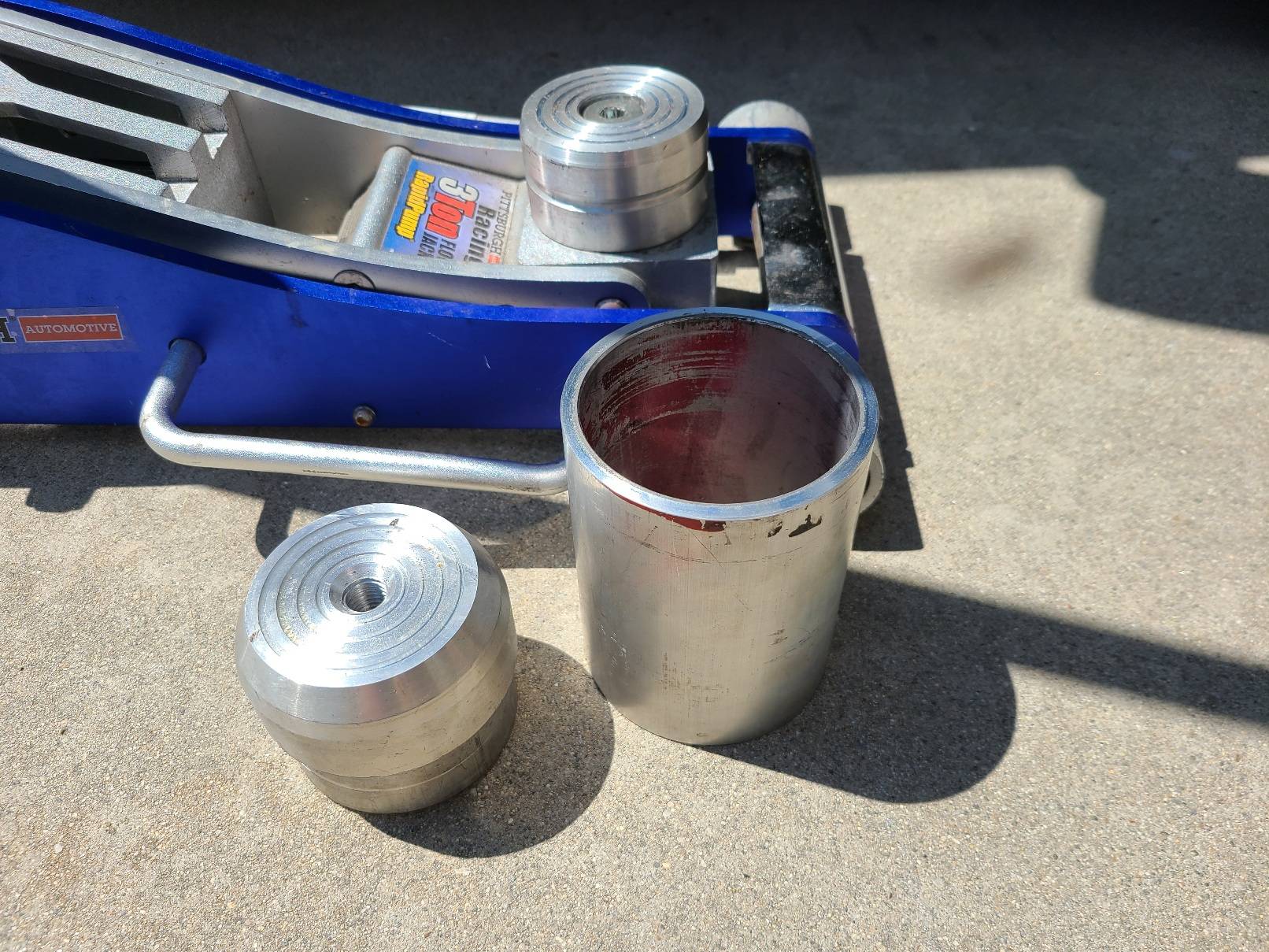

I have one of those from harbor freight. I have 3 floor jacks. One of which I've made extensions for.
