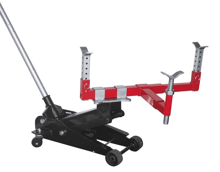

If you are constantly messing with your rig like I do and need to lift the entire front or rear evenly then you can get this floor jack adapter and make your life much easier and the task a lot safer:
3 point Jack Adapter - for Floor and Transmission Jacks (911motorsports.net)

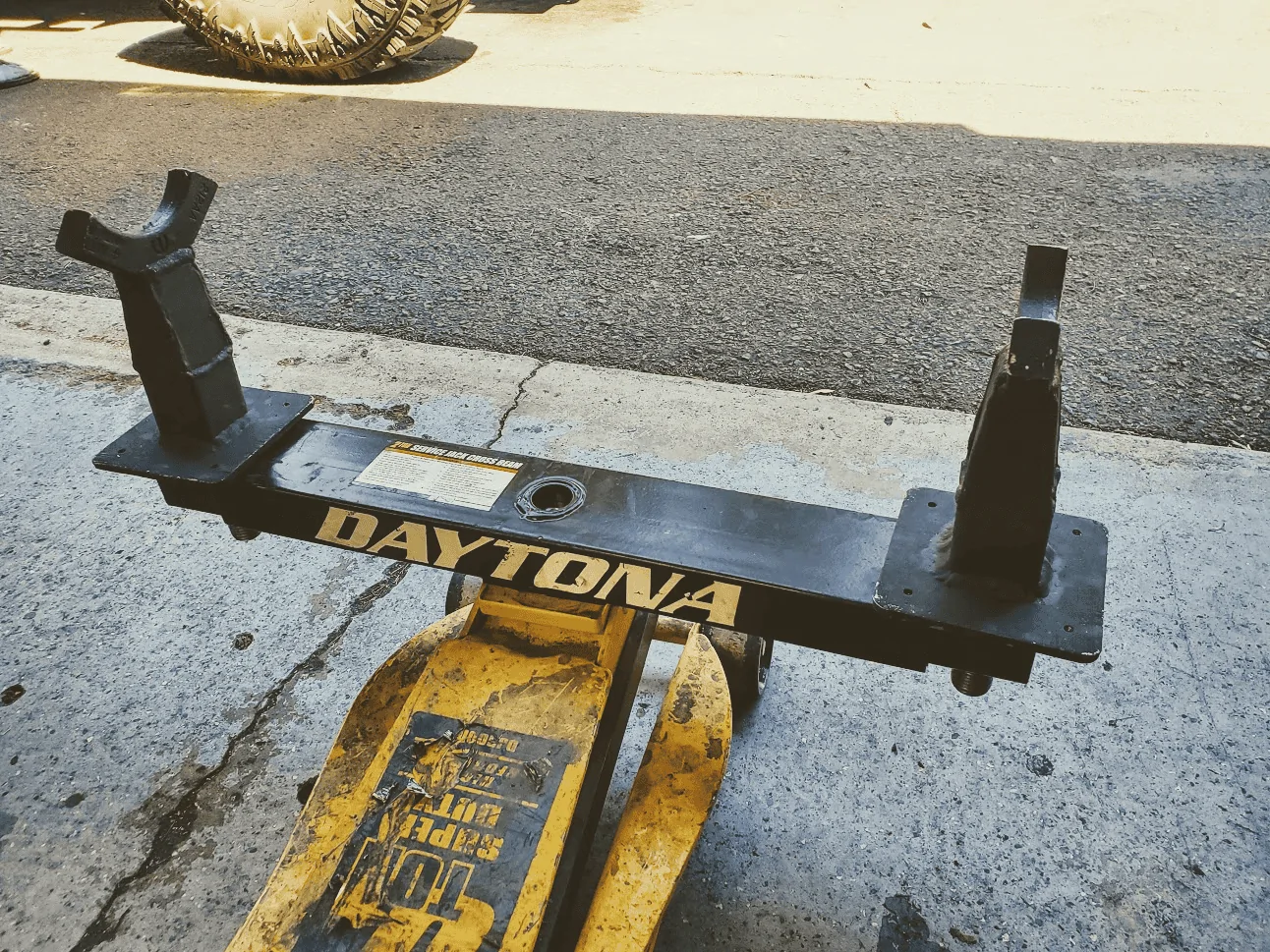

but... since I am a cheap bastard I removed these hooks from my front bumper..and before I tossed them...
Jeep Wrangler JL 2021 JLUR Jacking Question 1624413636248-png

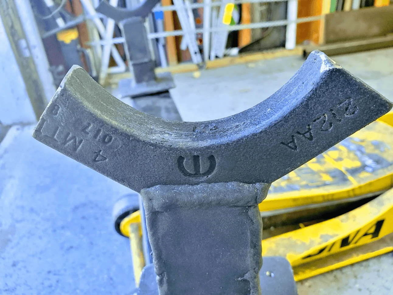

I am constantly jacking up the front/rear of my rig ... jack stands / floor jack works but is pain to lift the wheels one at a time ( I prefer not to lift the front/rear by the pumpkin) .. so I bought a floor jack crossbeam... reused the hooks and came up with this adapter that allows me to quickly lift front or rear:
Jeep Wrangler JL 2021 JLUR Jacking Question 1624414044377-png
Jeep Wrangler JL 2021 JLUR Jacking Question 1624414145133-png
