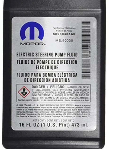

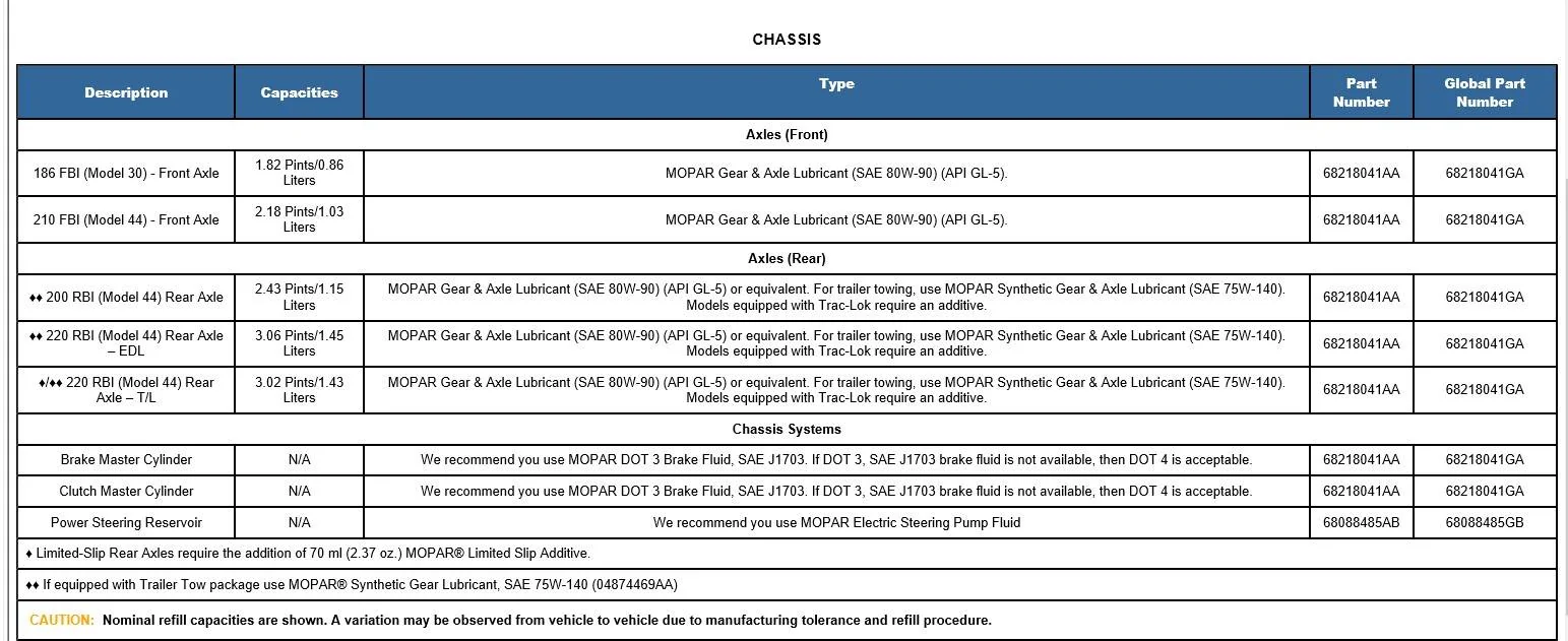

Just to re-base this thread...from my 2018 JL Wrangler Tech Authority Service Manual. The specified fluid is 68088485AB which is a Mopar material spec MS 90030
Jeep Wrangler JL Power steering fluid Jeep Chassis fluids
Jeep Wrangler JL Power steering fluid 68088485AB label
