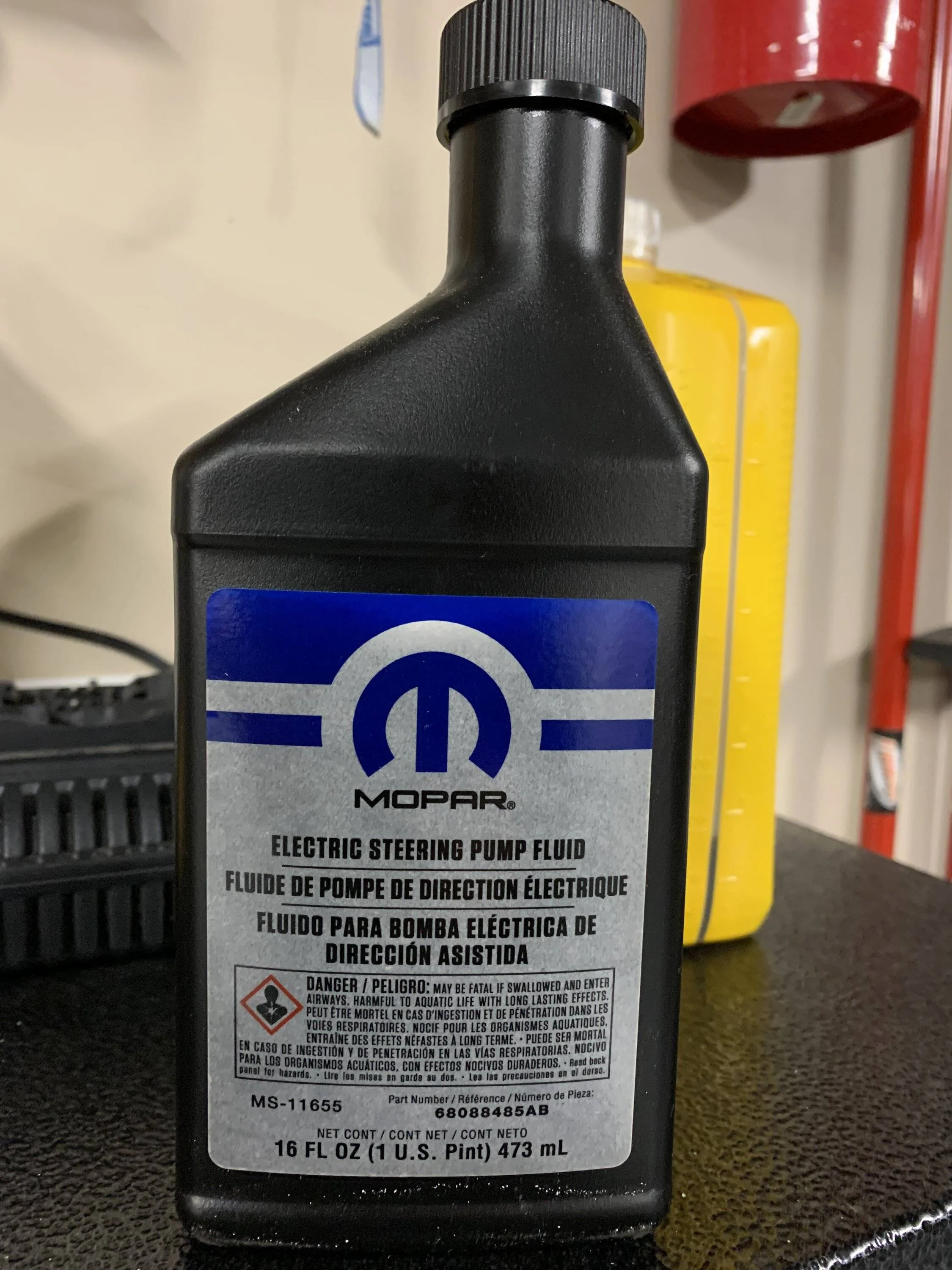

Regarding this> "MS-11655" mentioned or shown in pics in this thread.... that is the "spec number" that power steering fluid has to meet.
This one is the Mopar fluid you would use for your JL..
Power Steering Fluid
Mopar 68088485AB
https://www.amazon.com/Genuine-Mopar-Fluid-5127381AB-Hydraulic/dp/B0089LTVIY

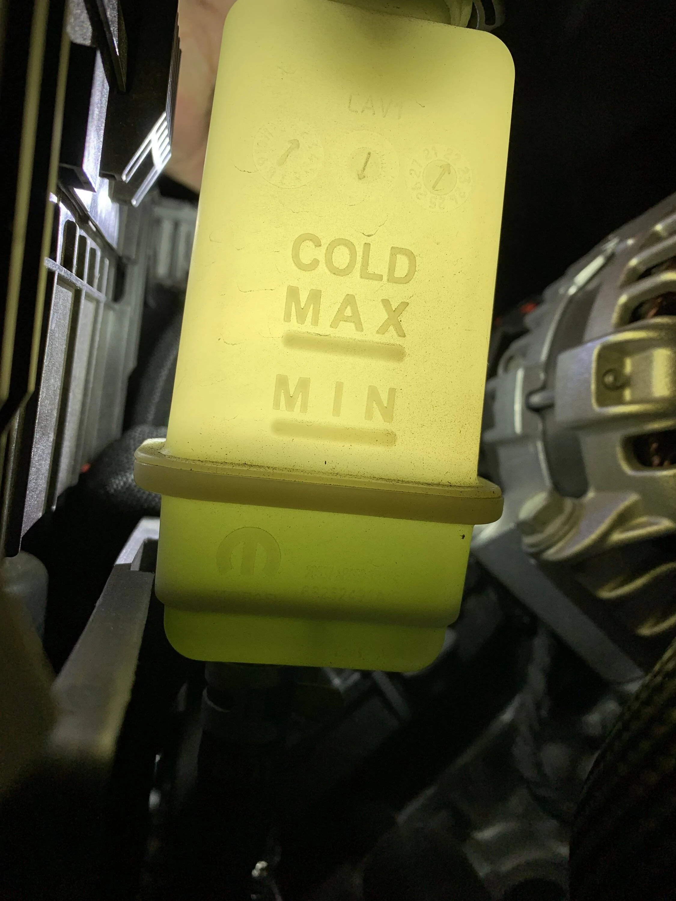

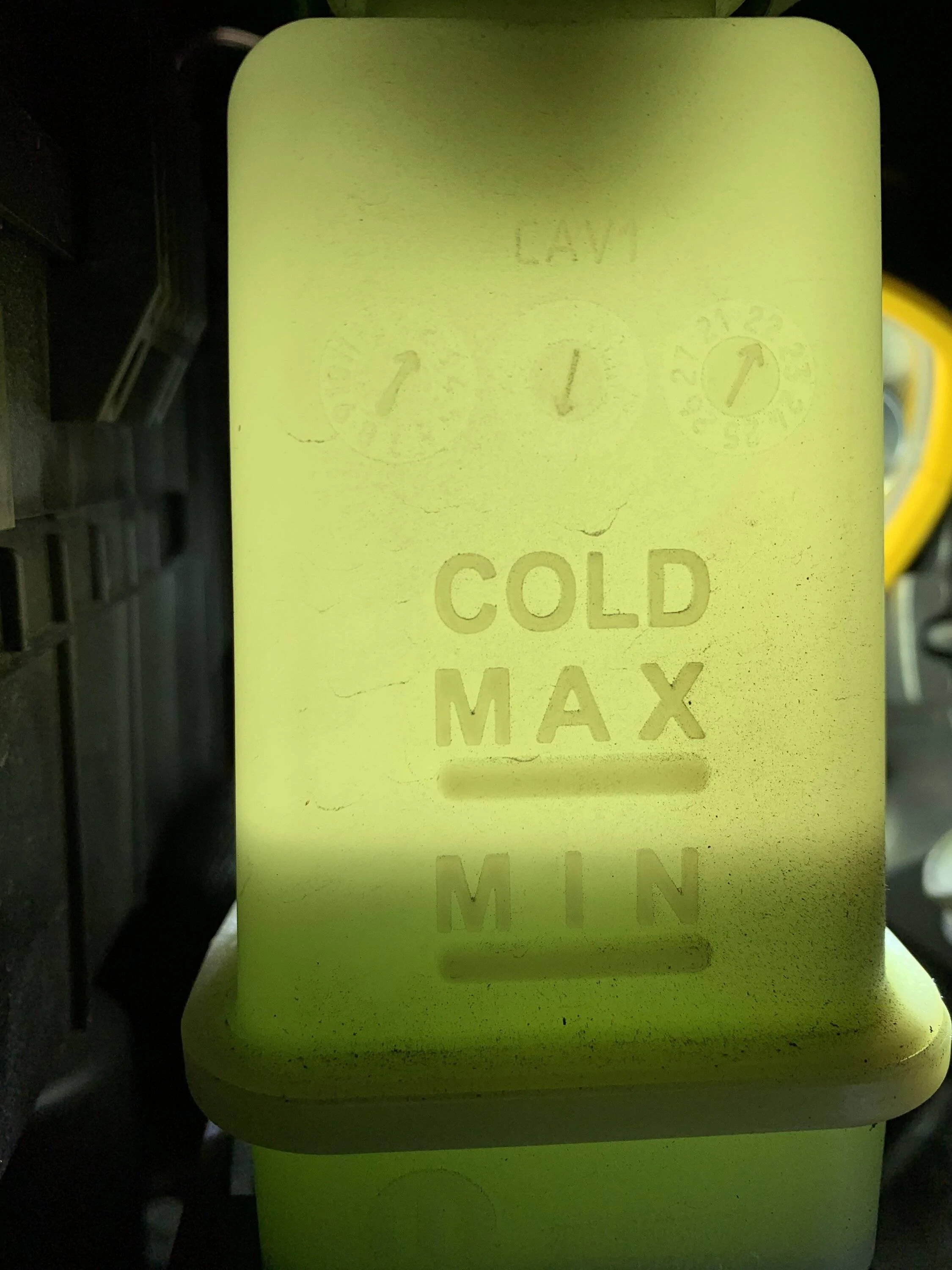

Get a good light and a step stool ... Climb up and look at the backside of the reservoir..... the side facing the fire wall. If you look real close you will see the MAX MIN lines.
I had to really look close to find the lines. After I found the lines, I used a black Sharpie to make lines in corresponding places on the front of the reservoir..
When the vehicle is cold... been sitting say all night fill so the fluid level is in between the Max and Min lines..

I was cleaning the garage and found a bottle of the Mopar steering fluid that I bought to top off my 2015 Jeep Grand Cherokee from two years ago, bought from dealer. Turned out to be the right one used for JL.

Checked mine and it was low, so topped off to the middle of MAX and MIN per @Rhinebeck01 's suggestion.
