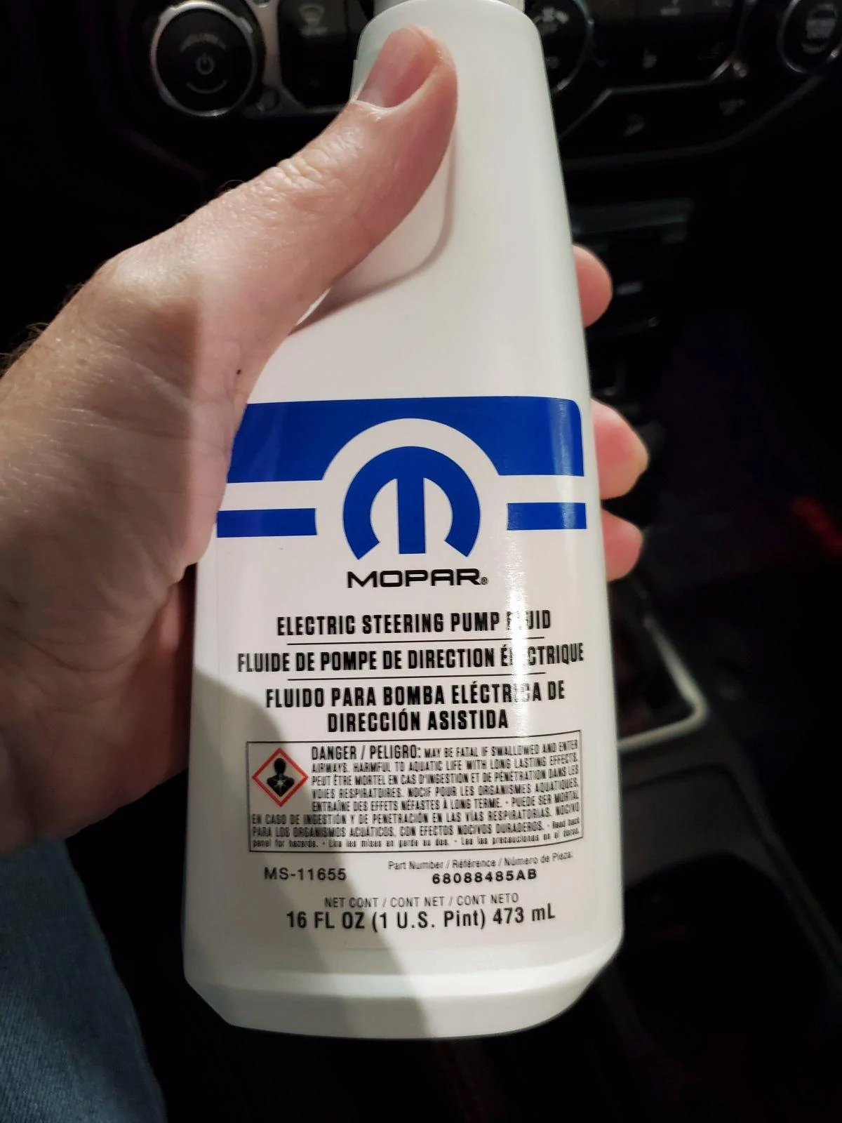

Had the steering box TSB done and this is the fluid they used at the dealership. Had to have them top off the reservoir tank as it was a little low a few days after the work was complete.
I went to the dealer today and asked them for a bottle of fluid and this is what they sold me, I asked if other power steering fluid sold at places like Autozone and Advance and the parts guy just looked at me and said why take a chance for a few dollars savings.......needless to say I left with a bottle of it and also a jug of OAT coolant

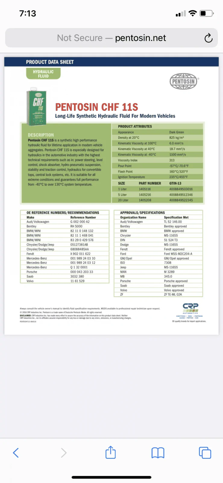

Anyone use Pentosin CHF 11S? It shows as approved for Jeep with the MS-11655 requirement. I’ve had good experience with it in my past vehicles, would like to use it for the Jeep as well...
I was at the dealer this afternoon for a top off after the steering gear replacement from a few months ago. They used this stuff exactly. I’d say this is definitely okay. Also, found this on their website:
Jeep Wrangler JL Power steering fluid FB4053A6-C1C5-413C-812D-BD02EB664EBA
Shows as OE replacement for Mopar part 68088485AA (AB is just a part # revision).
Good luck to you!

Power Steering Fluid ... Mopar 68088485AB
