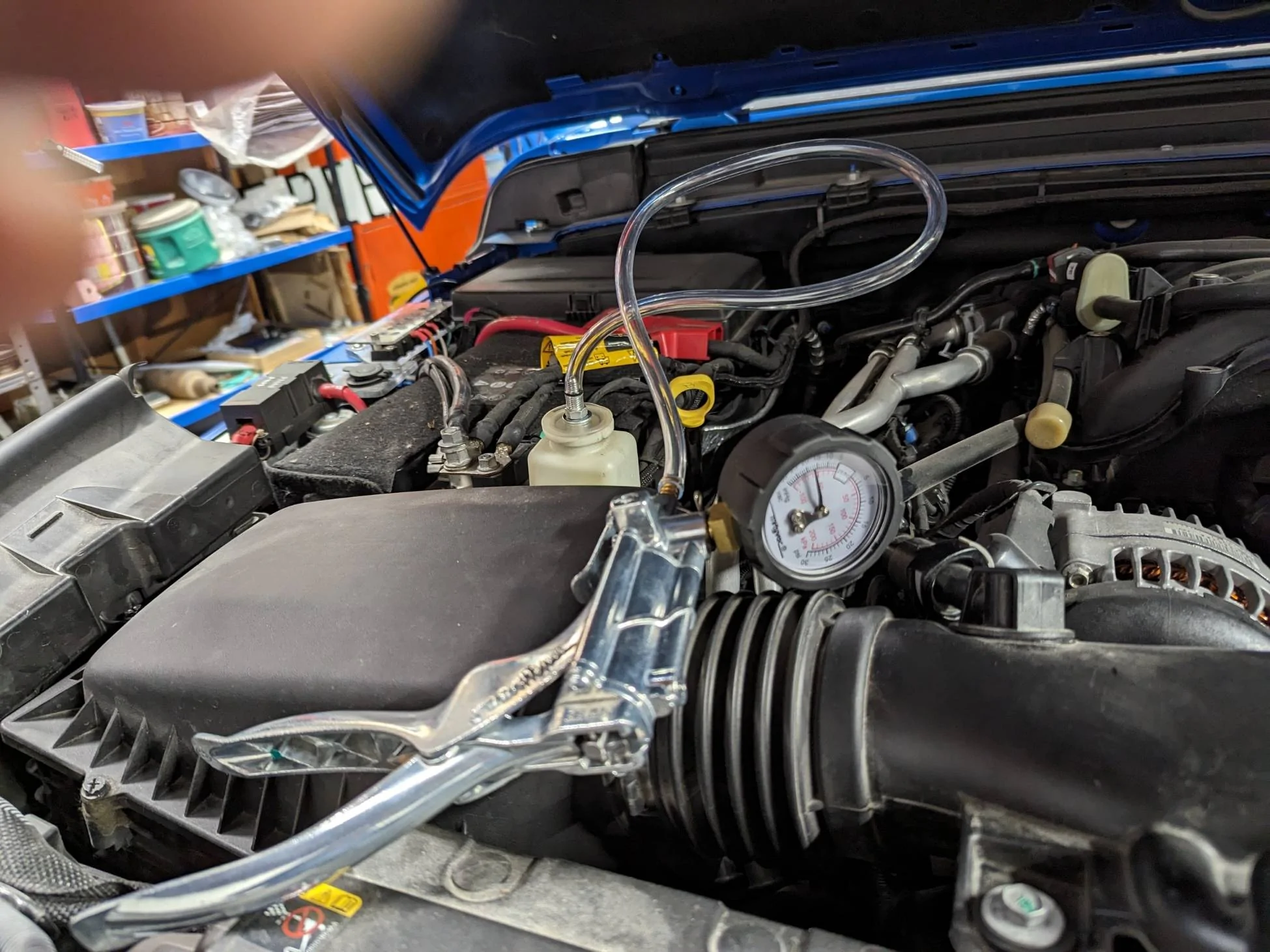

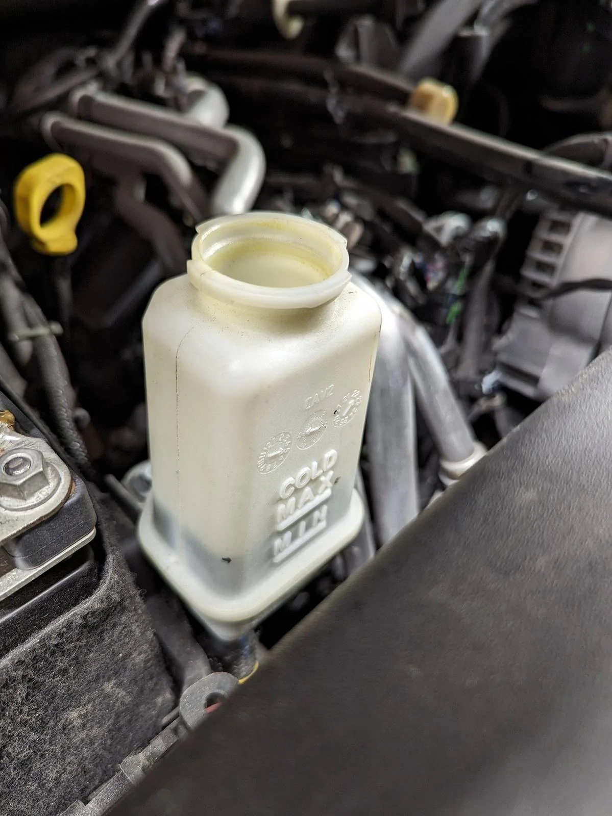

Performing FCA document on bleeding power steering system -
Jeep Wrangler JL Power steering fluid PXL_20231108_222632776
No air - trying to prove to another guy who insisted that they all had air and you'd burn out your pump if you didn't follow his method of bleeding.........
The proof is in that I followed the FCA document, and after 2 years, the level hasn't changed any from the dot I put on it a month after buying the Jeep.

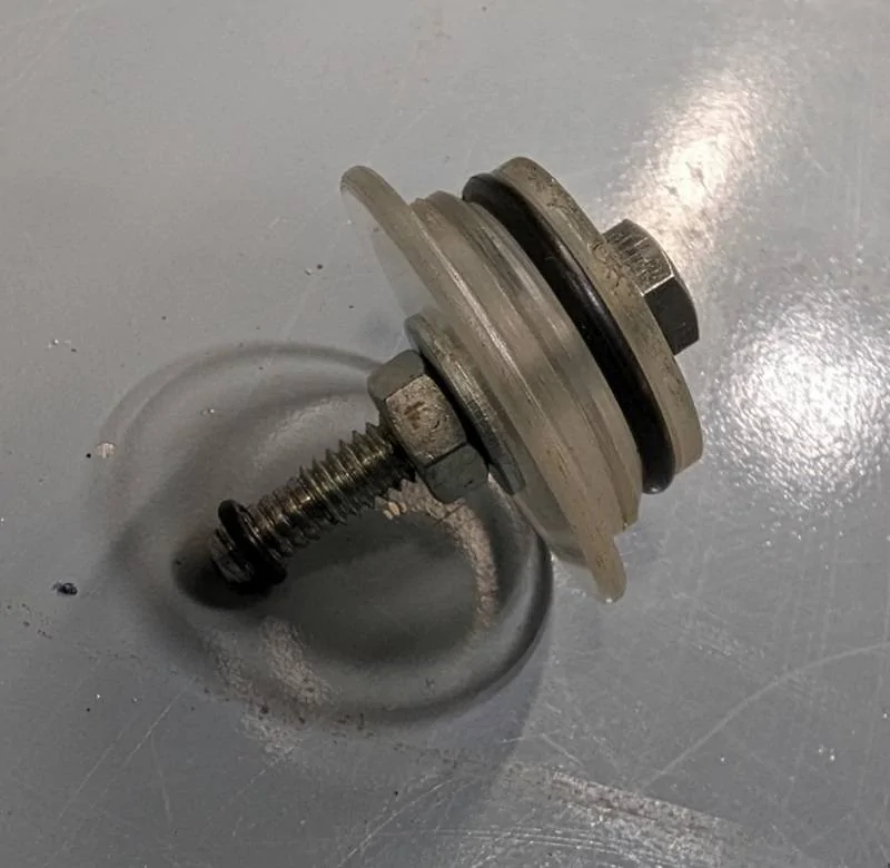

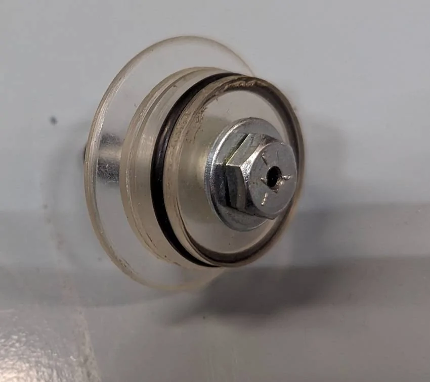

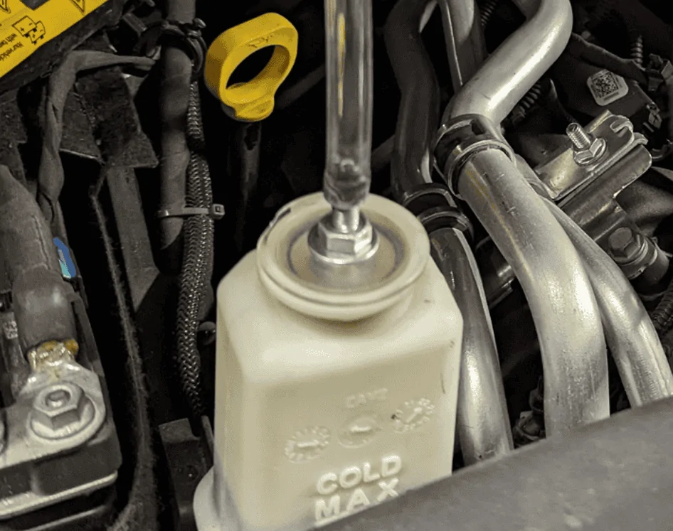

So what is the method you recommend for bleeding the power steering system? I couldn't find it and I don't have access to OEM service manuals.
I made my own cap adapter out of layers of acrylic and a large o-ring. I used hole saws in my wood shop upstairs to make the round plastic parts, and my lathe to drill a hole through a bolt.
You can buy adapters like the document recommends on Amazon and other sources. That tells me that these aren't the only ones that use that sort of method if there's a market for them online.
