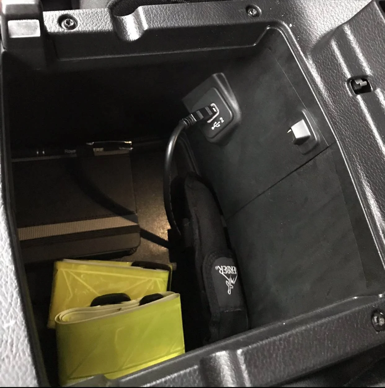

I ran a usb cable from the center console, under the hand brake area and up behind the dash. It took about a hour. The hardest part was unbolting the center console in the back to drill the hole and fish the wire through the center console.
Jeep Wrangler JL Phone Holder Alternatives? E897E127-626C-410D-94F0-D5B917011F0B
I removed the rubber liner in the bottom and drilled the hole in the rear drivers side corner.

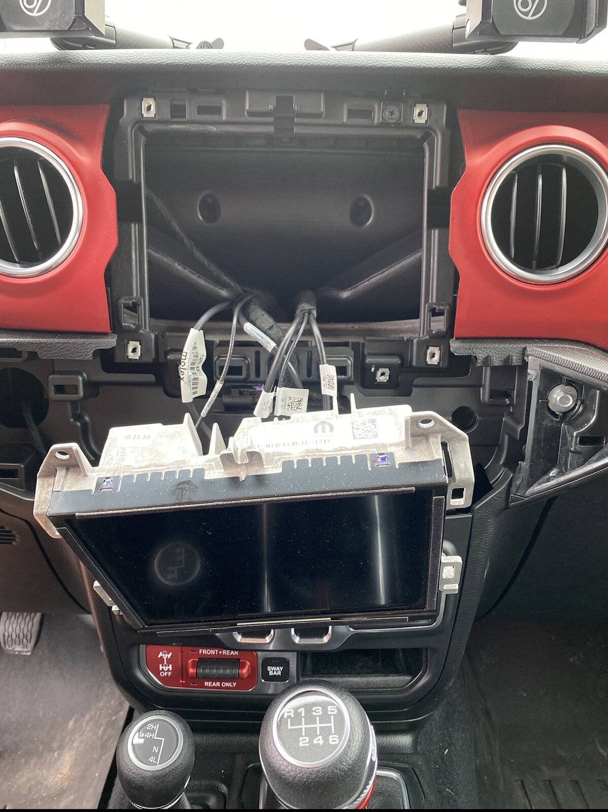

You only have to removed the AC control module (takes less than a minute), and unbolt the radio. You can fish the wires up from the bottom and easily access the top tray.

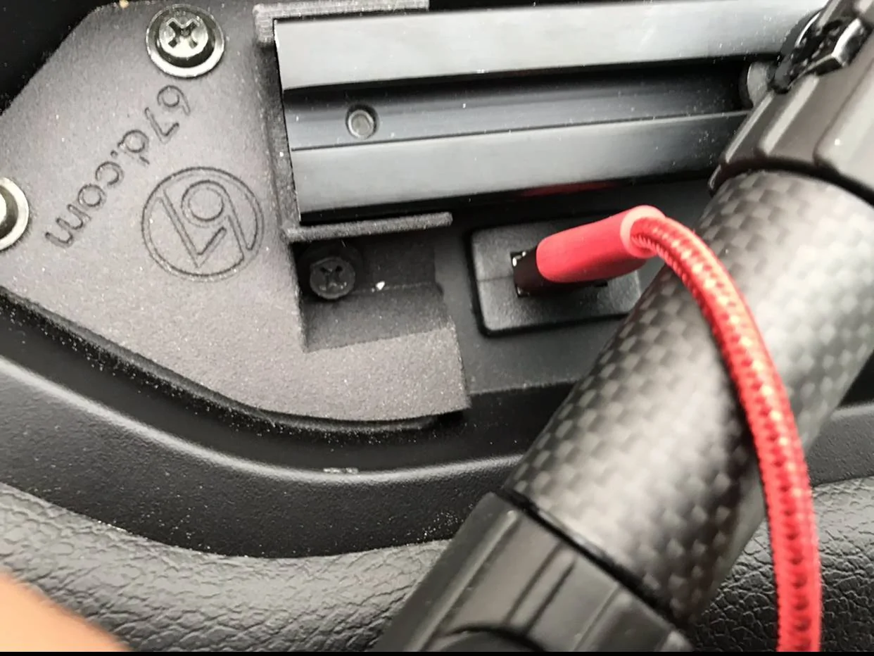

BATIGE Square Single Port USB 3.0... https://www.amazon.com/dp/B07CKM7KGK?ref=ppx_pop_mob_ap_share
This is the usb cord I used. I installed it back in July of 2020 and it has worked flawlessly.

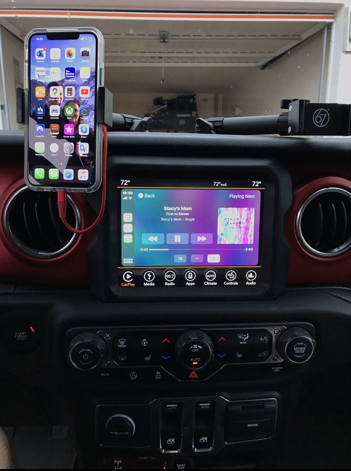

Finished product. I couldn’t be happier with it.

This is exactly what I’m looking to accomplish. I would like to have possibly up to three chargers but I would be satisfied with two. Is this enough to charge an iPad Pro over that distance?
