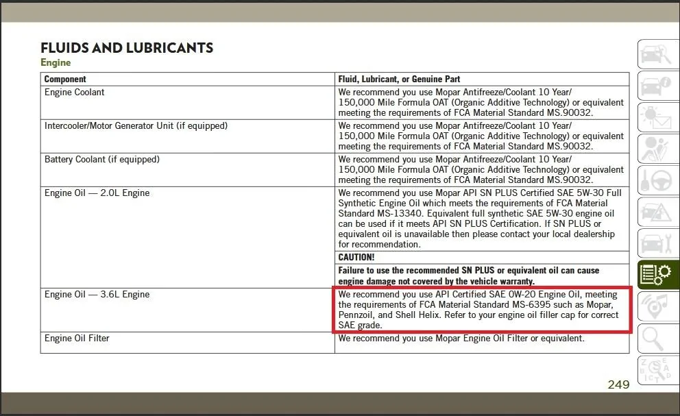

@Formattc - one thing to note is also FCA's careful wording:
We RECOMMEND you use API Certified SAE 0W-20 Engine Oil, meeting the requirements of FCA Material Standard MS-6395 such as Mopar,Pennzoil, and Shell Helix.
Recommend is NOT the same as require--if it were, FCA would have to provide the oil they require you to use. In addition, this leaves it open to using any API certified oil. Last, but not least, look at the wording for the oil for the 2.0L engine:
Equivalent full synthetic SAE 5W-30 engine oil can be used if it meets API SN PLUS Certification.
This begs the question if the 2.0L can use any API SN+ oil (not necessarily one meeting MS-13340), then why can't the 3.6L do the same? I firmly believe that you can and use whatever API SN 0W-20 oil you like.
They use "recommend" because they cannot require anything regarding your vehicle. It's your vehicle. If you use bacon fat in your engine and the MAF sensor fails, they would be in violation of consumer laws if they denied warranty on the MAF. However, if the camshaft fails, they would contend that you used a lubricant that led to the camshaft failure. If you find a boutique oil maker that has developed the miracle oil of all time, but has no approvals and your camshaft failed while using it, be prepared to get into a legal battle with FCA over warranty of the engine. The point is: if you don't do what they recommend, you may be put on the defensive if you have a warranty claim. So you have to ask yourself: "why do that?"
Agree; except the overarching umbrella is API certified (SN or SN+) and not MS-6395 and MS-13340. FCA would have a heck of a time defending the position of allowing non MS-xxxxx specified oil for one engine and not another. This is particularly true when the engine they allow non MS-xxxxx oil to be used has statements in the owner's manual like this:
CAUTION!
Failure to use the recommended SN PLUS or equivalent oil can cause engine damage not covered by the vehicle warranty.
Which suggests the SN+ is far more important than the MS-13340 because it is not specified and the word "equivalent" is there. In the end, many times it is all semantics on the part of the wording.
CAUTION!
No doubt all the language was the product of lawyers. My point was that if you have an engine issue where oil might be a factor and it comes to light that you were using an oil that does not have the specification approval or a reputable manufacturer's "meets or exceeds" statement, the vehicle maker might well decline warranty coverage, leaving you to prove the oil is "equivalent". I have an idea of what a lawyer and laboratory testing costs and I wouldn't want to use my money to do that just to get an engine fixed. It might be cheaper to buy a salvage engine and pay to have it installed.
Exactly, and I have experience with a Magnuson-Moss lawsuit in 2002. I had early failure of front end components because the factory installed clogged grease fittings and they were bone dry, and they still tried to fight me, but ultimately lost.
PS: I grease my own front end now, ever since then. I literally count the fittings on my new car and memorize the number so I hit every one every time.
I agree with you! The good news is with the exception of Amsoil, every popular 0W-20 oil listed in the thread below has the statement of "meets or exceeds" or "recommended" in their PDS with regards to the MS-6395 standard. Amsoil states "Use AMSOIL Signature Series Synthetic Motor Oil in applications that require any of the following specifications".
