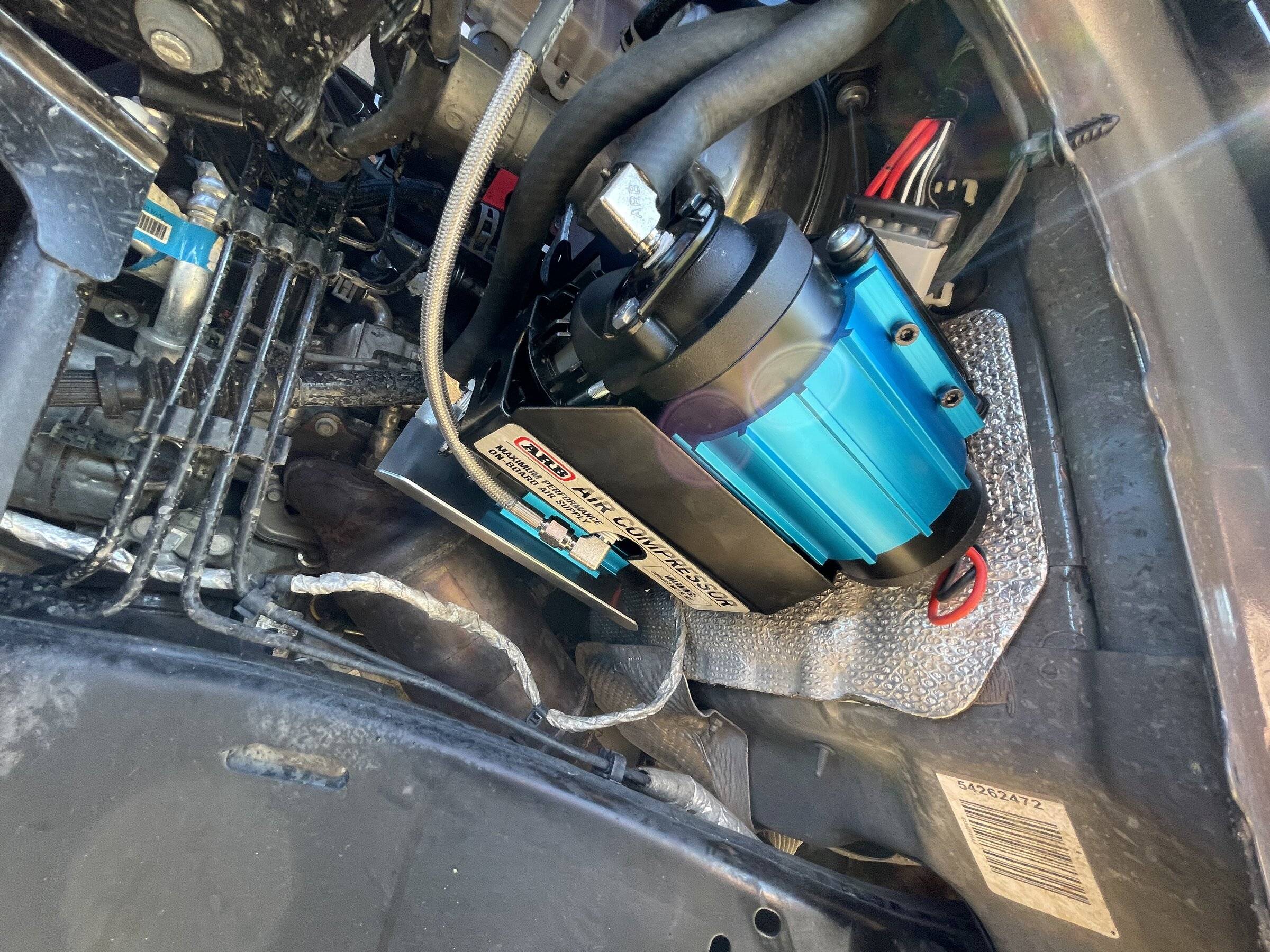

Jeep Wrangler JL On Board Air Setups? 32983AC2-FDE0-438D-96C3-7625CB4A0EB0
Jeep Wrangler JL On Board Air Setups? D1F5DA9D-6EB3-4779-B731-6DFD0DF3A375
Jeep Wrangler JL On Board Air Setups? 39C72428-A62D-4129-933C-F5B3701E6AC3
I run the Grimm ARB/SPod setup. I like it, works well for the 2 door (where space is at a premium). I had to shorten the filter hoses as it would push against the clutch position sensor and knock it off (preventing the Jeep from starting normally). Very simple fix and not really a con. My only complaint is with the stock fender liners, they suck and I feel the compressor gets splashed more then I would like. I am looking into upgrading the liners.

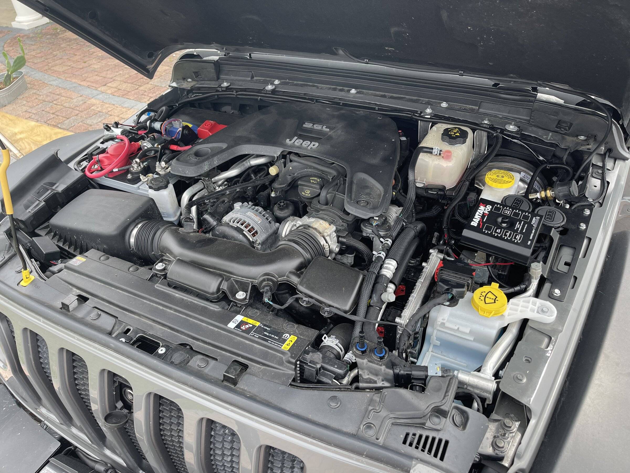

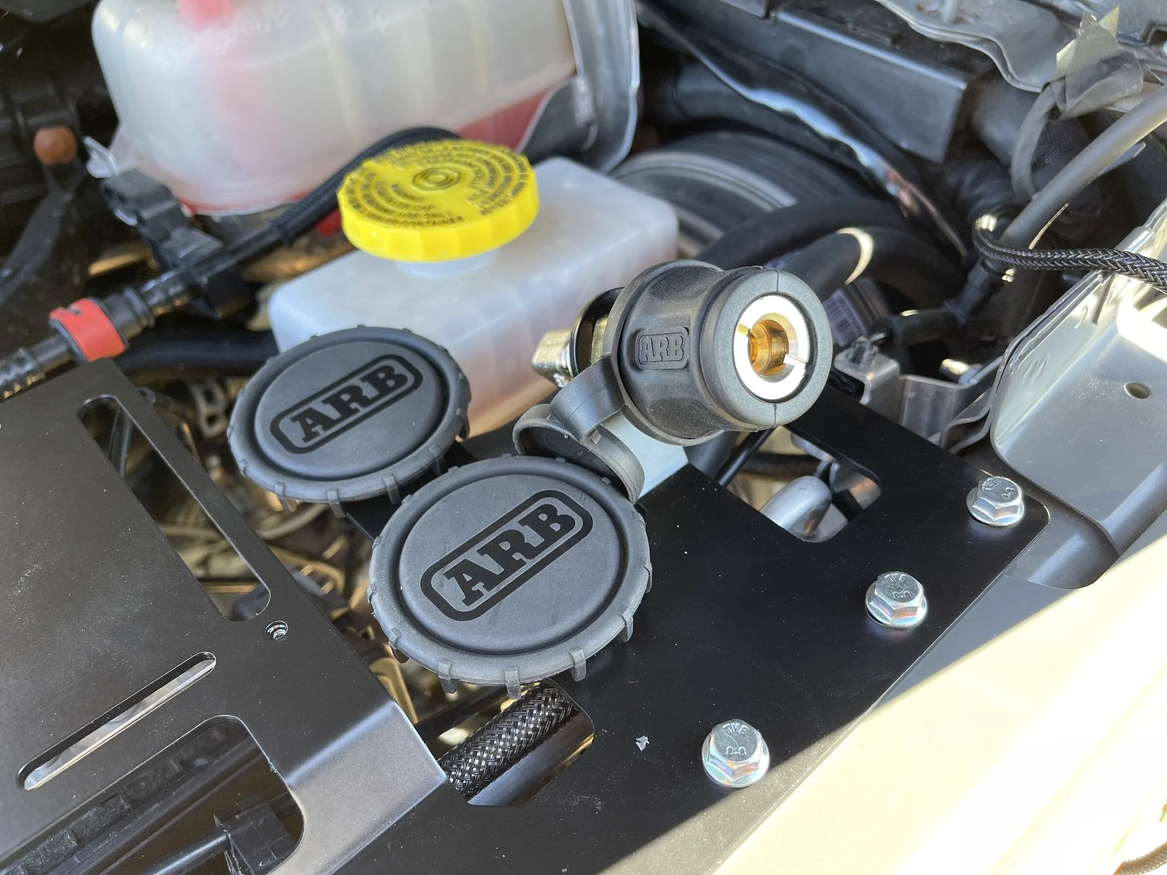

A mix of both actually. I felt the single would do the job of airing up just fine - and it does - the price vs convienience of the double didn't seem worth it to me. I do have the aux switches so it was a straight forward wiring job.
And the firewall mount really appealed to me - as a 2 door owner I need all the interior space I can get.
...And I wheel a lot with my wife, who gets to sit in a nice quiet interior while the pump buzzes away under the hood;)
But the single really works fine, call it 90 seconds or so to air up each 33 from 16 to 36 psi...
I have the same exact setup with that same under-hood mount and I’m happy as well!

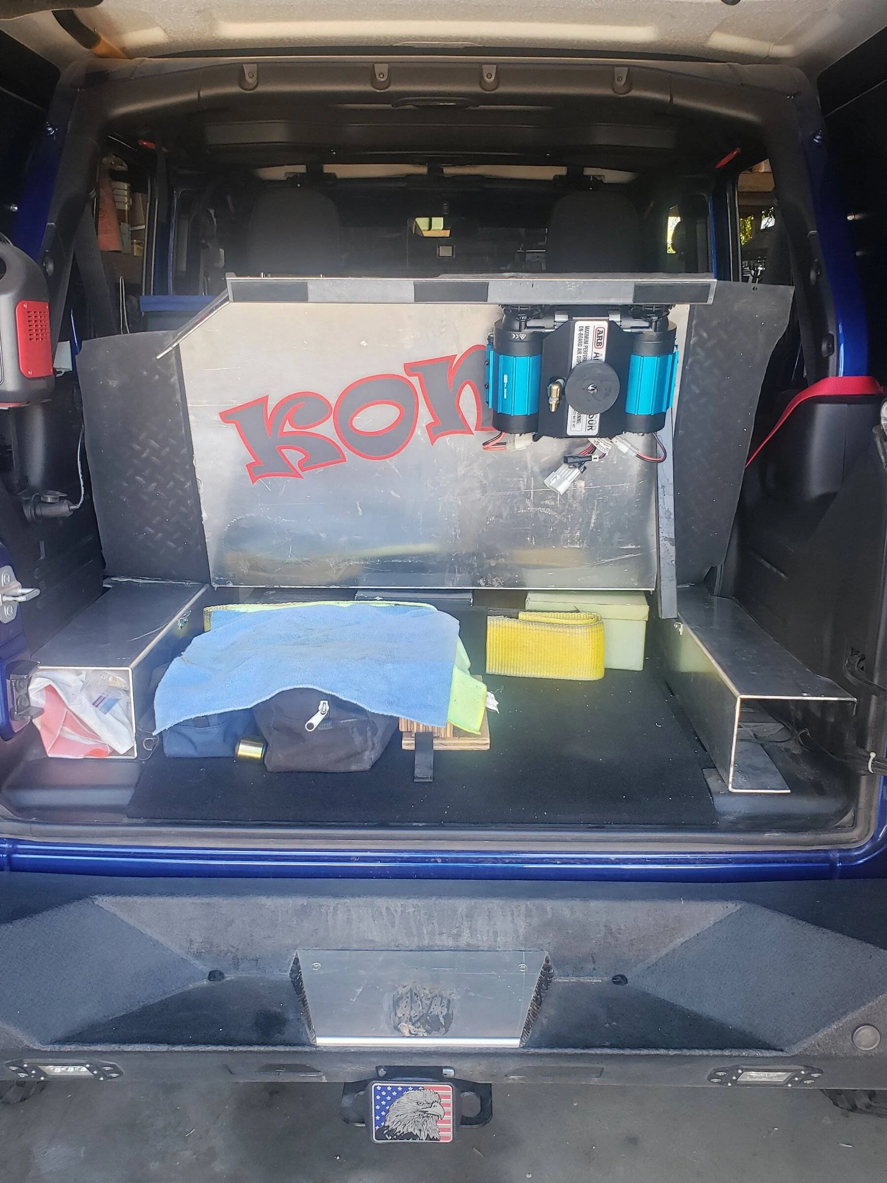

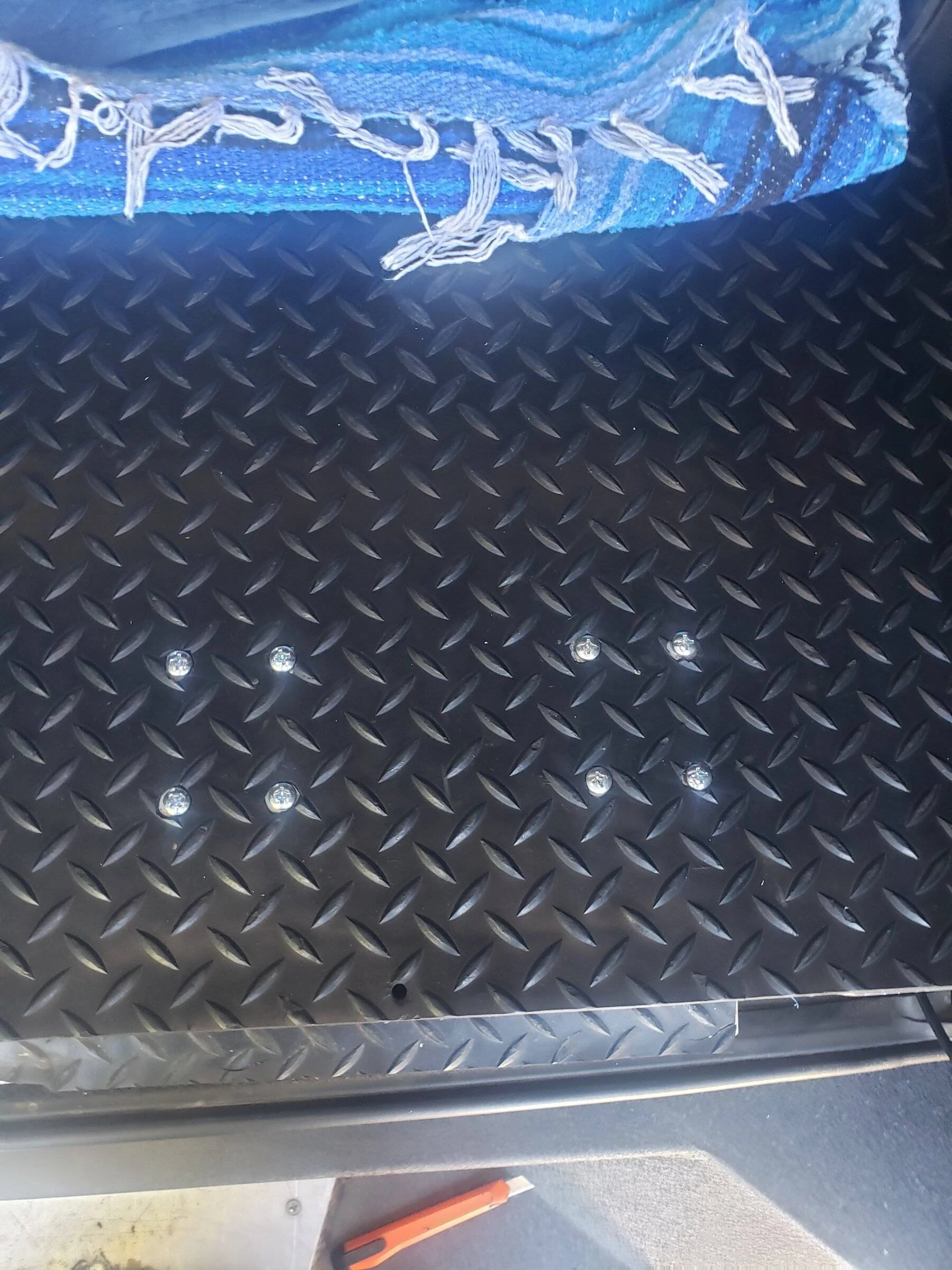

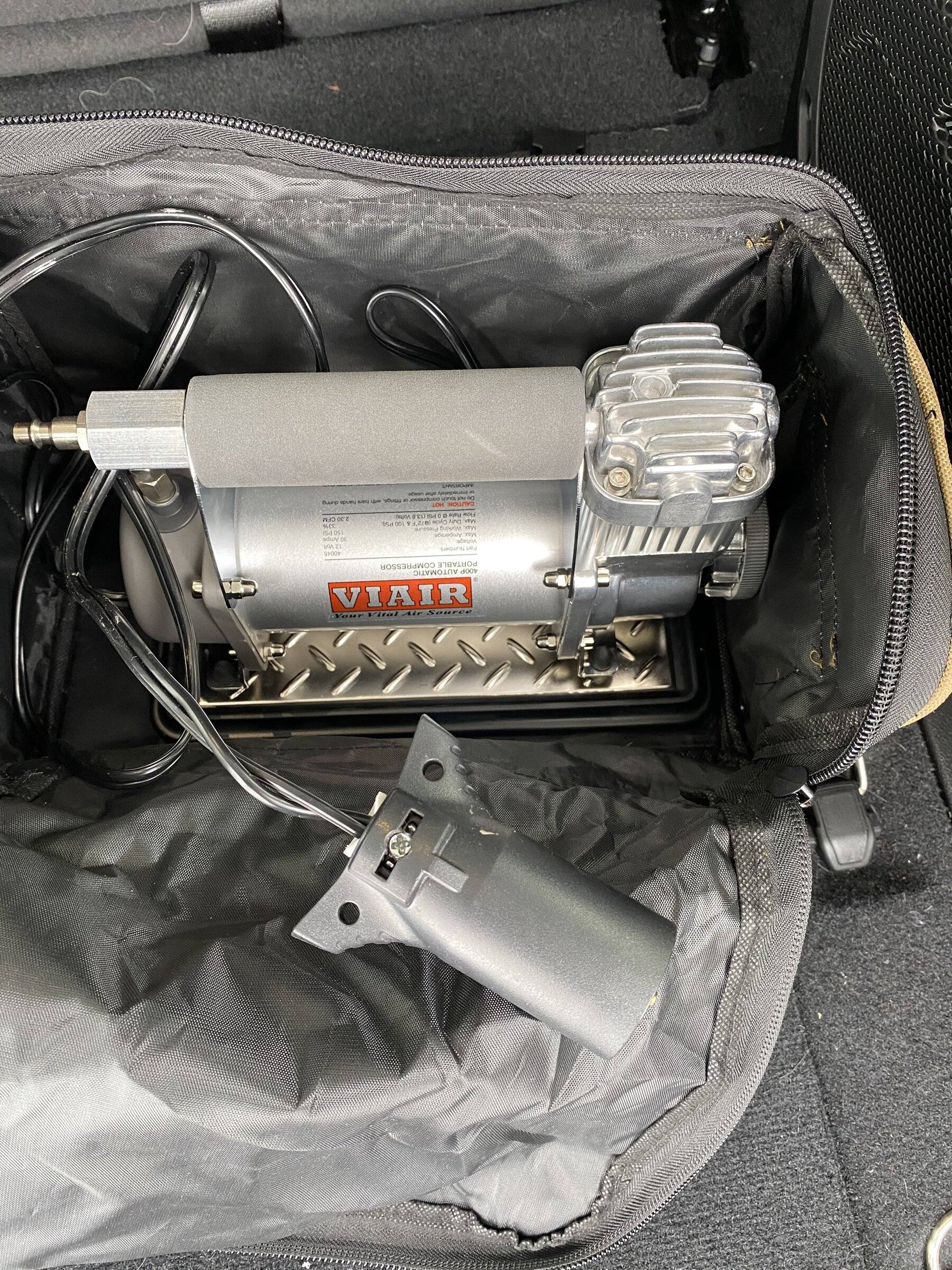

What are you trying to do? Just inflate tires, or run power tools? Do you want to DIY? If so, how comfortable are you with wiring and running air lines?
This all might help. If you just need to inflate tires, I’d listen to @AcesandEights to go with a portable. 30A and below can be wired to a rear 7-pin trailer plug if you have the HD package.
Running air tools will benefit from a tank in the mix. Air lockers need a manifold. If you want fast air up times, an onboard dual will be best. I mount mine inside the cab to cut down on maintenance, but you have to run power through the tub or firewall for that.

This is terrific. How did you wire it to the plug? I am a novice with electrical. Thank you.
