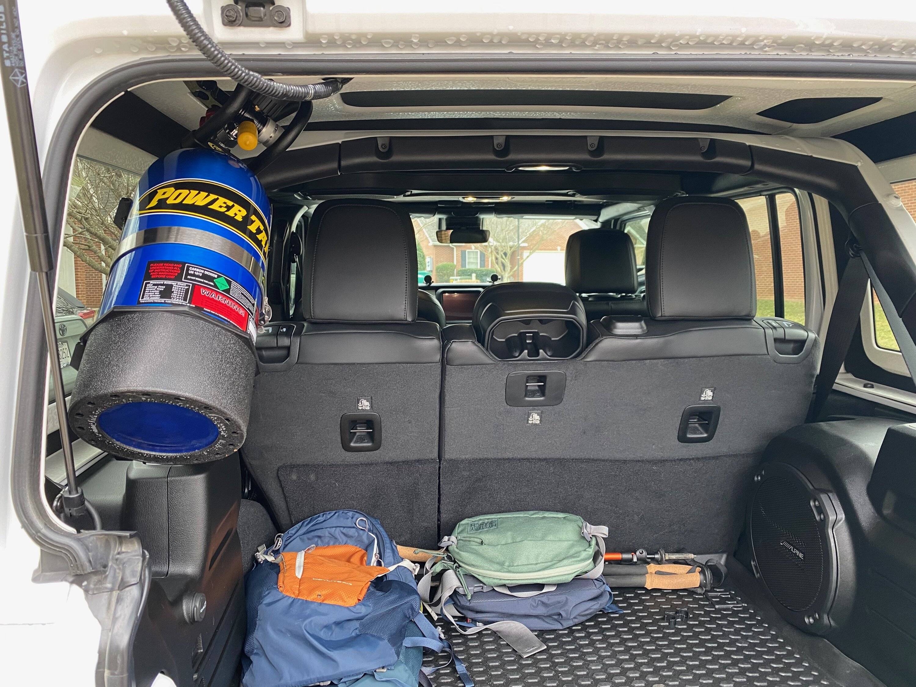

I used to go the ARB compressor route, but I have recently switched over to a PowerTank. I think Im going to enjoy it.

To be honest I am very new to the PowerTank option, but through all of my research it appears that filling times are faster than the ARB compressor and a lot of other options. There are several videos out there of people timing these various options.
When I started looking for solutions I was going to opt for ARB since that is what I was used to but mounting and installing for the diesel has some challenges. Reliability can be hit or miss as well with the ARB from what I have seen.
The Power Tank is a really slick solution, easy to install, inflates super fast, and is pretty fail-safe. The only Con is that you have to occasionally get the Tank Refilled and you may need to plan your outings a little more based on your inflating needs. I opted for the 10lb tank but almost went with the 15lb. In the end the 10lb will suit my needs just fine.

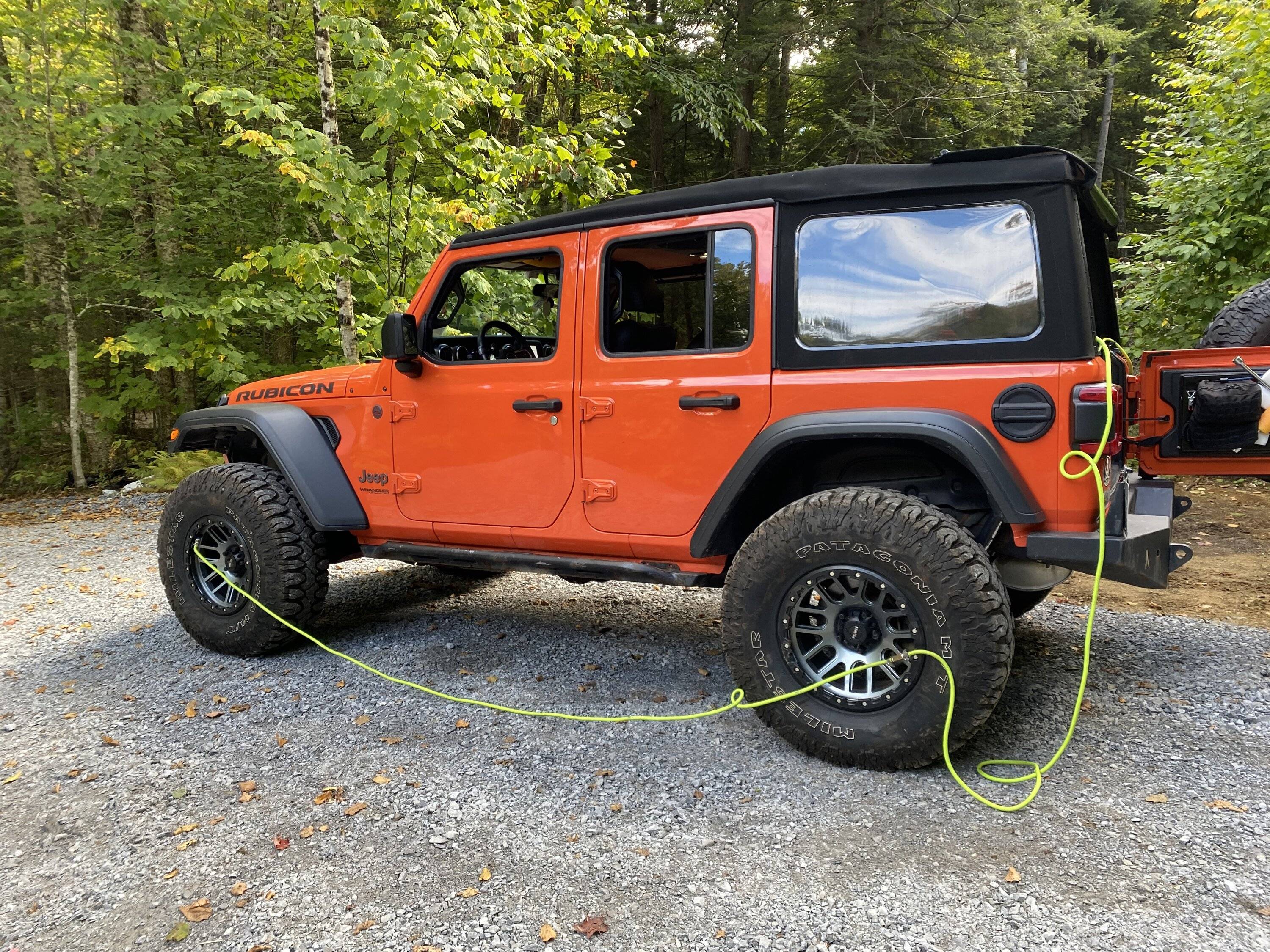

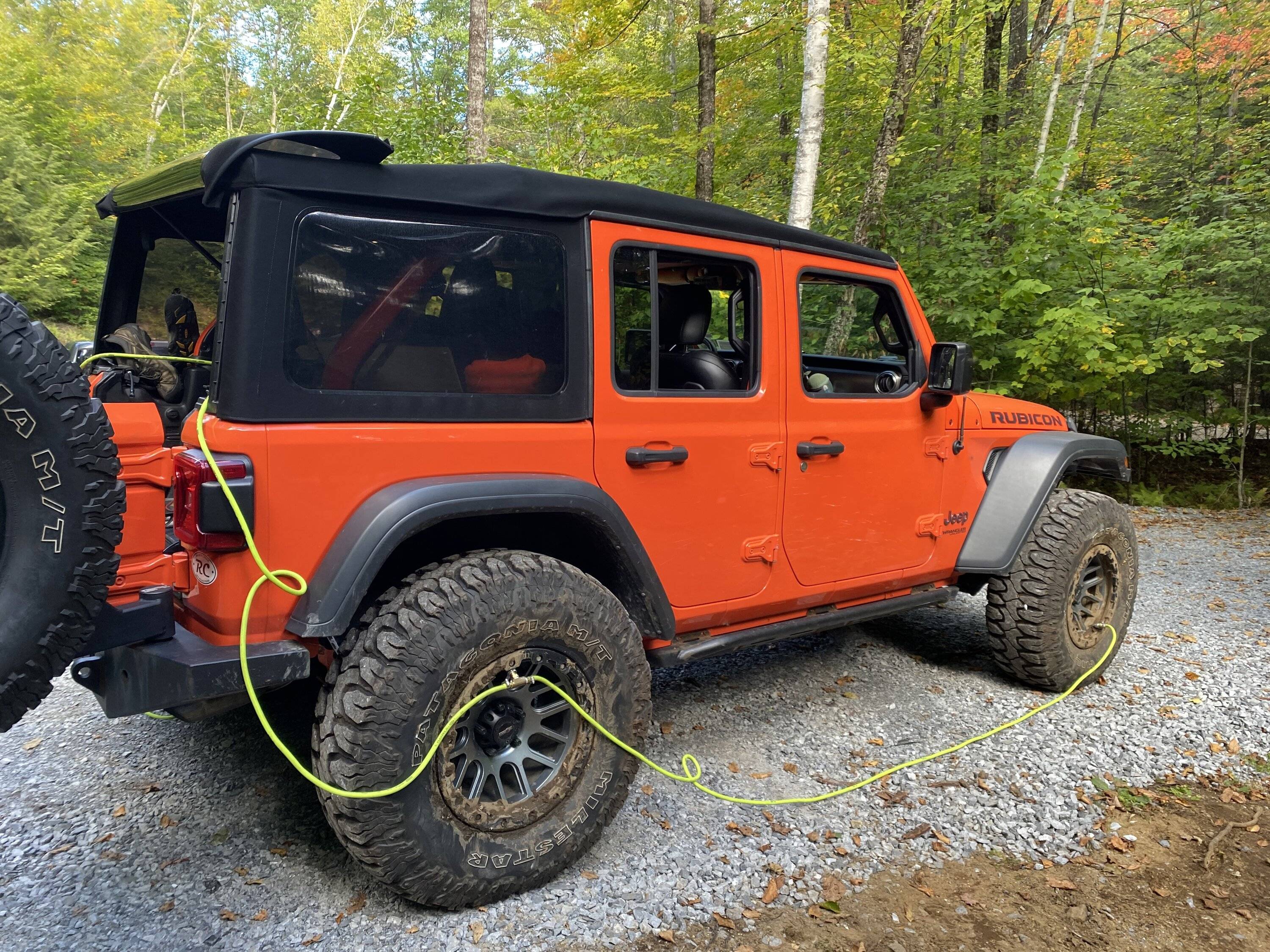

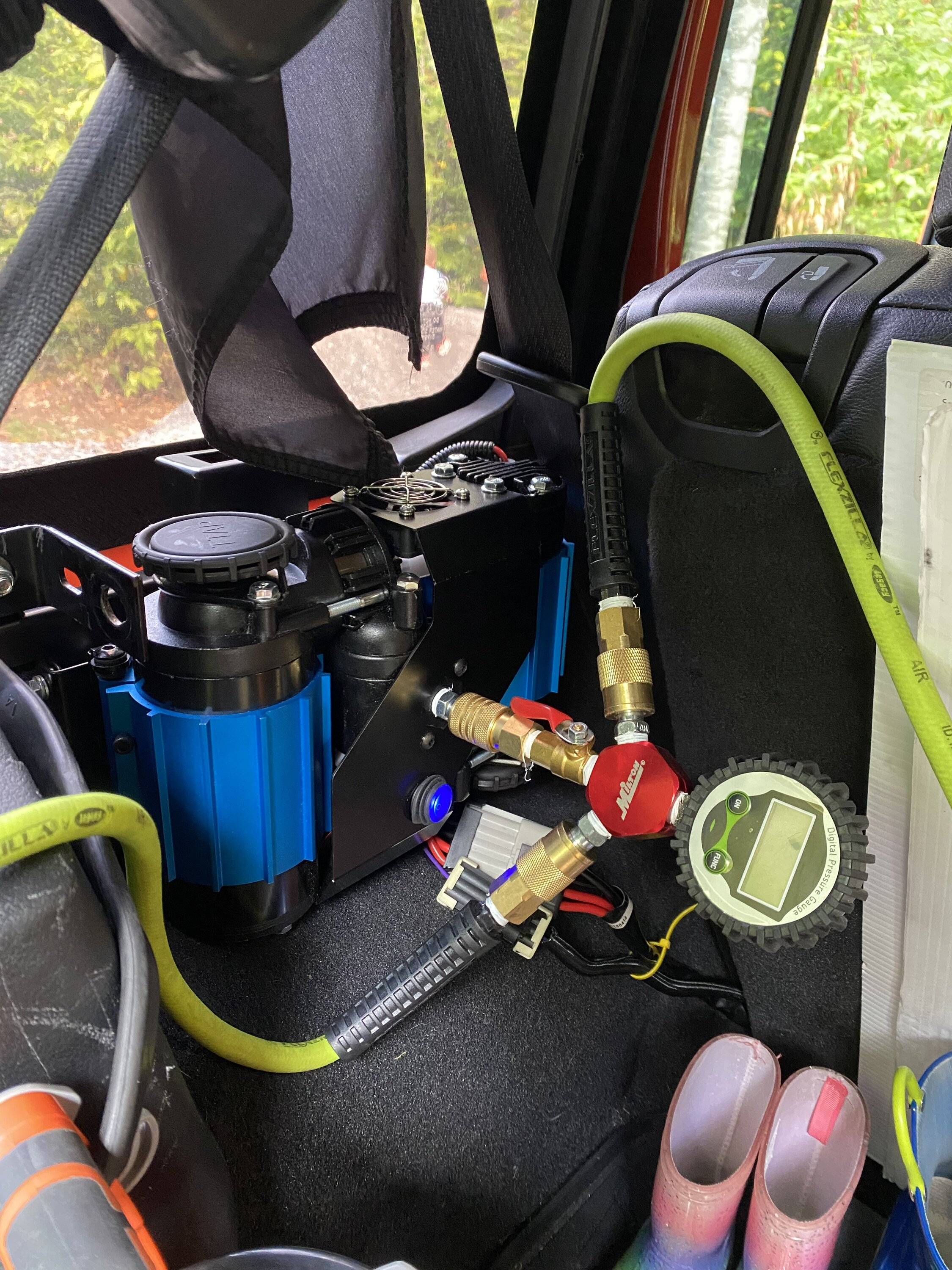

From my build thread. ARB Twin knock off, on the M.O.R.E. mount in the rear cargo area, w/ my DIY 4 tire inflation system. Worth every penny.
FINALLY got to use my DIY 4 tire air up system, and it worked great. 37’s went from 12psi to 37psi in 10-15 minutes, and cut my post trail load up time in half. By the time I got our gear repacked and the kids ready for the road, they were done! Wrapped the hoses and we were on our way home.
