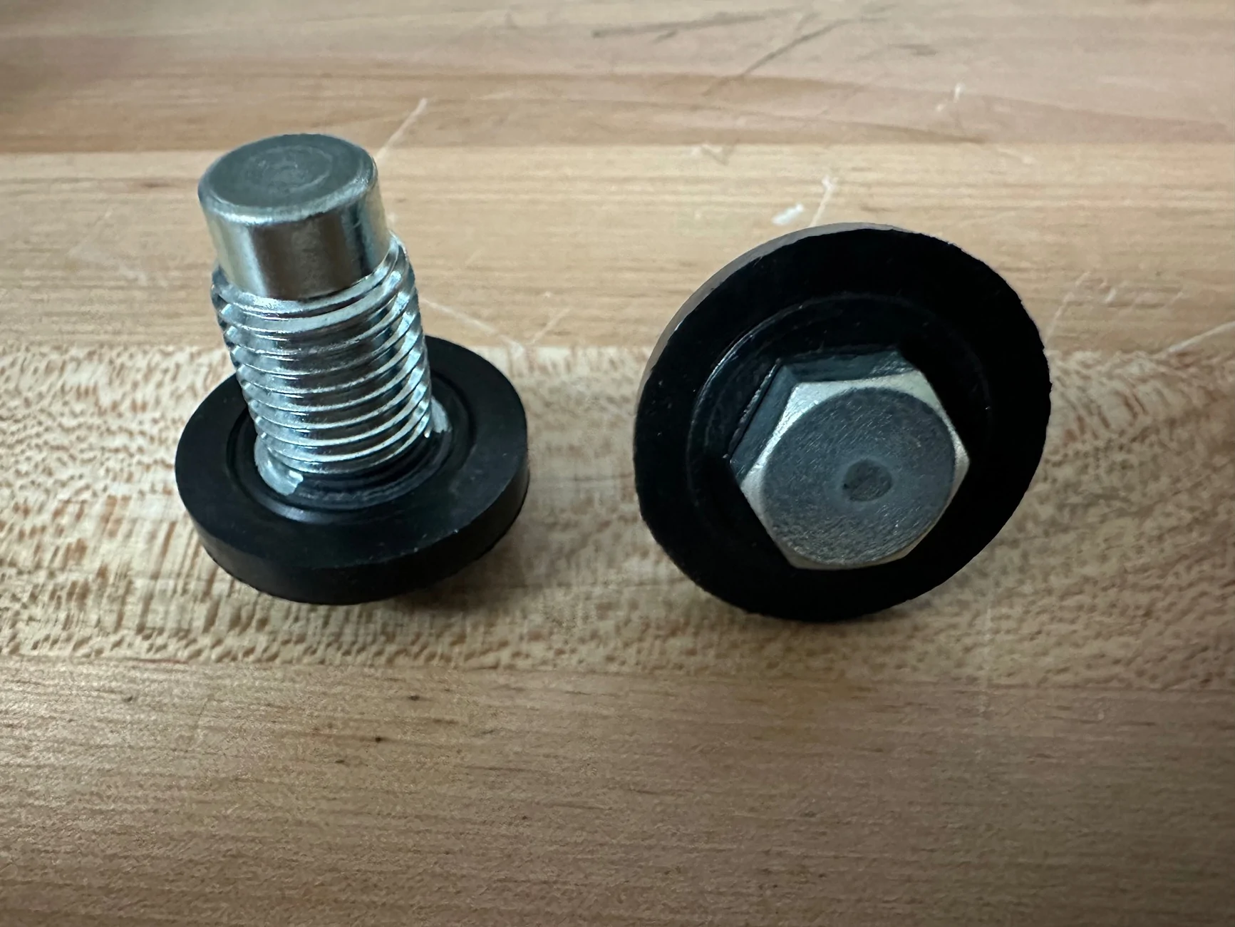

What is this rubber gasket on the drain plug? My '21 never had that, and I haven't seen it on any '18 thru '22. Was this added in later models perhaps?
Dunno, it was first oil change and it almost looked co-moulded onto the drain plug which is a steel bolt with flange around the head...never seen one with gasket looking dealio like that...wiped clean and re-used, knock on wood no drips lol.

My 23 3.6 OEM drain plug bolt has the rubber overmolded flange. This is a pic of some Crown Automotive spares ( I’m a hardware hoarder) but my OEM looks the same, just a lot dirtier.
Interesting, similar but different, thanks for the picture.
