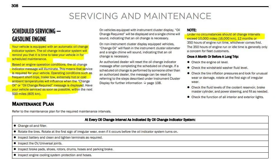

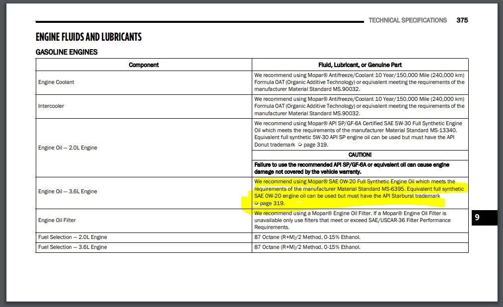

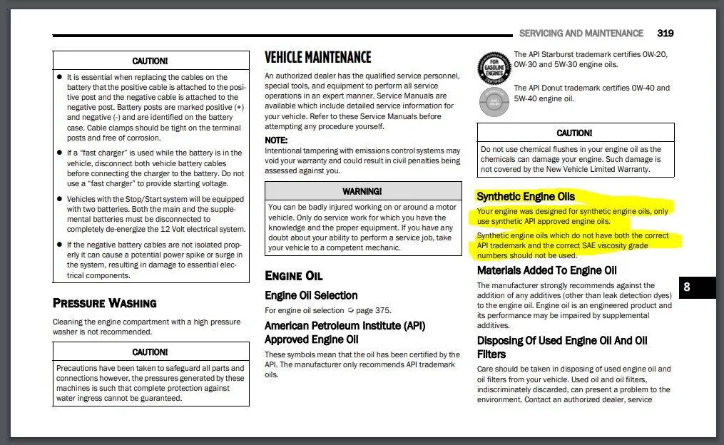

3.6 Gasoline, Jeep manual says do it when the Jeep tells you to and use Synthetic. Been doing it like that on a number of Jeeps for many years. No issues. But sure, I know some people like to use arbitrary numbers and be a on tight schedule. Each their own and some places of business like to take advantage of goobers.
RTFM attached
