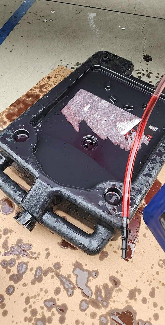

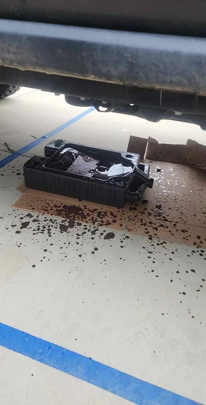

I did a transfercase oil change today, and found out the Tcase skid is a HUGE pain to remove. Have to remove the fuel tank skid, fuel filter skid among other parts. I looked at all of it and said nope. Changed the oil anyways, but just much more messy.
Anyways, I bought my ecodiesel at about 45k, and looks to have never had the Tcase oil changed, judging by the paint marks on the 2 bolts (fill/drain). The oil was still reddish, and nearly no metal shavings on the 2 bolts. I'm at 91k now.

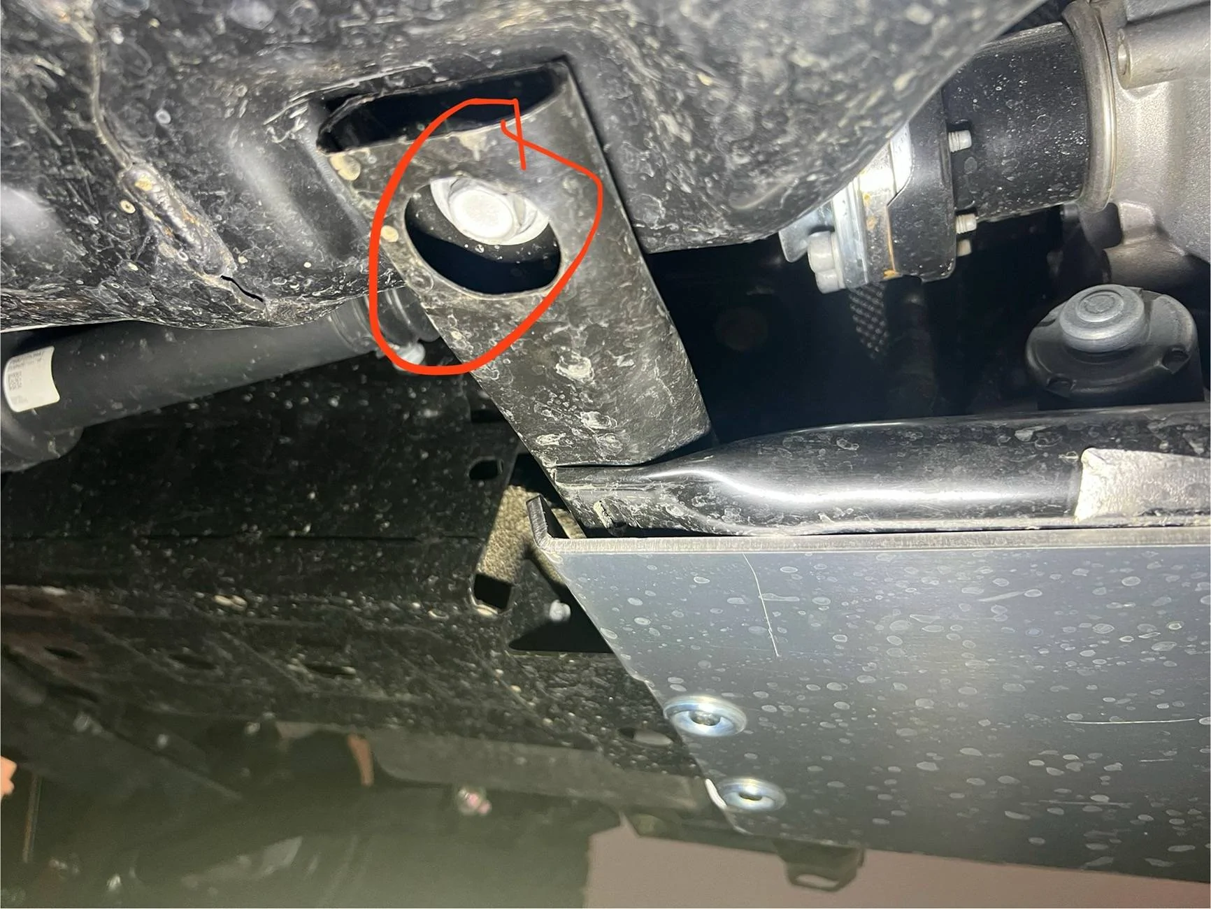

my 2.0T was super easy to remove the T-case skid. Probably 4 bolts. The drain was pretty clean, no splash, definitely no mess like your photo.
Took a closer look of your last photo. The skid plate of the transfer case seems weird. Bolt holes don't have bolt. Did previous owner welded the skid plate bars to the cross member?

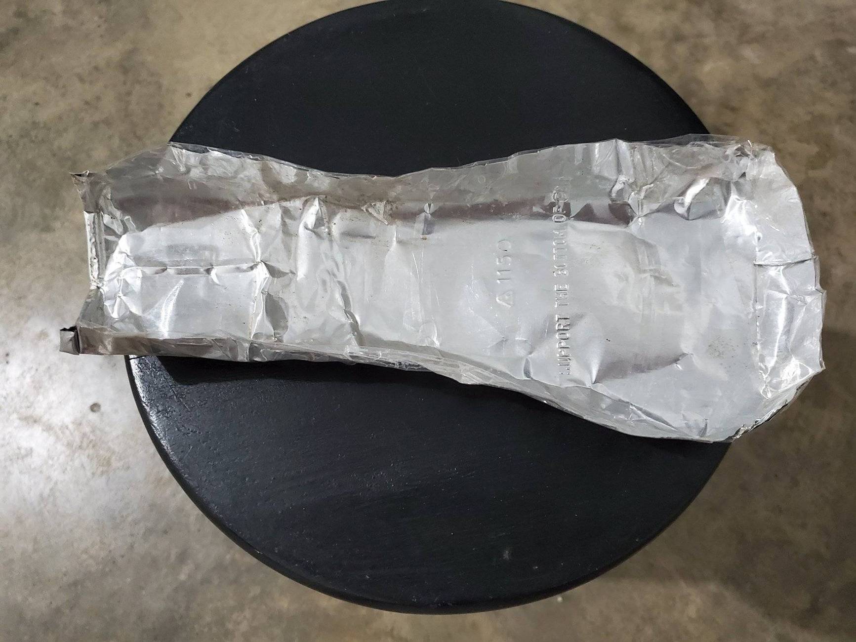

Actually, it is not at all mandatory to remove the skid plate..
Guys/gals do remove the skid plate, but it is far easier and also there is no chance of breaking off bolts, etc., to just fashion something like this to facilitate draining.. Service time is less also, if you do not remove the skid. No mess also..
You place this between the drain hole and the skid plate.... you pull the plug and the fluid runs along it, and then into the drain pan. No big mess on the skid plate and no pulling the skid plate.
Yes, you can still easily access and deal with both the drain and fill plugs.
This is an aluminum foil pan you get at the dollar store, etc.. You just cut the shape and fold up the edges. It's about say 16" long and about 4-5 inches wide. Easily cleaned when you get done so you have for next time...
No it all was factory.
For sure the fuel filter skid was bolted on to it as well.

Not sure if changed on later model. My 2021 t-case skid bar has bolt on to cross member.
Yes, but there are so many other things bolted to it. Fuel tank skid, fuel filter skid, i believe muffler skid as well.
You’re correct Jino. The ecodiesel’s are different and significantly more involved. That said, I did mine last weekend and it took an extra 10 minutes to remove it, so 15 minutes total. The fuel skid doesn’t need to be removed, just loosen the front bolts and it’ll slide out in the passenger direction once the fuel filter covers are removed. My fluid looked great coming out. I’m at 65k miles on a 2020. Also, I live in Colorado, so little/no corrosion to deal with.
