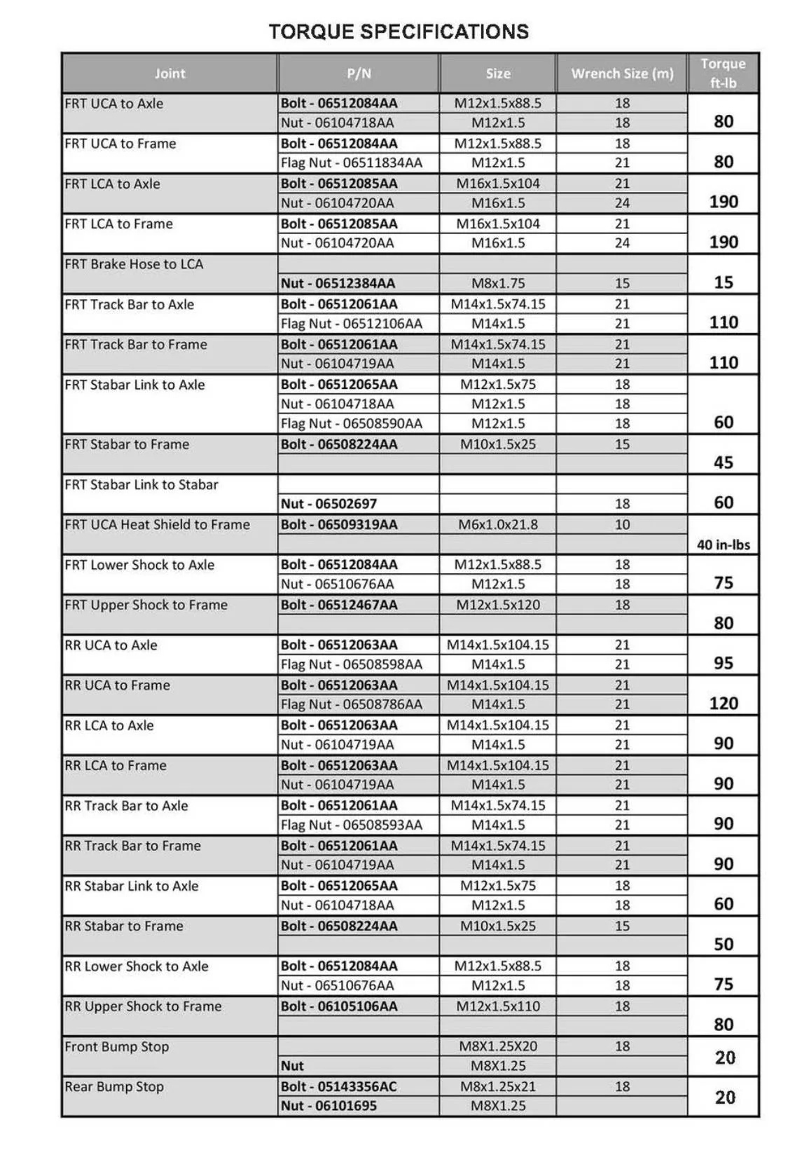

I don't think it is all gone, Iam seeing both links provided, one of them has a spreadsheet, although a lot of the specs are ft/lbs plus degrees. I know LCAs are 190 ft/lb and mopar track bar is 110 ft/lb.
JL Lift Kit MASTER FEB 2018.FH11 (quadratec.com)
dapipp
David
Nov 6, 2018
226
313
NW Idaho
2006 TJ, 2006 LJ, 2019 JLR, 2024 JLUR
I am seeing both links provided, one of them has a spreadsheet, although a lot of the specs are ft/lbs plus degrees. I know LCAs are 190 ft/lb and mopar track bar is 110 ft/lb.
The 190 and 110 are what most third party vendors are calling out, the actual specs from TechAuthority are in ft/lbs plus degrees.
Interesting that the Mopar spec differs from the FSM. Probably pretty close, regardless.
DESCRIPTIONN·mFt. Lbs.In. Lbs.Comments
Hub And Bearing Bolts10275
Hub And Bearing Nut136100
Lower Control Arm Rear Nut140 Plus 145°103 Plus 145°
Lower Control Arm Front Nut140 Plus 145°103 Plus 145°

New here and scouring the forum for knowledge earlier today -- I bookmarked this page.
BOLT SIZES & TORQUE SETTING
Seems reasonable when I briefly looked it over.
