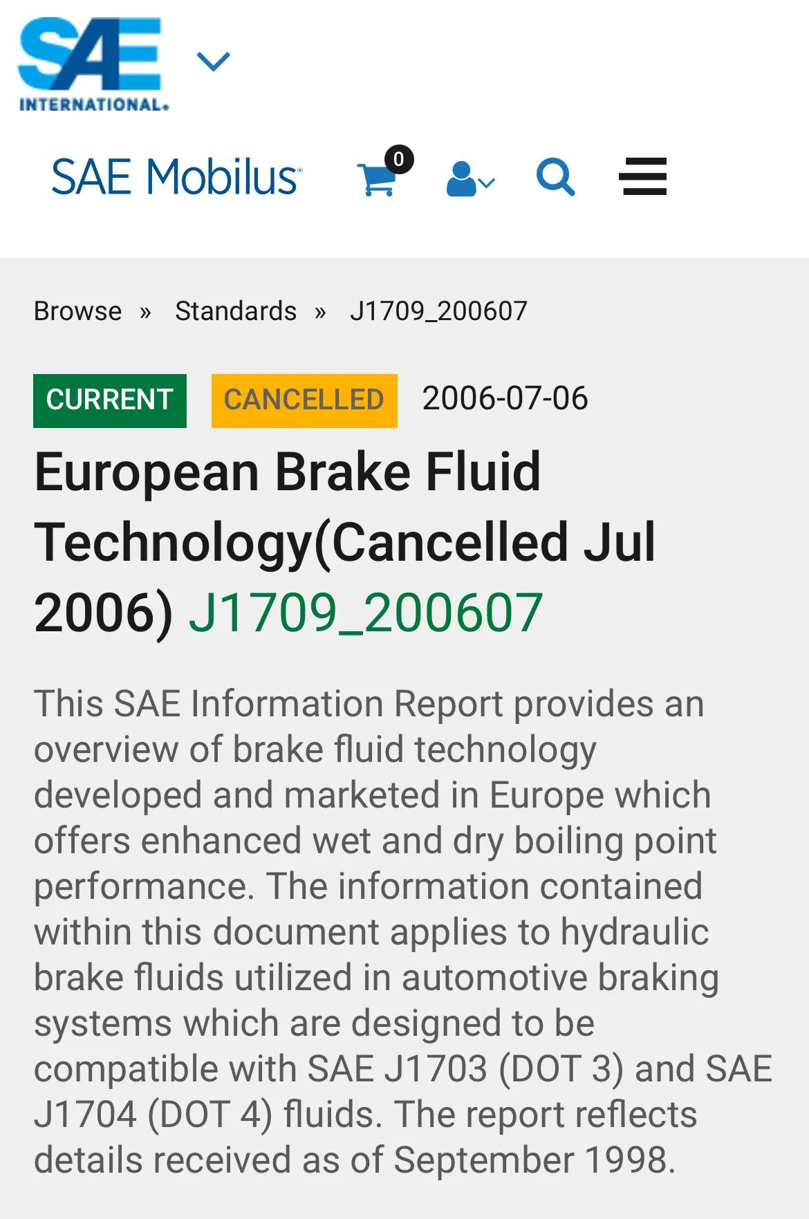

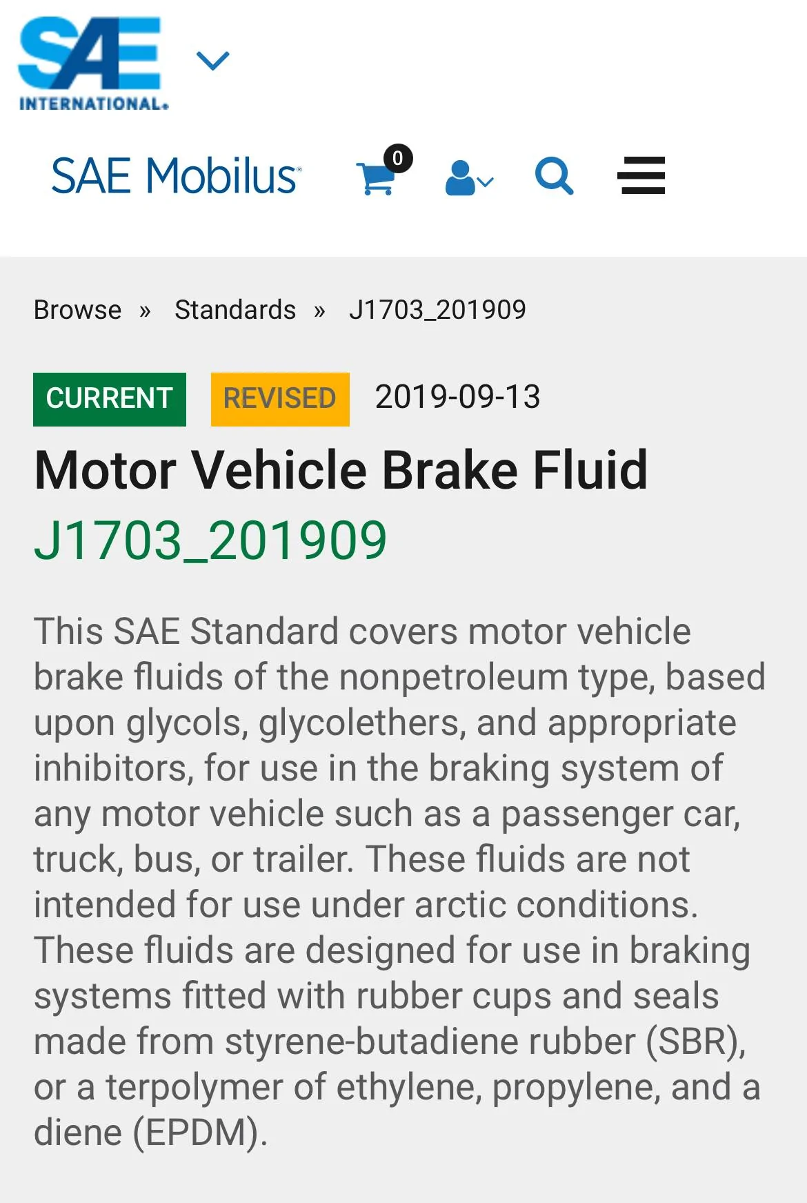

Found this on the SAE website:
Jeep Wrangler JL Brake Fluid Boiling Points Table 1703766489012
https://www.sae.org/standards/content/j1703_201909/
And for J1709:
Jeep Wrangler JL Brake Fluid Boiling Points Table 1703766753135
https://www.sae.org/standards/content/j1709_200607/
I don’t understand most of this:
https://img.antpedia.com/standard/files/pdfs_ora/20221211/sae/SAE J1709-2006.pdf
Out of curiosity, does anyone have a newer manual to see if it says something different?
